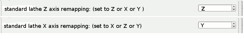

  3. Defailt X and Z axis remap

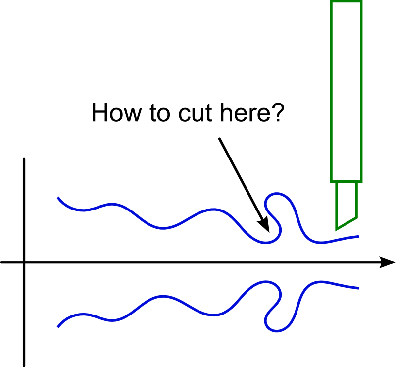

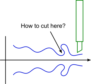

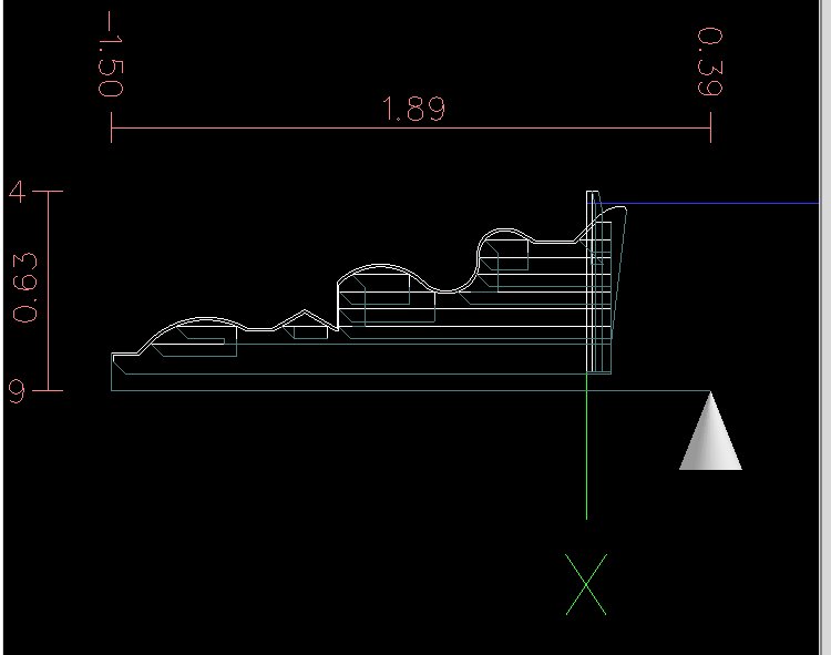

Another question:
How to cut this place? How to determine such special places?
gcode lathe 0036.png (27468 просмотров) <a class='original' href='./download/file.php?id=486&mode=view' target=_blank>Загрузить оригинал (31.9 КБ)</a>
By the way, clones can be used to draw bottom part of the path. If you change original's geometry clone will be also changed.

Hi !
I think that turning path with angle zone so sophisticated require a four axis turning system.
Whit simple turning machine it's possible to do some case but it's more harder ! That require special tools ! And special nc code.
And we must take care of the geometry of the turning tool ... it's ever more sophisticated.
Can we just in the first state of feature ! Have generation for simple path ! just with no dead angle.
In the first time that's be the user that must becarufull of the angle of his path to don't have problem in cuting his path.
In second evolution we can improve to have tool consideration and special shape generation...

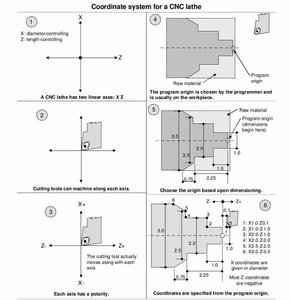

Hi ! after some search I found this doc.
Resume some parameters of coordinate system and the tool working face of cnc lathe.
coordinate_system_of_lathe.jpg (27426 просмотров) <a class='original' href='./download/file.php?id=488&mode=view' target=_blank>Загрузить оригинал (36.16 КБ)</a>
Re: Gcode tools - lathe extension develop
alfcnc писал(а):Hi ! after some search I found this doc.
We'll have to use G18 code to be able to use G02 and G03 codes.

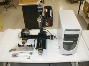

I think that's be nice to have the choice off two major mode.
One mode for native lathe turning ! Classical setting XZ axis and spindle.
And one mode for turning on 4 axis center of type 3 axis milling with a rotational servo axis or a spindle for rotary axis that's is often along X axis.
And perhaps be able to select were the X and y axis and z axis are setting. And then set/unset A axis for adjust to the different case if it's a servo or just a spindle.
I speak off this type of center:
Or with servo/stepper type config... the A axis done the job of spindle on lathe.
But the tool is different because using the milling tool on the z spindle...
sherline.jpg (27409 просмотров) <a class='original' href='./download/file.php?id=490&mode=view' target=_blank>Загрузить оригинал (44.34 КБ)</a>

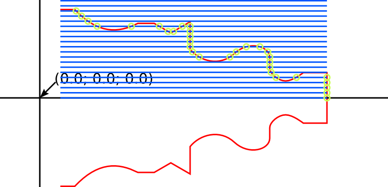

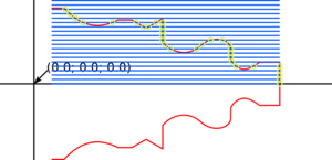

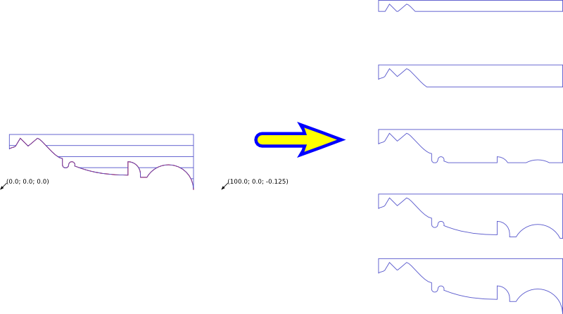

So as we've made a release. I'm coming back to lathe development :).
First step is ready: Generate parallel lines and calculate their intersection with the path.
0041 gcodetools lathe.png (27311 просмотров) <a class='original' href='./download/file.php?id=519&mode=view' target=_blank>Загрузить оригинал (29.63 КБ)</a>

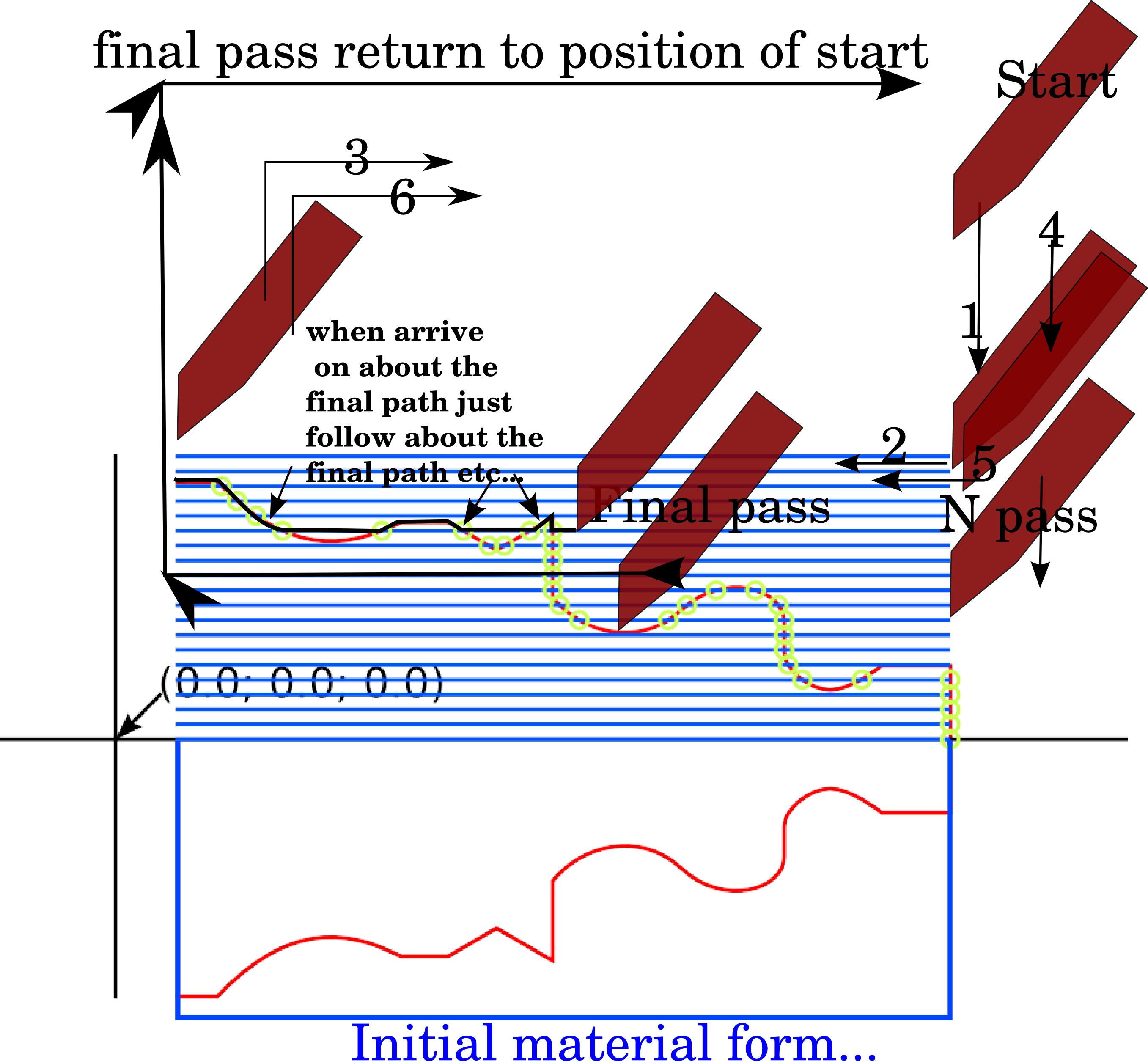

I think the cutting path would be like this for axial cutting...
lathe_path.png (27237 просмотров) <a class='original' href='./download/file.php?id=521&mode=view' target=_blank>Загрузить оригинал (398.29 КБ)</a>
I think for good finishing surface that's be nice to have abilities to define 2 , 3 , or more final path with a different depht
cutting layer to have very thin pass cutting at the near end of the cutting process... this allow the real final path to be a very very thin cutting and this done good accuracy of cutting and better surface looking... (but this depend of the material to cut, wood , metal , plastic). If requires different final cutting parameters and if wanting very high surface finishing quality you must put another tool... But with ceramic carbids tool and some thin pass to the end of cuting the result are often very good for metal cutting. :idea:

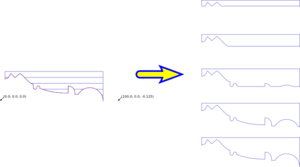

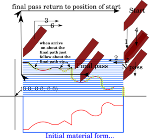

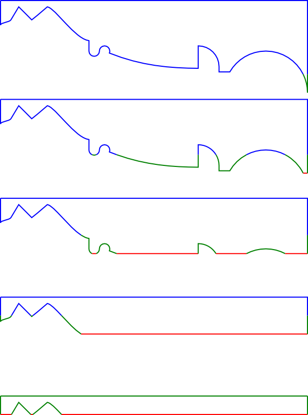

I'm sorry for the delay with lathe... I was really busy this time and spent all my free time to write offset function, which will be also needed in lathe to make final fine cut.
But here's some new results! :)
I've made a function which generates paths that could be exported to gcode later. Now I've stopped at gcode exporting. Here some problems:
1. We already have generate_gcode function, but it is focused on generate gcode for mills, not lathes. So I think we will need a new function to generate lathe gcode.
2. What parameters should we add?
3. What axes should we use?
Here are an illustration for the function I've made. How do you think, what must be improved in this function?
0045 gcode tools lathe.png (27157 просмотров) <a class='original' href='./download/file.php?id=543&mode=view' target=_blank>Загрузить оригинал (20.28 КБ)</a>

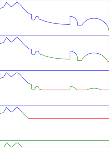

Also there's some different types of subpath:
blue - the subpath have been already cut, go through it at maximum speed
red - cut at depth step (the final path will be cut next steps)
green - cut the path
0046 gcode tools lathe.png (27155 просмотров) <a class='original' href='./download/file.php?id=545&mode=view' target=_blank>Загрузить оригинал (25.99 КБ)</a>
alfcnc
Сообщения: 98
Зарегистрирован: 02 апр 2010, 19:10
Заслуга: Tester
Сообщение alfcnc »
Hi ! root !
Very nice !
I think to others improvement just for final tool path !
But all it is very good for me.
For final path just be able to set the speed of it and the number
of fine final cutting path...
so I see parameters...
Feed of roughing cut or speed cut...
Depth pass of roughing cut.
Feed of end cut.
Depth pass of ending cut.
I want say that's very nice to be able to have a parameters for reapeat n times
the end cut.. often I do 2 too 3 time the end cut to have a very good surface finishing...
and a paramater to subdivide the end depth cutting path.

For the Axes setting that's be nice to be able to name the axes same as wanted...
So if i want Z to be done by my X axis... be able to set X ... and if i want
to set Y for X be able to and so on... that's permit to be able to use a mill for
doing vertical milling or others...
I see some choose box like this... default to Z and X but be able to change it...
