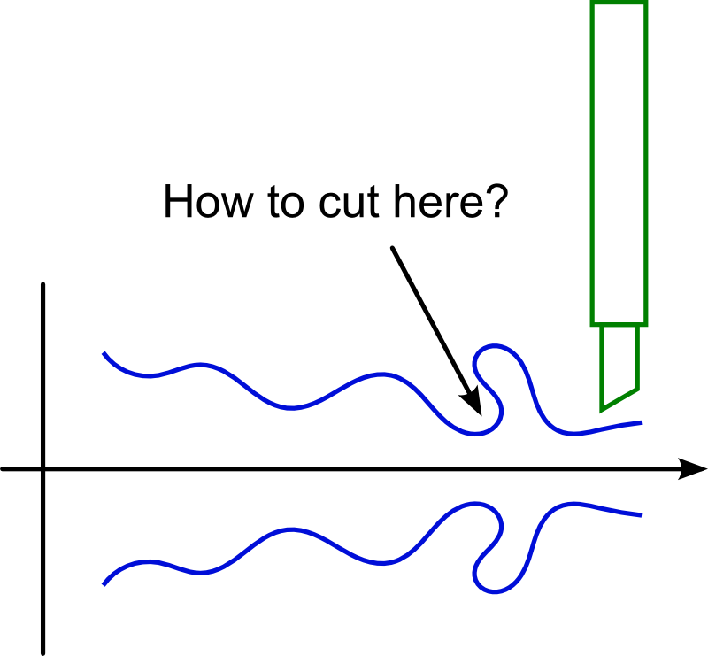

Another question:
How to cut this place? How to determine such special places?

Hi !
I think that turning path with angle zone so sophisticated require a four axis turning system.
Whit simple turning machine it's possible to do some case but it's more harder ! That require special tools ! And special nc code.
And we must take care of the geometry of the turning tool ... it's ever more sophisticated.
Can we just in the first state of feature ! Have generation for simple path ! just with no dead angle.
In the first time that's be the user that must becarufull of the angle of his path to don't have problem in cuting his path.
In second evolution we can improve to have tool consideration and special shape generation...

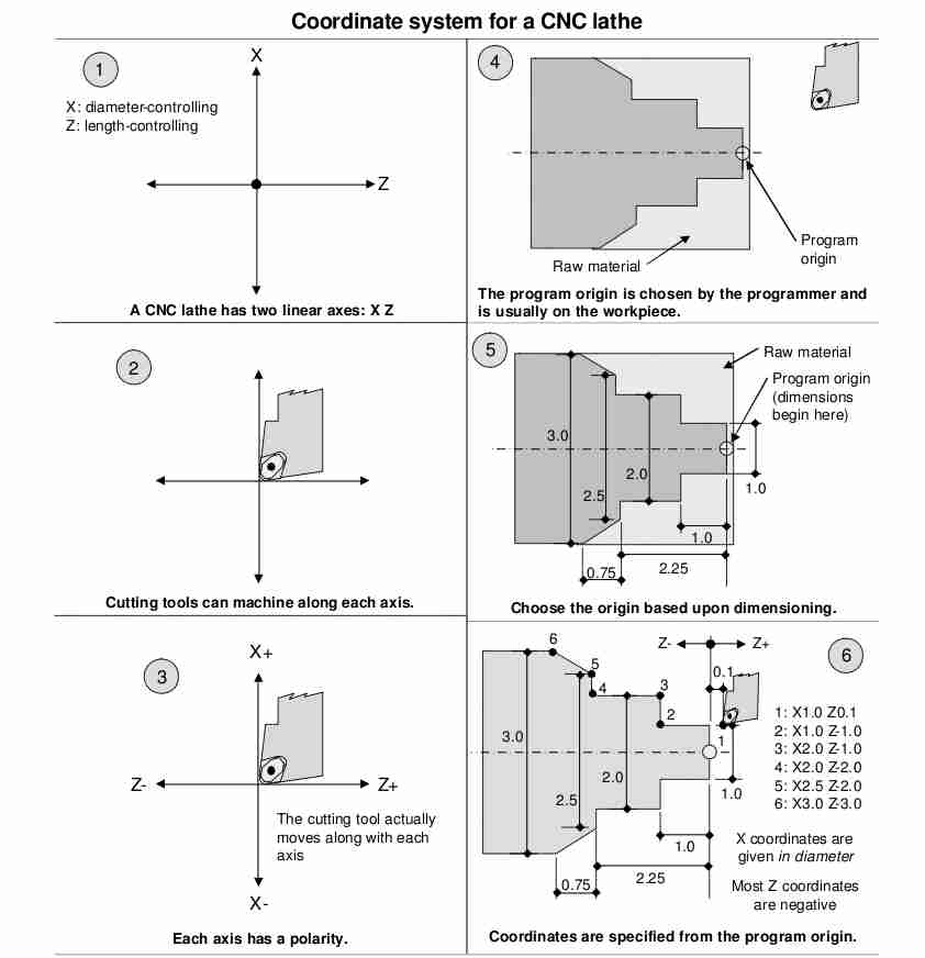

Hi ! after some search I found this doc.
Resume some parameters of coordinate system and the tool working face of cnc lathe.
coordinate_system_of_lathe.jpg (29484 просмотра) <a class='original' href='./download/file.php?id=488&sid=ddbebff07ff5de6e5703593bb723bedc&mode=view' target=_blank>Загрузить оригинал (36.16 КБ)</a>
Re: Gcode tools - lathe extension develop
alfcnc писал(а):Hi ! after some search I found this doc.
We'll have to use G18 code to be able to use G02 and G03 codes.

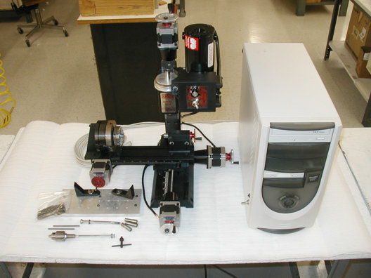

I think that's be nice to have the choice off two major mode.
One mode for native lathe turning ! Classical setting XZ axis and spindle.
And one mode for turning on 4 axis center of type 3 axis milling with a rotational servo axis or a spindle for rotary axis that's is often along X axis.
And perhaps be able to select were the X and y axis and z axis are setting. And then set/unset A axis for adjust to the different case if it's a servo or just a spindle.
I speak off this type of center:
Or with servo/stepper type config... the A axis done the job of spindle on lathe.
But the tool is different because using the milling tool on the z spindle...
sherline.jpg (29467 просмотров) <a class='original' href='./download/file.php?id=490&sid=ddbebff07ff5de6e5703593bb723bedc&mode=view' target=_blank>Загрузить оригинал (44.34 КБ)</a>

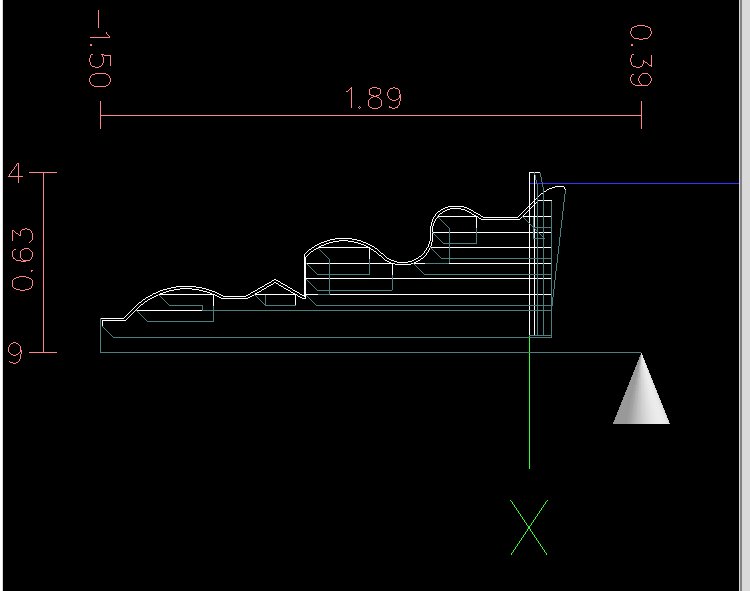

a simple exemple for lathe mode is the one give with emc:
emc_exemple.jpg (29464 просмотра) <a class='original' href='./download/file.php?id=491&sid=ddbebff07ff5de6e5703593bb723bedc&mode=view' target=_blank>Загрузить оригинал (26 КБ)</a>
Let's take a closer look...
If I wrong with something please correct me.
Horizontal lines are major cutting trajectory which cut most of material.
What do diagonals from bottom right to top left do? Is it a penetration trajectory?
And two curvy paths are the finishing trajectory.
What cutter is used to cut this thing?
