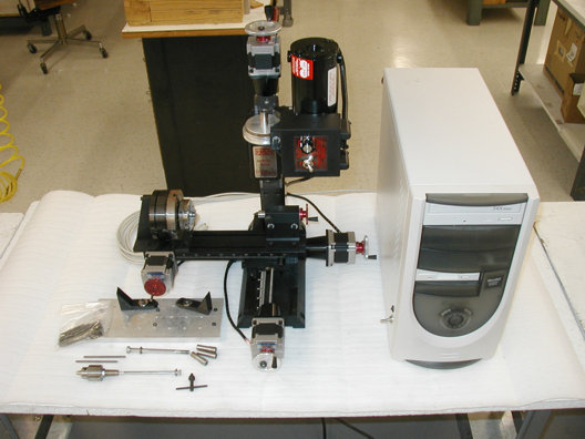

I think that's be nice to have the choice off two major mode.
One mode for native lathe turning ! Classical setting XZ axis and spindle.
And one mode for turning on 4 axis center of type 3 axis milling with a rotational servo axis or a spindle for rotary axis that's is often along X axis.
And perhaps be able to select were the X and y axis and z axis are setting. And then set/unset A axis for adjust to the different case if it's a servo or just a spindle.
I speak off this type of center:
Or with servo/stepper type config... the A axis done the job of spindle on lathe.
But the tool is different because using the milling tool on the z spindle...
sherline.jpg (29547 просмотров) <a class='original' href='./download/file.php?id=490&mode=view' target=_blank>Загрузить оригинал (44.34 КБ)</a>
Re: Gcode tools - lathe extension develop
alfcnc писал(а):I think that's be nice to have the choice off two major mode.
Ok, I'll put in the header in the desired list.
About the trajectory of cutting tool is there any special things?
Can you write a simple algorithm on which cutting is usually made?
Is there any common thing that you cut with cnc lathe?

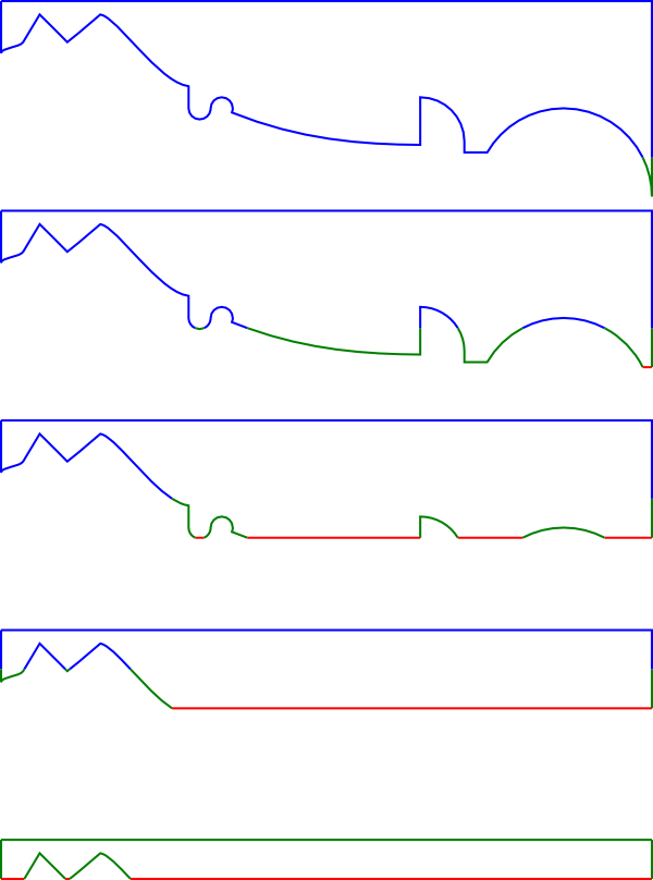

So as we've made a release. I'm coming back to lathe development :).
First step is ready: Generate parallel lines and calculate their intersection with the path.
0041 gcodetools lathe.png (29449 просмотров) <a class='original' href='./download/file.php?id=519&mode=view' target=_blank>Загрузить оригинал (29.63 КБ)</a>
Now I'm thinking adding penetration trajectory.
As I know penetration is not always done with the right (90 deg) angle.
I'm sorry for the delay with lathe... I was really busy this time and spent all my free time to write offset function, which will be also needed in lathe to make final fine cut.
But here's some new results! :)
I've made a function which generates paths that could be exported to gcode later. Now I've stopped at gcode exporting. Here some problems:
1. We already have generate_gcode function, but it is focused on generate gcode for mills, not lathes. So I think we will need a new function to generate lathe gcode.
2. What parameters should we add?
3. What axes should we use?
Here are an illustration for the function I've made. How do you think, what must be improved in this function?
0045 gcode tools lathe.png (29295 просмотров) <a class='original' href='./download/file.php?id=543&mode=view' target=_blank>Загрузить оригинал (20.28 КБ)</a>
Also there's some different types of subpath:
blue - the subpath have been already cut, go through it at maximum speed
red - cut at depth step (the final path will be cut next steps)
green - cut the path
0046 gcode tools lathe.png (29293 просмотра) <a class='original' href='./download/file.php?id=545&mode=view' target=_blank>Загрузить оригинал (25.99 КБ)</a>
alfcnc
Сообщения: 98
Зарегистрирован: 02 апр 2010, 19:10
Заслуга: Tester
Сообщение alfcnc »
Hi ! root !
Very nice !
I think to others improvement just for final tool path !
But all it is very good for me.
For final path just be able to set the speed of it and the number
of fine final cutting path...
so I see parameters...
Feed of roughing cut or speed cut...
Depth pass of roughing cut.
Feed of end cut.
Depth pass of ending cut.
I want say that's very nice to be able to have a parameters for reapeat n times
the end cut.. often I do 2 too 3 time the end cut to have a very good surface finishing...
and a paramater to subdivide the end depth cutting path.
alfcnc
