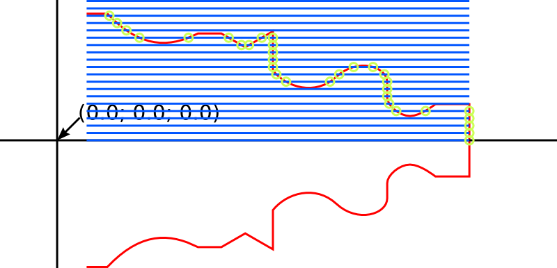

Re: Gcode tools - lathe extension develop
So as we've made a release. I'm coming back to lathe development :).
First step is ready: Generate parallel lines and calculate their intersection with the path.
0041 gcodetools lathe.png (29384 просмотра) <a class='original' href='./download/file.php?id=519&mode=view' target=_blank>Загрузить оригинал (29.63 КБ)</a>
Now I'm thinking adding penetration trajectory.
As I know penetration is not always done with the right (90 deg) angle.
alfcnc писал(а):I have download ver 1.6 and try to run the lathe tab... but any result !is the parellel algorithme usable now ?
No :), it is in the development. I'm thinking about how to make cutting trajectory from this parallel lines and intersection dots?
How should penetration trajectory looks like?
