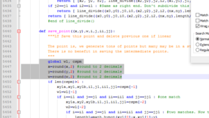

Michal_K писал(а):I'm trying to find an option to get max 3 decimal places instead of 6 - I'm working in wood with a CNC milling machine and I don't need such a accuracy, second thing: it's a good and simple way to reduce the end file size which can be critical if you have "limited" memory volume in your machine.
Can you please give me a tip..
Yes, use a text editor like notepad++ (Windows) to open (in administrator mode so you can later save changes) the [highlight=]gcodetools.py[/highlight] file in your Inkscape extensions folder (e.g. C:\Program Files\Inkscape\share\extensions) and look for this section of code (use a Ctrl+f in notepad++ to search down the list for instances of "round" and you'll find it):
Screenshot (74).png (28226 просмотров) <a class='original' href='./download/file.php?id=110755&mode=view' target=_blank>Загрузить оригинал (208.72 КБ)</a>
Now, change
x=round(x,4) #round to 4 decimals
to
x=round(x,3) #round to 3 decimals
I actually use 2 decimals here as I don't believe my machine has 0.01mm precision.
Repeat this for the following lines too:
y=round(y,4) #round to 4 decimals
w=round(w,4) #round to 4 decimals
Now save (this is why you needed to open the text editor in administrator mode).
If you want to edit the GUI pop-up, you can do this by changing "4" to "3" in the relevant parts of the file [highlight=]gcodetools_path_to_gcode.inx[/highlight] in the same Inkscape extension folder. Now, if Inkscape is already open, save your work and restart it. If not, just open your file in Inkscape.
