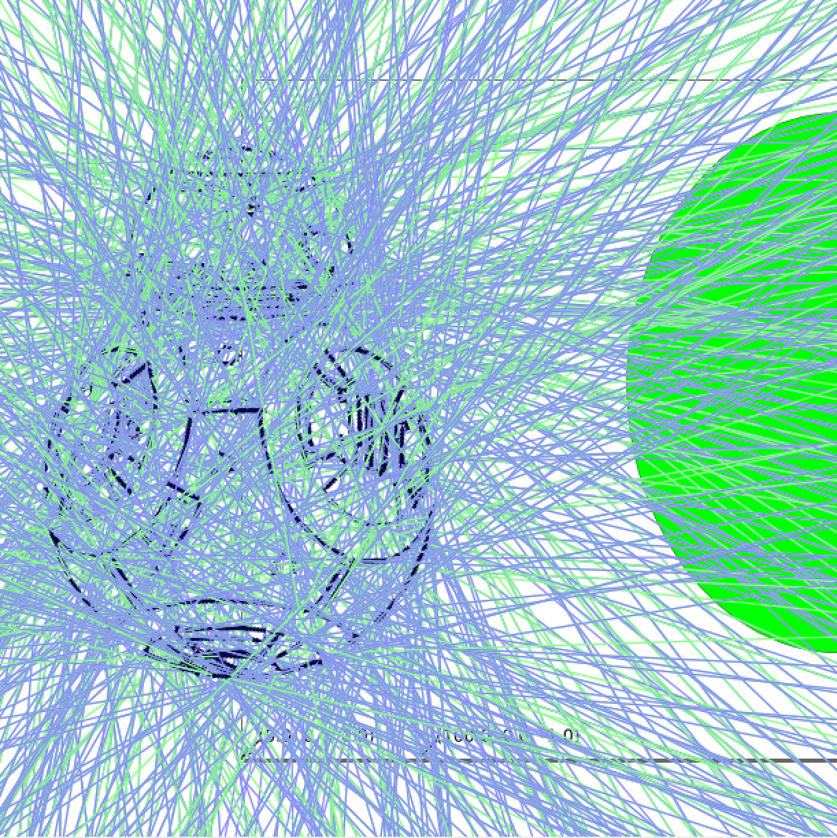

I am having a problem. Please see a screenshot. I am sure you will recognize a problem. Onfortunatly I don't know how to even query for this behaviour, so I couldn't search here. Sorry If this is reported not the first time.
This happens when I try to do path to gcode second time. I noticed that this happens after I modified initial design (and remove layer from previous gcode generation. Not sure if this is relevant, but I do some transformation to my design: I remove all the splines "Flatten Beziers" and then add more points to all those small lines.
