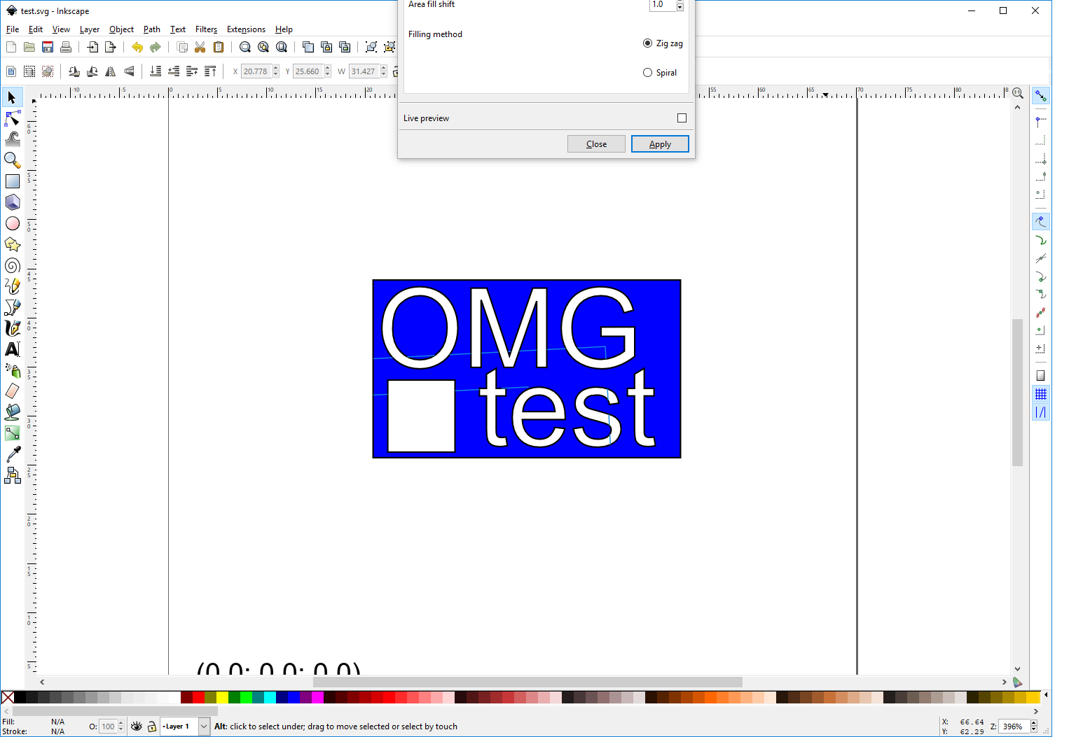

Hi All,
I'm trying to use the AREA FILL functionality of this plug-in to create G-Code.
However, when I go to use this, I don't get the back and fourth pattern like the images in the instructions have.... I don't believe it's working properly.
Is there any updated tutorial on how to do this using 1.7?
The process I used was I made a simple rectangle, added some text, did a difference. Made sure object was path -- Then I used "Fill Area" tab in GCode Extension... No matter what parameters I put in, nothing seems to happen when I click Apply.
I get the errors:
Orientation points have not been defined! A default set of orientation points has been automatically added.
Cutting tool has not been defined! A default tool has been automatically added.
Then, my image has some simple spiral or zig zag pattern that isn't one that goes back and fourth like I would need.
$100 via PayPal to anyone that can help me figure this out and get multiple layer CNC going.
please contact me at healeyv3 at gmail.com if you think you can TeamViewer in and help me get this going.
Thanks!
test.png (54242 просмотра) <a class='original' href='./download/file.php?id=138379&mode=view' target=_blank>Загрузить оригинал (113.43 КБ)</a>
test.svg
(9.34 КБ) 1396 скачиваний
