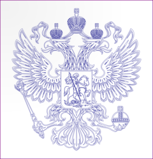

Gcodetools engraving by Rene (1443439 просмотров) <a class='original' href='./download/file.php?id=631&sid=7e7e0229114215b1f6ad22dc5a4616e4&mode=view' target=_blank>Загрузить оригинал (233.84 КБ)</a>

I have project drawed in CorelDraw saved in format *.CRD.
The path cutted with hot wire is continously, but the direction of cutting is important.
Cutting is must to go from top to bottom. But when i generate g code with gcodetool, i dont know how to change the direction of cutting. Because the
default direction is opposite. I try to change in corel the zero point of project, put orientation point, and in-out point in gcodetool, but without result.
Can someone help me how to change the direction of cutting please?
Thanks Attila.
gcodepath.png (20841 просмотр) <a class='original' href='./download/file.php?id=192717&sid=7e7e0229114215b1f6ad22dc5a4616e4&mode=view' target=_blank>Загрузить оригинал (34.74 КБ)</a>
