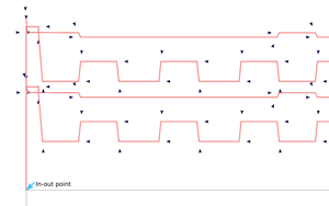

I'm trying to make a file for pen plotter using gcodetools.
Most of images are pretty complicated, so let's say it's just a simple shape with a wide contour and some small details inside.
Is there any way to draw it whole (ie. "what is black will be black on print")? Cutrently I'm getting only countours of the shapes, without infill.
I tried area, but 1. It takes lots of time to convert (for some reason Inkscape uses only 1 core) and 2. It breaks some inner details (expansion needed to completely fill bigget countour will turn small details into shapeless blobs).
What I'd like to achieve is 3D-printer-like style, ie. contours of filled contour drawn first, then: a) infill at constant angle or b) concentric infill (similar to area but only between previously drawn contours).
What I usually get vs what I want to achieve but more efficient and repeatable way. (55463 просмотра) <a class='original' href='./download/file.php?id=133236&mode=view' target=_blank>Загрузить оригинал (3.3 МБ)</a>

I have project drawed in CorelDraw saved in format *.CRD.
The path cutted with hot wire is continously, but the direction of cutting is important.
Cutting is must to go from top to bottom. But when i generate g code with gcodetool, i dont know how to change the direction of cutting. Because the
default direction is opposite. I try to change in corel the zero point of project, put orientation point, and in-out point in gcodetool, but without result.
Can someone help me how to change the direction of cutting please?
Thanks Attila.
