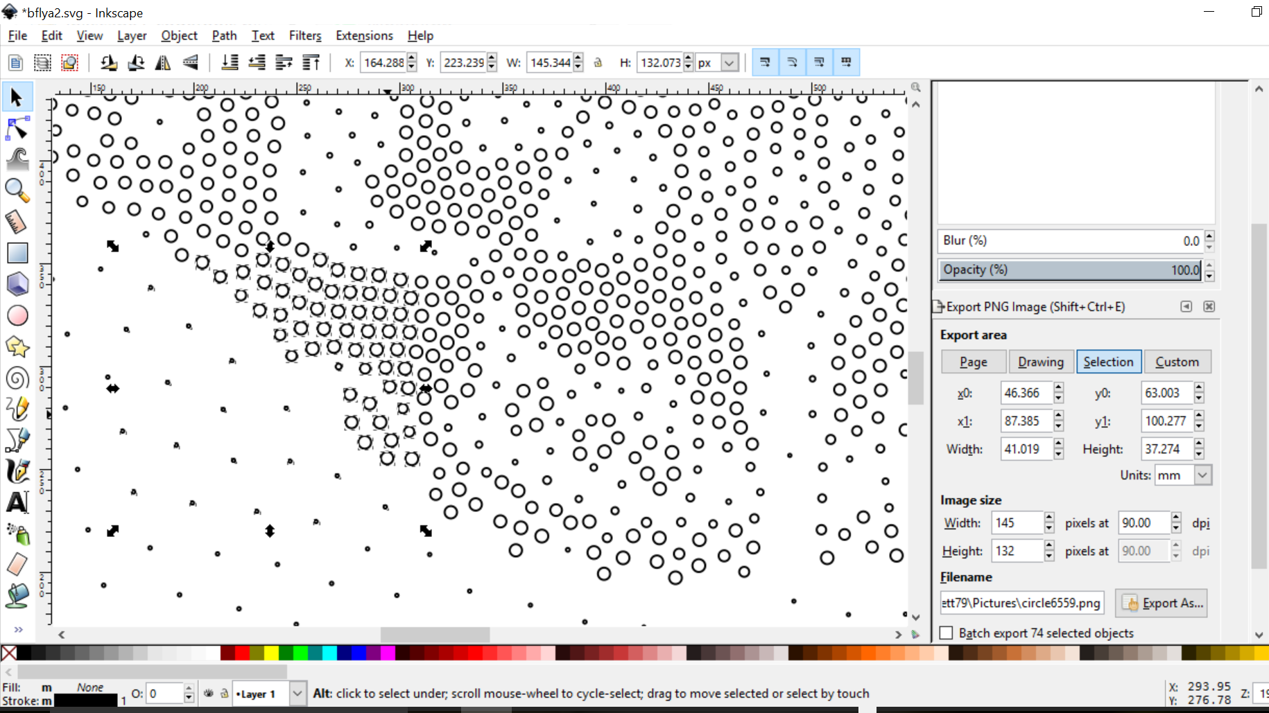

I am having a problem. Please see a screenshot. I am sure you will recognize a problem. Onfortunatly I don't know how to even query for this behaviour, so I couldn't search here. Sorry If this is reported not the first time.
This happens when I try to do path to gcode second time. I noticed that this happens after I modified initial design (and remove layer from previous gcode generation. Not sure if this is relevant, but I do some transformation to my design: I remove all the splines "Flatten Beziers" and then add more points to all those small lines.
Screenshot 2016-08-13 17.50.39.png (33314 просмотров) <a class='original' href='./download/file.php?id=86822&sid=fb56bc98ddfc8c207812346eeb65bd51&mode=view' target=_blank>Загрузить оригинал (1.23 МБ)</a>

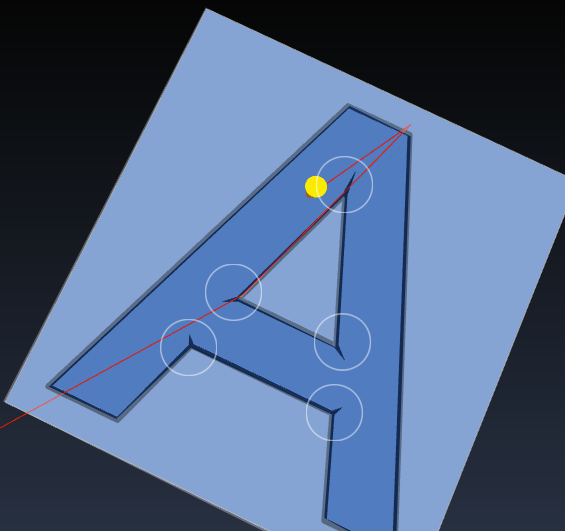

gcodetoolsEngraveProblem01.png (30924 просмотра) <a class='original' href='./download/file.php?id=99106&sid=fb56bc98ddfc8c207812346eeb65bd51&mode=view' target=_blank>Загрузить оригинал (49.94 КБ)</a>
Engrave question:
How do I avoid the variable z cuts shown? They are either going in the opposite direction, or the maybe conical bit is entering too soon?
I have tried various combinations of path reversing and it still ends up spoiling the areas I want to be left uncut.
I am a printer (letterpress=Gutenberg printing techniques, popular until 1960 commercially) artist and trying to cut printing blocks out of wood, like a woodcut, a common fine-art printmaking technique.

Re: Inkscape Gcodetools plug-in English support forum
Сообщение karbonis »
Ok, I had openSCAM tools incorrectly configured. So everything works!
This is really a terrific thing you put together, thanks!

I just want to say thank you to Nick and the others for a wonderful tool set. I am very interested in the engrave feature and I'm trying to use it to cut holes of varying diameter to create a stipple effect art work. I have been able to produce gcode using the engrave tutorial but it doesn't use the varying width of the V cutter to make the different hole sizes by plunging to different Z heights. Instead, it plunges and then moves in a start pattern to expand the diameter.
I've attached a picture of the svg holes I'm trying to cut (only need to remove the surface and not go all the way through)
holes svg (28856 просмотров) <a class='original' href='./download/file.php?id=110499&sid=fb56bc98ddfc8c207812346eeb65bd51&mode=view' target=_blank>Загрузить оригинал (636.18 КБ)</a>
holes svg
and a close up of the gcode path in my gcode simulator (green line)
hole gcode (28856 просмотров) <a class='original' href='./download/file.php?id=110498&sid=fb56bc98ddfc8c207812346eeb65bd51&mode=view' target=_blank>Загрузить оригинал (535.25 КБ)</a>
hole gcode
Please could the developers or anyone else help / explain how I can ensure the hole width is controlled with different Z depths for a V bit, rather than the radial XY moves? This is making the file take much longer to execute than is necessary.
Thank you!

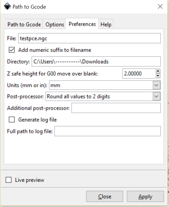

Michal_K писал(а):I'm trying to find an option to get max 3 decimal places instead of 6 - I'm working in wood with a CNC milling machine and I don't need such a accuracy, second thing: it's a good and simple way to reduce the end file size which can be critical if you have "limited" memory volume in your machine.
Can you please give me a tip..
Yes, use a text editor like notepad++ (Windows) to open (in administrator mode so you can later save changes) the [highlight=]gcodetools.py[/highlight] file in your Inkscape extensions folder (e.g. C:\Program Files\Inkscape\share\extensions) and look for this section of code (use a Ctrl+f in notepad++ to search down the list for instances of "round" and you'll find it):
Screenshot (74).png (28783 просмотра) <a class='original' href='./download/file.php?id=110755&sid=fb56bc98ddfc8c207812346eeb65bd51&mode=view' target=_blank>Загрузить оригинал (208.72 КБ)</a>
Now, change
x=round(x,4) #round to 4 decimals
to
x=round(x,3) #round to 3 decimals
I actually use 2 decimals here as I don't believe my machine has 0.01mm precision.
Repeat this for the following lines too:
y=round(y,4) #round to 4 decimals
w=round(w,4) #round to 4 decimals
Now save (this is why you needed to open the text editor in administrator mode).
If you want to edit the GUI pop-up, you can do this by changing "4" to "3" in the relevant parts of the file [highlight=]gcodetools_path_to_gcode.inx[/highlight] in the same Inkscape extension folder. Now, if Inkscape is already open, save your work and restart it. If not, just open your file in Inkscape.
Now, when you get to the point where you are in Path to Gcode window, from the gcodetools extension sub-menu, select Preferences tab
Screenshot (76).png (28783 просмотра) <a class='original' href='./download/file.php?id=110756&sid=fb56bc98ddfc8c207812346eeb65bd51&mode=view' target=_blank>Загрузить оригинал (73.67 КБ)</a>
and click under the dropdown for Post-processor. You want to select the option which says Round all values to X digits (where X should be either 4 or 3, depending on whether you changed the .inx file).
Carry out the rest of your workflow as before and you should get reduced decimal places in your gcode .nc or .nce files.
