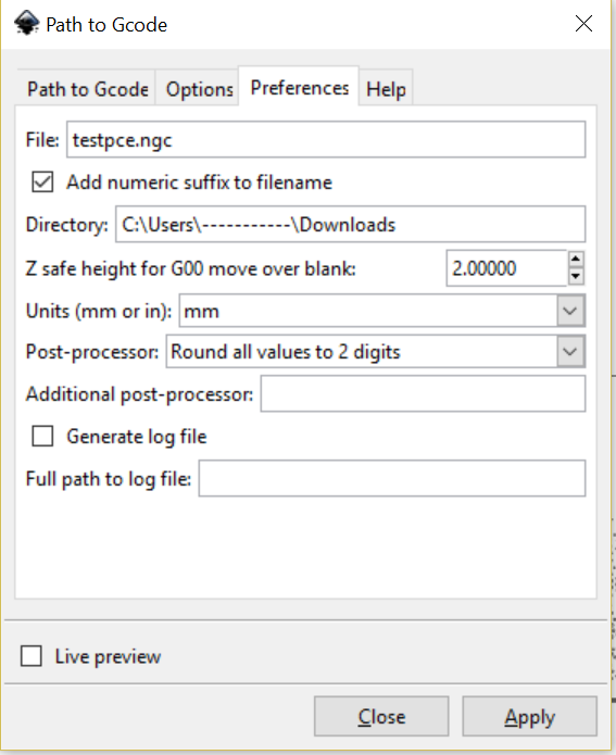

I am having a problem. Please see a screenshot. I am sure you will recognize a problem. Onfortunatly I don't know how to even query for this behaviour, so I couldn't search here. Sorry If this is reported not the first time.
This happens when I try to do path to gcode second time. I noticed that this happens after I modified initial design (and remove layer from previous gcode generation. Not sure if this is relevant, but I do some transformation to my design: I remove all the splines "Flatten Beziers" and then add more points to all those small lines.
Screenshot 2016-08-13 17.50.39.png (34297 просмотров) <a class='original' href='./download/file.php?id=86822&mode=view' target=_blank>Загрузить оригинал (1.23 МБ)</a>

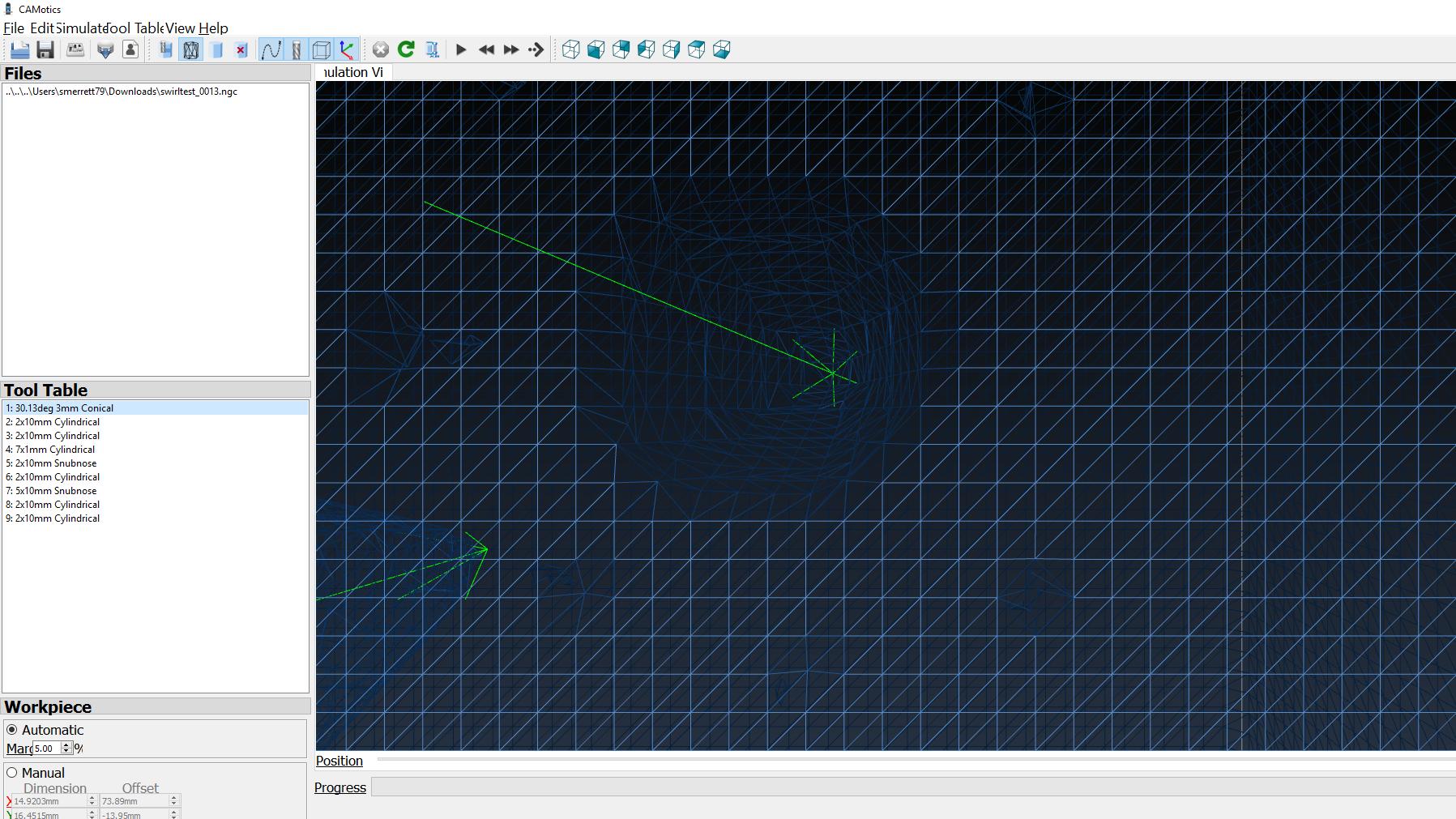

gcodetoolsEngraveProblem01.png (31907 просмотров) <a class='original' href='./download/file.php?id=99106&mode=view' target=_blank>Загрузить оригинал (49.94 КБ)</a>
Engrave question:
How do I avoid the variable z cuts shown? They are either going in the opposite direction, or the maybe conical bit is entering too soon?
I have tried various combinations of path reversing and it still ends up spoiling the areas I want to be left uncut.
I am a printer (letterpress=Gutenberg printing techniques, popular until 1960 commercially) artist and trying to cut printing blocks out of wood, like a woodcut, a common fine-art printmaking technique.

Ok, I had openSCAM tools incorrectly configured. So everything works!
This is really a terrific thing you put together, thanks!

and a close up of the gcode path in my gcode simulator (green line)
hole gcode (29839 просмотров) <a class='original' href='./download/file.php?id=110498&mode=view' target=_blank>Загрузить оригинал (535.25 КБ)</a>
hole gcode
Please could the developers or anyone else help / explain how I can ensure the hole width is controlled with different Z depths for a V bit, rather than the radial XY moves? This is making the file take much longer to execute than is necessary.
Thank you!

Now, when you get to the point where you are in Path to Gcode window, from the gcodetools extension sub-menu, select Preferences tab
Screenshot (76).png (29766 просмотров) <a class='original' href='./download/file.php?id=110756&mode=view' target=_blank>Загрузить оригинал (73.67 КБ)</a>
and click under the dropdown for Post-processor. You want to select the option which says Round all values to X digits (where X should be either 4 or 3, depending on whether you changed the .inx file).
Carry out the rest of your workflow as before and you should get reduced decimal places in your gcode .nc or .nce files.
