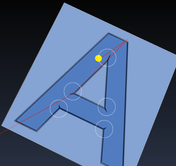

Regarding the tangent knife tool.
Is there any way to enable a retract/lift action for the z axes if the angle between two points is greater than a certain degree. In my case 45 degrees would be a start so that I don't break my blades?

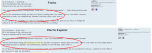

Hello,
I'm trying to help someone use your Gcode tools extensions in Inkscape. We're both using version 0.92.1 and both on Windows. I'm on Windows 7 and they're on Windows XP.
We're using your tutorial which is attached PDF. We're confused about Step 6. Could you please explain the following?
"Go to Extensions -> Gcode tools ...
Fill in Tool diameter in the Preferences tab
Then go to Area tab, and fill in Area radius."
There seems to be something missing between "Gcode tools ..." and "Fill in Tool diameter...." Which dialog should we open?
I did find Area extension dialog which does have an Area tab. But there is no option or setting called "Area radius". There is "Area Width". But most people think of width being equivalent to diameter. And mathematically, diameter is twice the radius (radius times 2).
We can figure out the Area Radius ok, using your instructions (which come after the quote above). But do we multiply the radius by 2, and enter in Area Width? Or else, where do we enter the Area Radius?
What about filling in Tool Diameter? I find that the Area dialog does have a Preferences tab. But there is no option or setting called "Tool Diameter".
We already found the tool diameter, using Tools Library dialog > Cylinder. But we don't know where to put it.
Or maybe Area dialog is not where the Area Radius and Tool Diameter need to be entered? If not, where to put them?
Also, near the bottom of Step 6, it says to choose "Calculate Area curves" and click Apply. But I can't find anything about "Calculate Area curves" in Area dialog, or in any of the gcodetools extension dialogs. How can we complete Step 6?
Thank you very much :)

Here's the strange part. When I read the message using Firefox, I see a slightly different message than what I see when I use IE. Please see attached screenshots. I've highlighted the different text with yellow. When I look at the message with IE, it's the same message that I posted. But if I look at the message with Firefox, it's a different message.
So you can see that in one place in the Firefox message, there's an extra word - "not" which is a pretty important word! It says "I did not find...." instead of "I did find...."! And in another place, parts of the text is missing. I highlighted the extra text and the missing text in yellow.
Should I make a screenshot of the whole correct message, to make sure you can read the correct info? Or should I try re-posting the message?
Thanks
Edit - So it looks like we can edit a message soon after it's posted. But the next day must be too late. Anyway, even with this message that I just posted, it looks different in Firefox! Very, very strange!!
browser-difference.png (29099 просмотров) <a class='original' href='./download/file.php?id=109445&mode=view' target=_blank>Загрузить оригинал (191 КБ)</a>

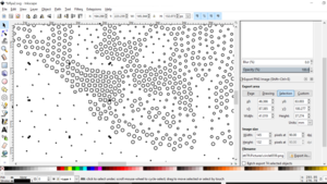

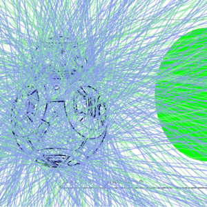

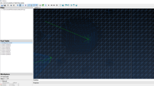

I just want to say thank you to Nick and the others for a wonderful tool set. I am very interested in the engrave feature and I'm trying to use it to cut holes of varying diameter to create a stipple effect art work. I have been able to produce gcode using the engrave tutorial but it doesn't use the varying width of the V cutter to make the different hole sizes by plunging to different Z heights. Instead, it plunges and then moves in a start pattern to expand the diameter.
I've attached a picture of the svg holes I'm trying to cut (only need to remove the surface and not go all the way through)
holes svg (28878 просмотров) <a class='original' href='./download/file.php?id=110499&mode=view' target=_blank>Загрузить оригинал (636.18 КБ)</a>
holes svg
and a close up of the gcode path in my gcode simulator (green line)
hole gcode (28878 просмотров) <a class='original' href='./download/file.php?id=110498&mode=view' target=_blank>Загрузить оригинал (535.25 КБ)</a>
hole gcode
Please could the developers or anyone else help / explain how I can ensure the hole width is controlled with different Z depths for a V bit, rather than the radial XY moves? This is making the file take much longer to execute than is necessary.
Thank you!

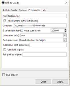

Michal_K писал(а):I'm trying to find an option to get max 3 decimal places instead of 6 - I'm working in wood with a CNC milling machine and I don't need such a accuracy, second thing: it's a good and simple way to reduce the end file size which can be critical if you have "limited" memory volume in your machine.
Can you please give me a tip..
Yes, use a text editor like notepad++ (Windows) to open (in administrator mode so you can later save changes) the [highlight=]gcodetools.py[/highlight] file in your Inkscape extensions folder (e.g. C:\Program Files\Inkscape\share\extensions) and look for this section of code (use a Ctrl+f in notepad++ to search down the list for instances of "round" and you'll find it):
Screenshot (74).png (28805 просмотров) <a class='original' href='./download/file.php?id=110755&mode=view' target=_blank>Загрузить оригинал (208.72 КБ)</a>
Now, change
x=round(x,4) #round to 4 decimals
to
x=round(x,3) #round to 3 decimals
I actually use 2 decimals here as I don't believe my machine has 0.01mm precision.
Repeat this for the following lines too:
y=round(y,4) #round to 4 decimals
w=round(w,4) #round to 4 decimals
Now save (this is why you needed to open the text editor in administrator mode).
If you want to edit the GUI pop-up, you can do this by changing "4" to "3" in the relevant parts of the file [highlight=]gcodetools_path_to_gcode.inx[/highlight] in the same Inkscape extension folder. Now, if Inkscape is already open, save your work and restart it. If not, just open your file in Inkscape.
Now, when you get to the point where you are in Path to Gcode window, from the gcodetools extension sub-menu, select Preferences tab
Screenshot (76).png (28805 просмотров) <a class='original' href='./download/file.php?id=110756&mode=view' target=_blank>Загрузить оригинал (73.67 КБ)</a>
and click under the dropdown for Post-processor. You want to select the option which says Round all values to X digits (where X should be either 4 or 3, depending on whether you changed the .inx file).
Carry out the rest of your workflow as before and you should get reduced decimal places in your gcode .nc or .nce files.
