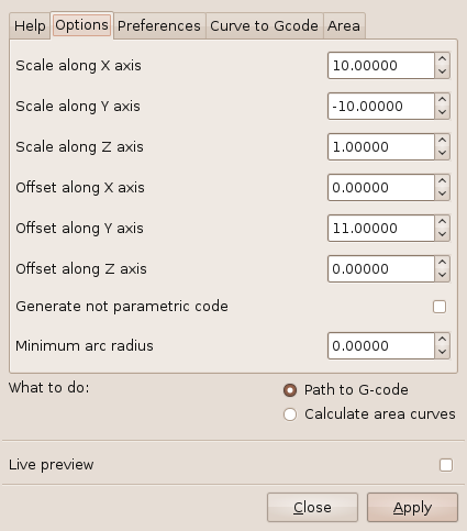

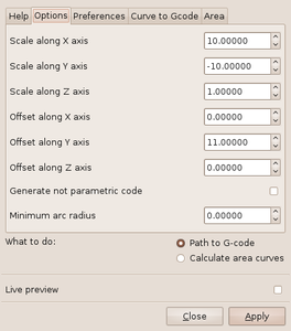

Options tab
Снимок-GCODE tools.png (128299 просмотров) <a class='original' href='./download/file.php?id=165&sid=1510869b49339e3ca96b05720386ae18&mode=view' target=_blank>Загрузить оригинал (33 КБ)</a>
Scale and offset along axis difines scaling and offsetting along axis. If "Generate not parametric code" is checked all calculations are made in the plug-in and resulting code will be usual plain code, otherwise code will be like :
"G03 X[428*#5+#8] Y[-590*#5+#9] Z[-20*#7+#10] I[0*#5] J[45*#5]"
and the header will contain:
#4  = 700.000000 (Feed)
#5  = 1.000000 (Scale xy)
#7  = 1.000000 (Scale z)
#8  = -300.000000 (Offset x)
#9  = 300.000000 (Offset y)
#10 = 0.000000 (Offset z)
#11 = 10.000000 (Safe distanse)
In this way it's easier to change computed Gcode with out any additional software, you can just change some values in the header to change the position, scaling factor or feed. So if your controlling software supports calculations inside the code, live "Generate not parametric code" unchecked.
Minimum arc radius is a value of minimum arc radius that can be used during biarc interpolation, all arcs having radius less than this value will be converted to straight lines. EMC2 raises an error if arc radius is less than 0.02mm so this value should not be less than 0.02 (if you are using mm as unit).

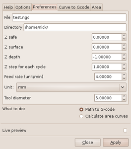

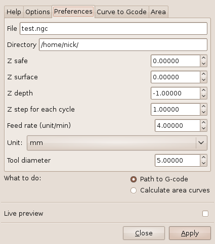

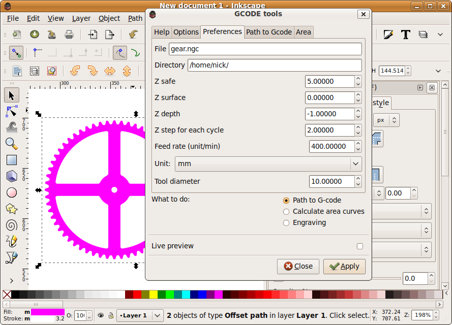

Preferences tab
Снимок-GCODE tools-1.png (128299 просмотров) <a class='original' href='./download/file.php?id=166&sid=1510869b49339e3ca96b05720386ae18&mode=view' target=_blank>Загрузить оригинал (32.67 КБ)</a>
File - file name for output.
Directory - Directory for output. If output directory contains 'header' and/or 'footer' file they will be used as header and footer for resulting Gcode.
Attention! You must specify directory in which you have rights to write! (For example my home directory '/home/nick/')
Z safe - Z coordinate for safe traverse above the object.
Z surface - Z coordinate of the surface.
Z depth - Z coordinate of cutting depth.
Z step for each cycle - The increment value for Z axis for each cycle of multi pass cutting.
Feed rate - feed rate in selected units.
Unit - units. Attention! This value affects only one string in Gcode (in the header there wiil be "G21 (All units in mm)" or "G20 (All units in inch)") no additional calculations are made. This plug-in uses Inkscape's native unit - px, so if mm is selected 1px=1mm, if inch is selected 1px=1". So no mater what is selected result's bounds will be the same in units.
Tool diameter - is tool's diameter in units.

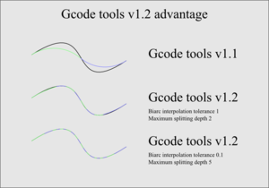

Biarc interpolation tolerance - every time the path's segment being approximated by biarc, distance between biarc and path's segment is calculated. If this distance exceeds difened value the segment splits into two segments, and each of them will be approximated separately.
Maximum splitting depth - defines home many times one segment can be splitted.

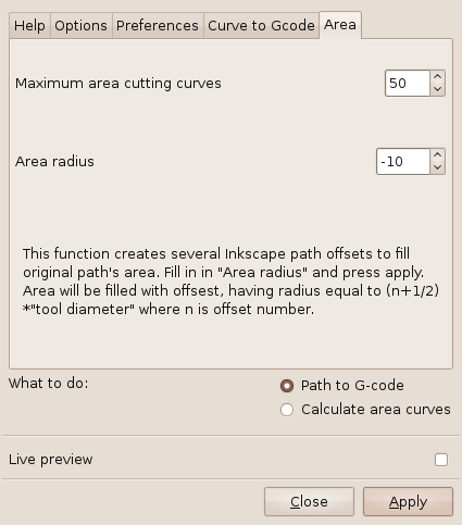

Area tab
Снимок-GCODE tools-3.png (128299 просмотров) <a class='original' href='./download/file.php?id=168&sid=1510869b49339e3ca96b05720386ae18&mode=view' target=_blank>Загрузить оригинал (23.98 КБ)</a>
Maximum area cutting curve - maximum number of area cutting curves that will be created.
Area radius - the radius of final offset. if in less than 0 the curves will be calculated for outside area.

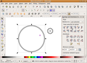

Here is an illustration of automatic path subdivision (from ver. 1.2.):

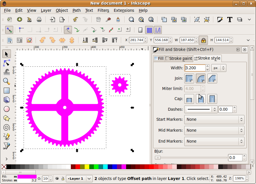

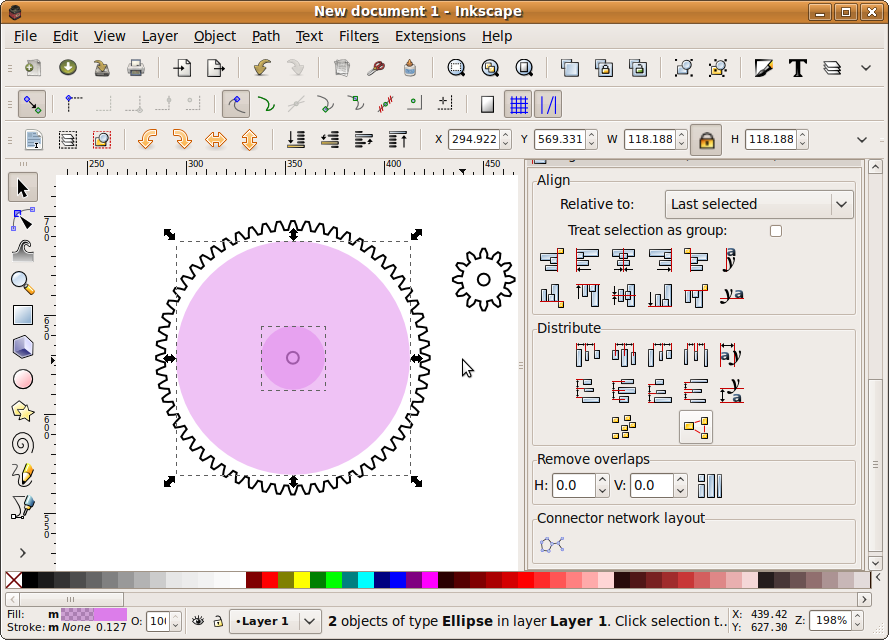

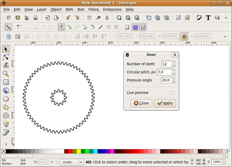

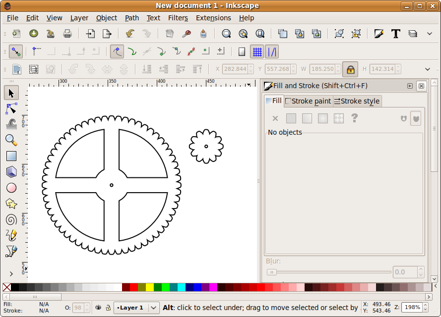

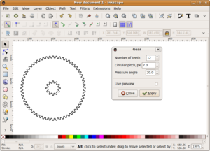

Tutorial 01. Make some gears using Gcode tools and Gear extension.
1. First of all let's draw some gears using Gear extension
Fill in parameters. Note that gear radius depends on Number of teeth and Circular pitch. So if you want your gearbox be 1:5 you should fill in Numbers of teeth 1:5 (12 and 60 for example) other parameters live the same for both gears.
Notice that gears are Group Objects so Ungroup them (Ctrl+Shift+G).
gcode_tools_gear_tutorial_0001.png (130441 просмотр) <a class='original' href='./download/file.php?id=278&sid=1510869b49339e3ca96b05720386ae18&mode=view' target=_blank>Загрузить оригинал (118.56 КБ)</a>

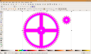

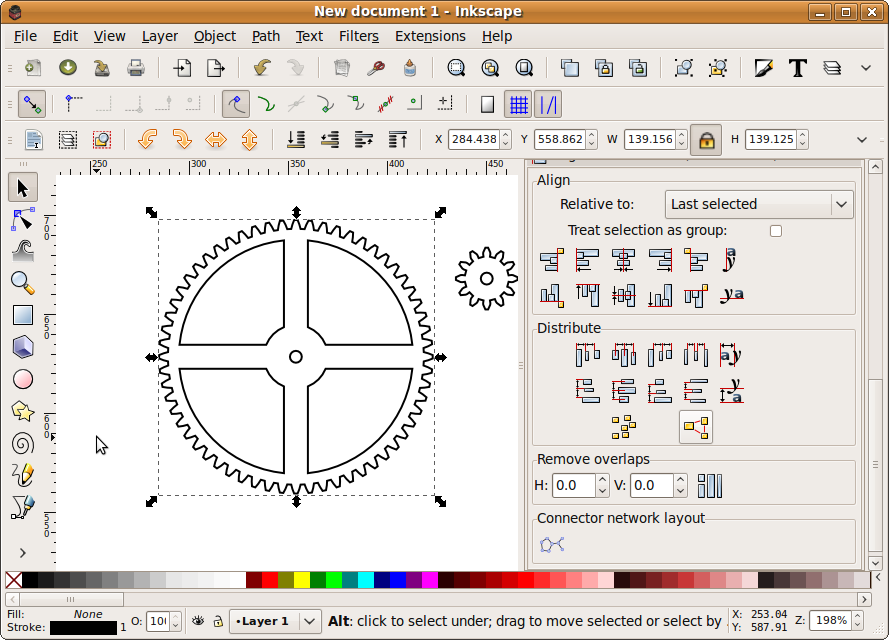

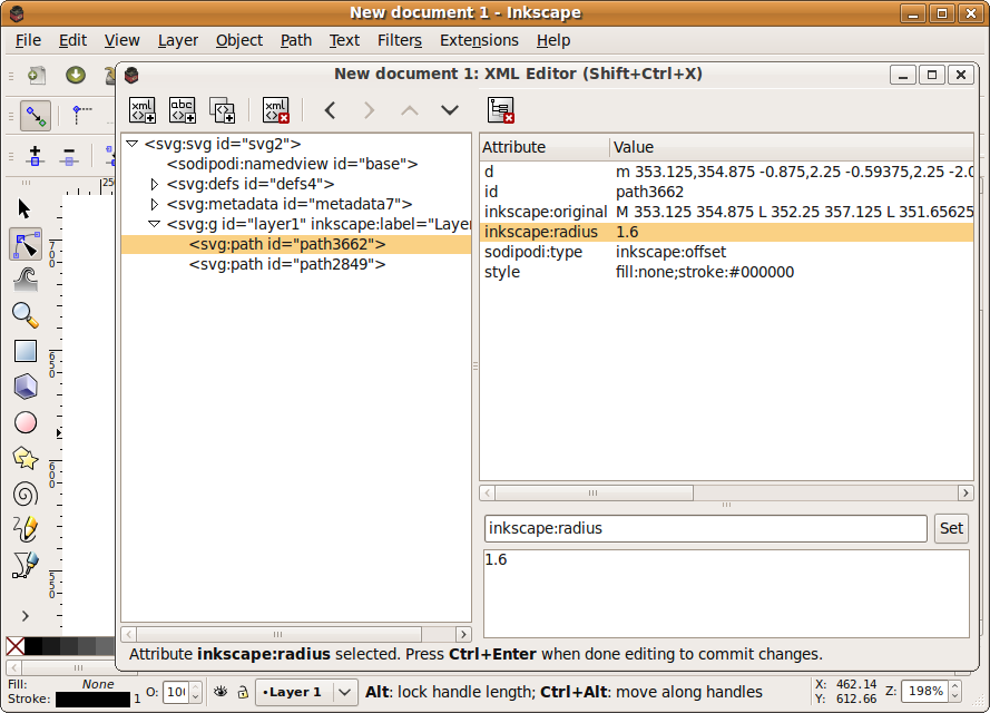

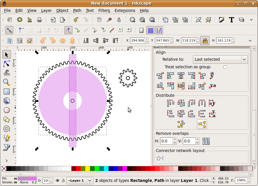

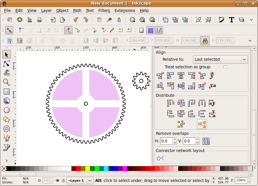

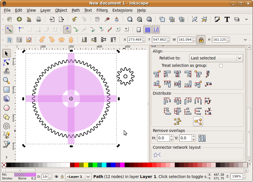

2. Making holes for the roller
Draw the circle with following dimensions 6x6 px.
Attention When Inkscape calculates dimensions it includes stroke width in width and height. So if you want to define exact values remove stroke paint and define values in numerical fields. You can change fill color to see your object.
Make a copy of circle (We have tow gears we need two circles).
Select gear and the circle. Make alignments so circle will be at the center of the gear. (Ctrl+Shift+A -> Center objects horizontally and Center objects vertically).
gcode_tools_gear_tutorial_0002.png (130441 просмотр) <a class='original' href='./download/file.php?id=279&sid=1510869b49339e3ca96b05720386ae18&mode=view' target=_blank>Загрузить оригинал (140.31 КБ)</a>
Press Ctrl+"-" or Path->Difference.
Repeat with the second gear.
gcode_tools_gear_tutorial_0003.png (130441 просмотр) <a class='original' href='./download/file.php?id=280&sid=1510869b49339e3ca96b05720386ae18&mode=view' target=_blank>Загрузить оригинал (137.39 КБ)</a>
3. Let's make some additional holes to make big gear lighter
Draw two circles. And align them to the center of the gear. Make Path->Difference (Ctrl+"-").
Note when you make difference the topmost path subtracts from bottommost. You can use Page Up / Page Down / Home / End to move the path to the top or to the bottom.
gcode_tools_gear_tutorial_0004.png (130441 просмотр) <a class='original' href='./download/file.php?id=281&sid=1510869b49339e3ca96b05720386ae18&mode=view' target=_blank>Загрузить оригинал (143.7 КБ)</a>
gcode_tools_gear_tutorial_0005.png (130441 просмотр) <a class='original' href='./download/file.php?id=282&sid=1510869b49339e3ca96b05720386ae18&mode=view' target=_blank>Загрузить оригинал (143.5 КБ)</a>
Draw a rectangle, align it to the center of the gear. Make a copy of it (Ctrl+D) or just press Space bar when you will rotate/move/scale it. Rotate the copy, press Ctrl while rotating to rotate on exact 90 degrees.
gcode_tools_gear_tutorial_0006.png (130441 просмотр) <a class='original' href='./download/file.php?id=283&sid=1510869b49339e3ca96b05720386ae18&mode=view' target=_blank>Загрузить оригинал (145.05 КБ)</a>
Make a Path->Union (Ctrl+"+") of the rectangles.
gcode_tools_gear_tutorial_0007.png (130441 просмотр) <a class='original' href='./download/file.php?id=284&sid=1510869b49339e3ca96b05720386ae18&mode=view' target=_blank>Загрузить оригинал (144.18 КБ)</a>
Subtract the union from circles.
gcode_tools_gear_tutorial_0008.png (130441 просмотр) <a class='original' href='./download/file.php?id=285&sid=1510869b49339e3ca96b05720386ae18&mode=view' target=_blank>Загрузить оригинал (139.55 КБ)</a>
And finally subtract holes from the gear.
gcode_tools_gear_tutorial_0009.png (130441 просмотр) <a class='original' href='./download/file.php?id=286&sid=1510869b49339e3ca96b05720386ae18&mode=view' target=_blank>Загрузить оригинал (147.56 КБ)</a>
5. Prepare gears for export to Gcode
If you want your gears be precise you should offset the path by 1/2 of tool diameter to material only outside the gear. You can do it in your controlling software or in Inkscape.
So if you want to do it in Inkscape:
Select first gear. Path->Dynamic offset. Then open XML editor (Ctrl+Shift+X) to define exact value.
Set "inkscape:radius" to the tool diameter/2 (for me it's 1.6 because I have 3.2mm cutter).
Note if you use inches instead of mm you should fill in diameter/2 in inches so it will be 0.125 for 1/4 cutter.
gcode_tools_gear_tutorial_0010.png (130441 просмотр) <a class='original' href='./download/file.php?id=287&sid=1510869b49339e3ca96b05720386ae18&mode=view' target=_blank>Загрузить оригинал (105.63 КБ)</a>
Hmmm... It does not look like a good gear, isn't it?
gcode_tools_gear_tutorial_0011.png (130441 просмотр) <a class='original' href='./download/file.php?id=288&sid=1510869b49339e3ca96b05720386ae18&mode=view' target=_blank>Загрузить оригинал (126.12 КБ)</a>
But do not worry it should look like that. To see how your gear will look like after cutting, set fill to some color, stroke to white
and stroke width equals to your cutter diameter. Also set stroke join to round join and stroke cap to round cap.
That's better :).
gcode_tools_gear_tutorial_0012.png (130441 просмотр) <a class='original' href='./download/file.php?id=289&sid=1510869b49339e3ca96b05720386ae18&mode=view' target=_blank>Загрузить оригинал (127.33 КБ)</a>
You cat see that space between teeth become rounded it is because this distance is only 7mm long and cutter diameter is 3.2mm.
Once more do Path->Object to path to make your gears path not dynamic offsets. (For dynamic offset it is not actually needed but it better be done just in case :) )
6. Export to Gcode
Make sure that all objects you want to export are actually Paths.
You can check that all objects are paths at the status bar it mast be like "2 objects of type Path selected".
Ungroup all groups (Ctrl+Shif+G). Convert all objects to paths Path->Object to path (Ctrl+Shift+J). Repeat if needed.
Select paths you want to export. Open Extensions->Gcode tools.
Fill in parameters in Preferences and Path to Gcode tab.
You will need to fill:
  • Filename
  • Directory
  • Z axis parameters
  • Optionally other parameters
gcode_tools_gear_tutorial_0014.png (130441 просмотр) <a class='original' href='./download/file.php?id=291&sid=1510869b49339e3ca96b05720386ae18&mode=view' target=_blank>Загрузить оригинал (120.74 КБ)</a>
Press Apply.
Gcode tools will convert all paths to circular and straight interpolations (G02, G03 and G01), create file containing Gcode + standard header and footer (in there's no "header" and "footer" files in selected directory), create preview of cutting trajectory (red lines - G01, green and blue - G02 and G03).
gcode_tools_gear_tutorial_0015.png (130441 просмотр) <a class='original' href='./download/file.php?id=292&sid=1510869b49339e3ca96b05720386ae18&mode=view' target=_blank>Загрузить оригинал (192.51 КБ)</a>
gear.ngc
Generated Gcode of gears from the tutorial
(52.02 КБ) 3887 скачиваний
Thats it. Work with pleasure :).

  5. Extensions -> Gcode tools... Now we are almost ready to calculate area curves. Fill in the following parameters:
    • At the Preferences tab
      • Tool diameter. Tool diameter mast be in selected units!
    • At the Area tab
      • Maximum area cutting curves (maximum offsets)- this parameter is needed to eliminate infinite loop or creation of big amount of offsets.
      • Area radius - this parameter defines maximum area radius in pixels (Note that 1 px = 1 unit selected in the Preferences tab with out any conversion).
        How to calculate Area radius? There's a lot of way to do it:
        • Simplest way is to look at the thickest part of the path and imagine it's width in px and divide it by 2 (Joke :). But this is actually a way if you know your objects parameters.)
        • Similar to previous method: look at the thickest part of the path and measure it's width with Besier tool and divide it by 2. (The status bar shows distance in px while you are drawing a path.)
        • Convert your path to Dynamic offset, press F2, move the control point to make your path small and almost disappear. Then pres Ctrl+Shift+X, a XML editor window will be showed, then look at th "inkscape:radius" value - that is exact value that was needed.
    • Select Calculate area curves
  6. And press Apply
That's all. Have fun :).

I am an EMC2 user as well and would like to do use the area function but cannot understand it. Could you please post back to the forum how you actually made this work.
One of the interesting things I've found out about inkscape and this plugin is the units. The author recommends to draw in px and then select the units in the G-Code Plugin. I prefer to view my drawing in inches since that is what my machine is configured for. What I do is just put a scaling factor of 1/90 for each of the x and y axis. To set this up I followed the instructions from the website http://www.freesoftwaremagazine.com/boo ... s/inkscape
I then set up the grid (see figure 3). First, I selected File->Document Properties, and set the paper size to US letter and all of the units to “inches”. I then went to the “Grid” tab; started a new “rectangular” grid; and specified minor spacings of 0.05” with major grid lines for every 20 minor lines (which puts the major grid lines on 1” intervals). I then set the colors to something visible enough. Finally, I went to the “Snap” tab; enabled snapping to the grid; and set the sensitivity to the maximum (50 pixels).

1. start thinking in pixels. Start thinking that 1 inch = 1 px
2. Fill in tool diameter.
3. Go to area tab and fill in area radius parameter:
it's area radius in px = area thickest plase in px
you can use Pen (beiser) tool to measure it.
4. Choose Calculate area curves
4. Select your path and press apply.
5. You'll get a group of paths that will cover the area.
Now you can modify them if needed and do ungroup and Path to gcode to export them to Gcode.
About inches:
There are a lot of thin places, for example EMC2 raises an error if arc radius is smaller than .02 mm, but for inches this value is different. I can implement units conversion but we have to describe all thin places first to prevent future bugs.
As for now you can use scaling that provided by the plug-in to convert any units to pixels. And if you'll do it could you write your experience. That will show us a lot of things that have to be done to implement native unit cinversion.
