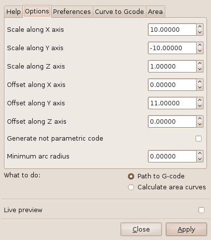

Manual ver. 1.2.
Interface
Options tab
Снимок-GCODE tools.png (128305 просмотров) <a class='original' href='./download/file.php?id=165&mode=view' target=_blank>Загрузить оригинал (33 КБ)</a>
Scale and offset along axis difines scaling and offsetting along axis. If "Generate not parametric code" is checked all calculations are made in the plug-in and resulting code will be usual plain code, otherwise code will be like :
"G03 X[428*#5+#8] Y[-590*#5+#9] Z[-20*#7+#10] I[0*#5] J[45*#5]"

In this way it's easier to change computed Gcode with out any additional software, you can just change some values in the header to change the position, scaling factor or feed. So if your controlling software supports calculations inside the code, live "Generate not parametric code" unchecked.
Minimum arc radius is a value of minimum arc radius that can be used during biarc interpolation, all arcs having radius less than this value will be converted to straight lines. EMC2 raises an error if arc radius is less than 0.02mm so this value should not be less than 0.02 (if you are using mm as unit).

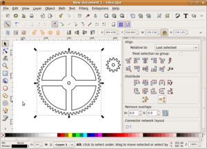

Tutorial 01. Make some gears using Gcode tools and Gear extension.
1. First of all let's draw some gears using Gear extension
Fill in parameters. Note that gear radius depends on Number of teeth and Circular pitch. So if you want your gearbox be 1:5 you should fill in Numbers of teeth 1:5 (12 and 60 for example) other parameters live the same for both gears.
Notice that gears are Group Objects so Ungroup them (Ctrl+Shift+G).
gcode_tools_gear_tutorial_0001.png (130447 просмотров) <a class='original' href='./download/file.php?id=278&mode=view' target=_blank>Загрузить оригинал (118.56 КБ)</a>

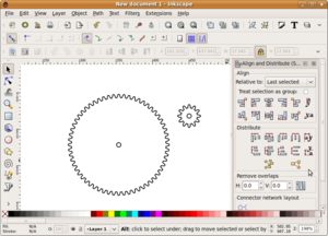

2. Making holes for the roller
Draw the circle with following dimensions 6x6 px.
Attention When Inkscape calculates dimensions it includes stroke width in width and height. So if you want to define exact values remove stroke paint and define values in numerical fields. You can change fill color to see your object.
Make a copy of circle (We have tow gears we need two circles).
Select gear and the circle. Make alignments so circle will be at the center of the gear. (Ctrl+Shift+A -> Center objects horizontally and Center objects vertically).

Repeat with the second gear.
gcode_tools_gear_tutorial_0003.png (130447 просмотров) <a class='original' href='./download/file.php?id=280&mode=view' target=_blank>Загрузить оригинал (137.39 КБ)</a>
3. Let's make some additional holes to make big gear lighter
Draw two circles. And align them to the center of the gear. Make Path->Difference (Ctrl+"-").
Note when you make difference the topmost path subtracts from bottommost. You can use Page Up / Page Down / Home / End to move the path to the top or to the bottom.
gcode_tools_gear_tutorial_0004.png (130447 просмотров) <a class='original' href='./download/file.php?id=281&mode=view' target=_blank>Загрузить оригинал (143.7 КБ)</a>
gcode_tools_gear_tutorial_0005.png (130447 просмотров) <a class='original' href='./download/file.php?id=282&mode=view' target=_blank>Загрузить оригинал (143.5 КБ)</a>
Draw a rectangle, align it to the center of the gear. Make a copy of it (Ctrl+D) or just press Space bar when you will rotate/move/scale it. Rotate the copy, press Ctrl while rotating to rotate on exact 90 degrees.
gcode_tools_gear_tutorial_0006.png (130447 просмотров) <a class='original' href='./download/file.php?id=283&mode=view' target=_blank>Загрузить оригинал (145.05 КБ)</a>
Make a Path->Union (Ctrl+"+") of the rectangles.
gcode_tools_gear_tutorial_0007.png (130447 просмотров) <a class='original' href='./download/file.php?id=284&mode=view' target=_blank>Загрузить оригинал (144.18 КБ)</a>
Subtract the union from circles.
gcode_tools_gear_tutorial_0008.png (130447 просмотров) <a class='original' href='./download/file.php?id=285&mode=view' target=_blank>Загрузить оригинал (139.55 КБ)</a>
And finally subtract holes from the gear.
gcode_tools_gear_tutorial_0009.png (130447 просмотров) <a class='original' href='./download/file.php?id=286&mode=view' target=_blank>Загрузить оригинал (147.56 КБ)</a>

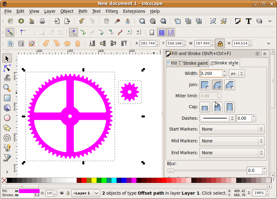

gcode_tools_gear_tutorial_0010.png (130447 просмотров) <a class='original' href='./download/file.php?id=287&mode=view' target=_blank>Загрузить оригинал (105.63 КБ)</a>
Hmmm... It does not look like a good gear, isn't it?
gcode_tools_gear_tutorial_0011.png (130447 просмотров) <a class='original' href='./download/file.php?id=288&mode=view' target=_blank>Загрузить оригинал (126.12 КБ)</a>
But do not worry it should look like that. To see how your gear will look like after cutting, set fill to some color, stroke to white
and stroke width equals to your cutter diameter. Also set stroke join to round join and stroke cap to round cap.
That's better :).
gcode_tools_gear_tutorial_0012.png (130447 просмотров) <a class='original' href='./download/file.php?id=289&mode=view' target=_blank>Загрузить оригинал (127.33 КБ)</a>
You cat see that space between teeth become rounded it is because this distance is only 7mm long and cutter diameter is 3.2mm.

Select paths you want to export. Open Extensions->Gcode tools.
Fill in parameters in Preferences and Path to Gcode tab.
You will need to fill:
  • Filename
  • Directory
  • Z axis parameters
  • Optionally other parameters
gcode_tools_gear_tutorial_0014.png (130447 просмотров) <a class='original' href='./download/file.php?id=291&mode=view' target=_blank>Загрузить оригинал (120.74 КБ)</a>
Press Apply.
Gcode tools will convert all paths to circular and straight interpolations (G02, G03 and G01), create file containing Gcode + standard header and footer (in there's no "header" and "footer" files in selected directory), create preview of cutting trajectory (red lines - G01, green and blue - G02 and G03).
gcode_tools_gear_tutorial_0015.png (130447 просмотров) <a class='original' href='./download/file.php?id=292&mode=view' target=_blank>Загрузить оригинал (192.51 КБ)</a>

1. start thinking in pixels. Start thinking that 1 inch = 1 px
2. Fill in tool diameter.
3. Go to area tab and fill in area radius parameter:
it's area radius in px = area thickest plase in px
you can use Pen (beiser) tool to measure it.
4. Choose Calculate area curves
4. Select your path and press apply.
5. You'll get a group of paths that will cover the area.
Now you can modify them if needed and do ungroup and Path to gcode to export them to Gcode.
One of the interesting things I've found out about inkscape and this plugin is the units. The author recommends to draw in px and then select the units in the G-Code Plugin. I prefer to view my drawing in inches since that is what my machine is configured for. What I do is just put a scaling factor of 1/90 for each of the x and y axis. To set this up I followed the instructions from the website http://www.freesoftwaremagazine.com/boo ... s/inkscape
I then set up the grid (see figure 3). First, I selected File->Document Properties, and set the paper size to US letter and all of the units to “inches”. I then went to the “Grid” tab; started a new “rectangular” grid; and specified minor spacings of 0.05” with major grid lines for every 20 minor lines (which puts the major grid lines on 1” intervals). I then set the colors to something visible enough. Finally, I went to the “Snap” tab; enabled snapping to the grid; and set the sensitivity to the maximum (50 pixels).
About inches:
There are a lot of thin places, for example EMC2 raises an error if arc radius is smaller than .02 mm, but for inches this value is different. I can implement units conversion but we have to describe all thin places first to prevent future bugs.
As for now you can use scaling that provided by the plug-in to convert any units to pixels. And if you'll do it could you write your experience. That will show us a lot of things that have to be done to implement native unit cinversion.
