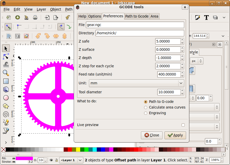

Preferences tab
Снимок-GCODE tools-1.png (126885 просмотров) <a class='original' href='./download/file.php?id=166&mode=view' target=_blank>Загрузить оригинал (32.67 КБ)</a>
File - file name for output.
Directory - Directory for output. If output directory contains 'header' and/or 'footer' file they will be used as header and footer for resulting Gcode.
Attention! You must specify directory in which you have rights to write! (For example my home directory '/home/nick/')
Z safe - Z coordinate for safe traverse above the object.
Z surface - Z coordinate of the surface.
Z depth - Z coordinate of cutting depth.
Z step for each cycle - The increment value for Z axis for each cycle of multi pass cutting.
Feed rate - feed rate in selected units.
Unit - units. Attention! This value affects only one string in Gcode (in the header there wiil be "G21 (All units in mm)" or "G20 (All units in inch)") no additional calculations are made. This plug-in uses Inkscape's native unit - px, so if mm is selected 1px=1mm, if inch is selected 1px=1". So no mater what is selected result's bounds will be the same in units.
Tool diameter - is tool's diameter in units.

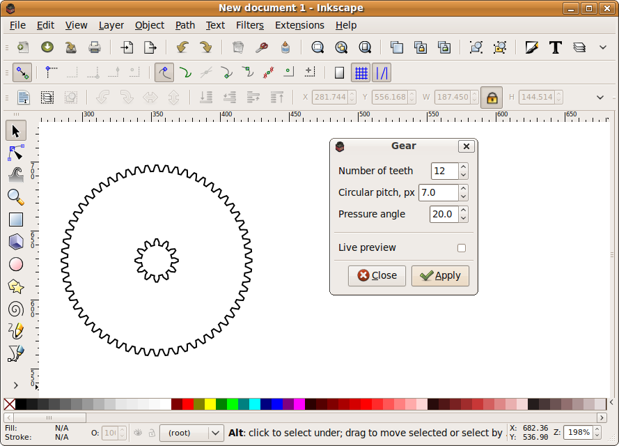

Tutorial 01. Make some gears using Gcode tools and Gear extension.
1. First of all let's draw some gears using Gear extension
Fill in parameters. Note that gear radius depends on Number of teeth and Circular pitch. So if you want your gearbox be 1:5 you should fill in Numbers of teeth 1:5 (12 and 60 for example) other parameters live the same for both gears.
Notice that gears are Group Objects so Ungroup them (Ctrl+Shift+G).
gcode_tools_gear_tutorial_0001.png (129027 просмотров) <a class='original' href='./download/file.php?id=278&mode=view' target=_blank>Загрузить оригинал (118.56 КБ)</a>

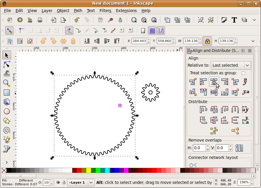

2. Making holes for the roller
Draw the circle with following dimensions 6x6 px.
Attention When Inkscape calculates dimensions it includes stroke width in width and height. So if you want to define exact values remove stroke paint and define values in numerical fields. You can change fill color to see your object.
Make a copy of circle (We have tow gears we need two circles).
Select gear and the circle. Make alignments so circle will be at the center of the gear. (Ctrl+Shift+A -> Center objects horizontally and Center objects vertically).
gcode_tools_gear_tutorial_0002.png (129027 просмотров) <a class='original' href='./download/file.php?id=279&mode=view' target=_blank>Загрузить оригинал (140.31 КБ)</a>
Press Ctrl+"-" or Path->Difference.
Repeat with the second gear.
gcode_tools_gear_tutorial_0003.png (129027 просмотров) <a class='original' href='./download/file.php?id=280&mode=view' target=_blank>Загрузить оригинал (137.39 КБ)</a>
3. Let's make some additional holes to make big gear lighter
Draw two circles. And align them to the center of the gear. Make Path->Difference (Ctrl+"-").
Note when you make difference the topmost path subtracts from bottommost. You can use Page Up / Page Down / Home / End to move the path to the top or to the bottom.
gcode_tools_gear_tutorial_0004.png (129027 просмотров) <a class='original' href='./download/file.php?id=281&mode=view' target=_blank>Загрузить оригинал (143.7 КБ)</a>
gcode_tools_gear_tutorial_0005.png (129027 просмотров) <a class='original' href='./download/file.php?id=282&mode=view' target=_blank>Загрузить оригинал (143.5 КБ)</a>
Draw a rectangle, align it to the center of the gear. Make a copy of it (Ctrl+D) or just press Space bar when you will rotate/move/scale it. Rotate the copy, press Ctrl while rotating to rotate on exact 90 degrees.
gcode_tools_gear_tutorial_0006.png (129027 просмотров) <a class='original' href='./download/file.php?id=283&mode=view' target=_blank>Загрузить оригинал (145.05 КБ)</a>
Make a Path->Union (Ctrl+"+") of the rectangles.
gcode_tools_gear_tutorial_0007.png (129027 просмотров) <a class='original' href='./download/file.php?id=284&mode=view' target=_blank>Загрузить оригинал (144.18 КБ)</a>
Subtract the union from circles.
gcode_tools_gear_tutorial_0008.png (129027 просмотров) <a class='original' href='./download/file.php?id=285&mode=view' target=_blank>Загрузить оригинал (139.55 КБ)</a>
And finally subtract holes from the gear.
gcode_tools_gear_tutorial_0009.png (129027 просмотров) <a class='original' href='./download/file.php?id=286&mode=view' target=_blank>Загрузить оригинал (147.56 КБ)</a>

6. Export to Gcode
Make sure that all objects you want to export are actually Paths.
You can check that all objects are paths at the status bar it mast be like "2 objects of type Path selected".
Ungroup all groups (Ctrl+Shif+G). Convert all objects to paths Path->Object to path (Ctrl+Shift+J). Repeat if needed.
Select paths you want to export. Open Extensions->Gcode tools.
Fill in parameters in Preferences and Path to Gcode tab.
You will need to fill:
  • Filename
  • Directory
  • Z axis parameters
  • Optionally other parameters
gcode_tools_gear_tutorial_0014.png (129027 просмотров) <a class='original' href='./download/file.php?id=291&mode=view' target=_blank>Загрузить оригинал (120.74 КБ)</a>
Press Apply.
Gcode tools will convert all paths to circular and straight interpolations (G02, G03 and G01), create file containing Gcode + standard header and footer (in there's no "header" and "footer" files in selected directory), create preview of cutting trajectory (red lines - G01, green and blue - G02 and G03).
gcode_tools_gear_tutorial_0015.png (129027 просмотров) <a class='original' href='./download/file.php?id=292&mode=view' target=_blank>Загрузить оригинал (192.51 КБ)</a>

I am an EMC2 user as well and would like to do use the area function but cannot understand it. Could you please post back to the forum how you actually made this work.
all you have to do:
1. start thinking in pixels. Start thinking that 1 inch = 1 px
2. Fill in tool diameter.
3. Go to area tab and fill in area radius parameter:
it's area radius in px = area thickest plase in px
you can use Pen (beiser) tool to measure it.
4. Choose Calculate area curves
4. Select your path and press apply.
5. You'll get a group of paths that will cover the area.
Now you can modify them if needed and do ungroup and Path to gcode to export them to Gcode.
One of the interesting things I've found out about inkscape and this plugin is the units. The author recommends to draw in px and then select the units in the G-Code Plugin. I prefer to view my drawing in inches since that is what my machine is configured for. What I do is just put a scaling factor of 1/90 for each of the x and y axis. To set this up I followed the instructions from the website http://www.freesoftwaremagazine.com/boo ... s/inkscape
I then set up the grid (see figure 3). First, I selected File->Document Properties, and set the paper size to US letter and all of the units to “inches”. I then went to the “Grid” tab; started a new “rectangular” grid; and specified minor spacings of 0.05” with major grid lines for every 20 minor lines (which puts the major grid lines on 1” intervals). I then set the colors to something visible enough. Finally, I went to the “Snap” tab; enabled snapping to the grid; and set the sensitivity to the maximum (50 pixels).
About inches:
There are a lot of thin places, for example EMC2 raises an error if arc radius is smaller than .02 mm, but for inches this value is different. I can implement units conversion but we have to describe all thin places first to prevent future bugs.
As for now you can use scaling that provided by the plug-in to convert any units to pixels. And if you'll do it could you write your experience. That will show us a lot of things that have to be done to implement native unit cinversion.
