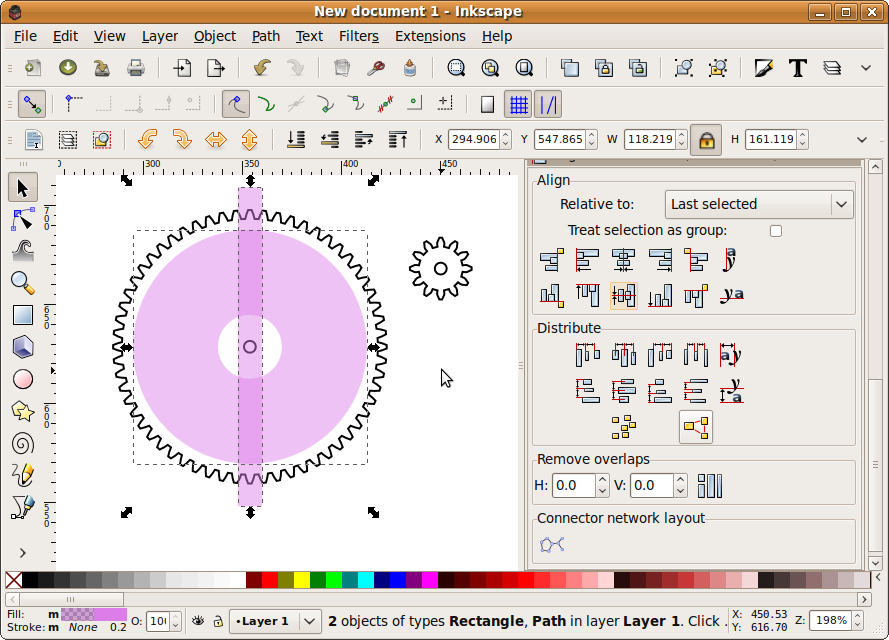

Tutorial 01. Make some gears using Gcode tools and Gear extension.
1. First of all let's draw some gears using Gear extension
Fill in parameters. Note that gear radius depends on Number of teeth and Circular pitch. So if you want your gearbox be 1:5 you should fill in Numbers of teeth 1:5 (12 and 60 for example) other parameters live the same for both gears.
Notice that gears are Group Objects so Ungroup them (Ctrl+Shift+G).
gcode_tools_gear_tutorial_0001.png (131938 просмотров) <a class='original' href='./download/file.php?id=278&mode=view' target=_blank>Загрузить оригинал (118.56 КБ)</a>
2. Making holes for the roller
Draw the circle with following dimensions 6x6 px.
Attention When Inkscape calculates dimensions it includes stroke width in width and height. So if you want to define exact values remove stroke paint and define values in numerical fields. You can change fill color to see your object.
Make a copy of circle (We have tow gears we need two circles).
Select gear and the circle. Make alignments so circle will be at the center of the gear. (Ctrl+Shift+A -> Center objects horizontally and Center objects vertically).

3. Let's make some additional holes to make big gear lighter
Draw two circles. And align them to the center of the gear. Make Path->Difference (Ctrl+"-").
Note when you make difference the topmost path subtracts from bottommost. You can use Page Up / Page Down / Home / End to move the path to the top or to the bottom.
gcode_tools_gear_tutorial_0004.png (131938 просмотров) <a class='original' href='./download/file.php?id=281&mode=view' target=_blank>Загрузить оригинал (143.7 КБ)</a>
gcode_tools_gear_tutorial_0005.png (131938 просмотров) <a class='original' href='./download/file.php?id=282&mode=view' target=_blank>Загрузить оригинал (143.5 КБ)</a>
Draw a rectangle, align it to the center of the gear. Make a copy of it (Ctrl+D) or just press Space bar when you will rotate/move/scale it. Rotate the copy, press Ctrl while rotating to rotate on exact 90 degrees.
gcode_tools_gear_tutorial_0006.png (131938 просмотров) <a class='original' href='./download/file.php?id=283&mode=view' target=_blank>Загрузить оригинал (145.05 КБ)</a>
Make a Path->Union (Ctrl+"+") of the rectangles.
gcode_tools_gear_tutorial_0007.png (131938 просмотров) <a class='original' href='./download/file.php?id=284&mode=view' target=_blank>Загрузить оригинал (144.18 КБ)</a>
Subtract the union from circles.
gcode_tools_gear_tutorial_0008.png (131938 просмотров) <a class='original' href='./download/file.php?id=285&mode=view' target=_blank>Загрузить оригинал (139.55 КБ)</a>
And finally subtract holes from the gear.
