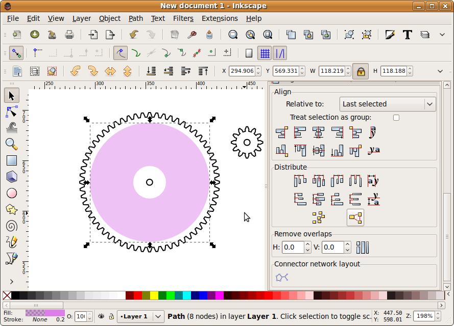

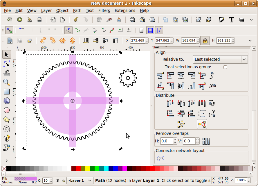

Tutorial 01. Make some gears using Gcode tools and Gear extension.
1. First of all let's draw some gears using Gear extension
Fill in parameters. Note that gear radius depends on Number of teeth and Circular pitch. So if you want your gearbox be 1:5 you should fill in Numbers of teeth 1:5 (12 and 60 for example) other parameters live the same for both gears.
Notice that gears are Group Objects so Ungroup them (Ctrl+Shift+G).
gcode_tools_gear_tutorial_0001.png (130494 просмотра) <a class='original' href='./download/file.php?id=278&sid=2775a0b0279bb3060bf89de0de226c5e&mode=view' target=_blank>Загрузить оригинал (118.56 КБ)</a>
2. Making holes for the roller
Draw the circle with following dimensions 6x6 px.
Attention When Inkscape calculates dimensions it includes stroke width in width and height. So if you want to define exact values remove stroke paint and define values in numerical fields. You can change fill color to see your object.
Make a copy of circle (We have tow gears we need two circles).
Select gear and the circle. Make alignments so circle will be at the center of the gear. (Ctrl+Shift+A -> Center objects horizontally and Center objects vertically).

3. Let's make some additional holes to make big gear lighter
Draw two circles. And align them to the center of the gear. Make Path->Difference (Ctrl+"-").
Note when you make difference the topmost path subtracts from bottommost. You can use Page Up / Page Down / Home / End to move the path to the top or to the bottom.
gcode_tools_gear_tutorial_0004.png (130494 просмотра) <a class='original' href='./download/file.php?id=281&sid=2775a0b0279bb3060bf89de0de226c5e&mode=view' target=_blank>Загрузить оригинал (143.7 КБ)</a>
gcode_tools_gear_tutorial_0005.png (130494 просмотра) <a class='original' href='./download/file.php?id=282&sid=2775a0b0279bb3060bf89de0de226c5e&mode=view' target=_blank>Загрузить оригинал (143.5 КБ)</a>
Draw a rectangle, align it to the center of the gear. Make a copy of it (Ctrl+D) or just press Space bar when you will rotate/move/scale it. Rotate the copy, press Ctrl while rotating to rotate on exact 90 degrees.
gcode_tools_gear_tutorial_0006.png (130494 просмотра) <a class='original' href='./download/file.php?id=283&sid=2775a0b0279bb3060bf89de0de226c5e&mode=view' target=_blank>Загрузить оригинал (145.05 КБ)</a>
Make a Path->Union (Ctrl+"+") of the rectangles.
gcode_tools_gear_tutorial_0007.png (130494 просмотра) <a class='original' href='./download/file.php?id=284&sid=2775a0b0279bb3060bf89de0de226c5e&mode=view' target=_blank>Загрузить оригинал (144.18 КБ)</a>
Subtract the union from circles.
gcode_tools_gear_tutorial_0008.png (130494 просмотра) <a class='original' href='./download/file.php?id=285&sid=2775a0b0279bb3060bf89de0de226c5e&mode=view' target=_blank>Загрузить оригинал (139.55 КБ)</a>
And finally subtract holes from the gear.

One of the interesting things I've found out about inkscape and this plugin is the units. The author recommends to draw in px and then select the units in the G-Code Plugin. I prefer to view my drawing in inches since that is what my machine is configured for. What I do is just put a scaling factor of 1/90 for each of the x and y axis. To set this up I followed the instructions from the website http://www.freesoftwaremagazine.com/boo ... s/inkscape
I then set up the grid (see figure 3). First, I selected File->Document Properties, and set the paper size to US letter and all of the units to “inches”. I then went to the “Grid” tab; started a new “rectangular” grid; and specified minor spacings of 0.05” with major grid lines for every 20 minor lines (which puts the major grid lines on 1” intervals). I then set the colors to something visible enough. Finally, I went to the “Snap” tab; enabled snapping to the grid; and set the sensitivity to the maximum (50 pixels).
About inches:
There are a lot of thin places, for example EMC2 raises an error if arc radius is smaller than .02 mm, but for inches this value is different. I can implement units conversion but we have to describe all thin places first to prevent future bugs.
As for now you can use scaling that provided by the plug-in to convert any units to pixels. And if you'll do it could you write your experience. That will show us a lot of things that have to be done to implement native unit cinversion.
