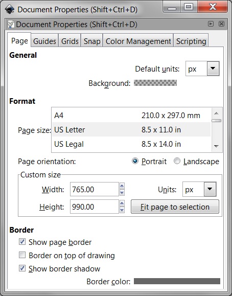

tony
Сообщения: 2
Зарегистрирован: 10 мар 2010, 06:00
Re: Inkscape Gcode tools plug-in English support forum
Сообщение tony »
I believe the details for Inkscape units are located in the file c:\Program Files\Inkscape\share\ui\units.txt
# Simple unit configuration file
# This is a space-delimited list of unit definitions.
# name name_plural abbr type factor PRI description
% % % DIMENSIONLESS 1.00 Y Percentage
pixel pixels px LINEAR 1.00 Y CSS Pixels (90/inch)
point points pt LINEAR 1.25 N PostScript points (72/inch)
pica picas pc LINEAR 15.0 N 12 points
inch inches in LINEAR 90.0 N Inches (90 px/in)
millimeter millimeters mm LINEAR 3.543307 N Millimeters (25.4 mm/in)
centimeter centimeters cm LINEAR 35.43307 N Centimeters (10 mm/cm)
meter meters m LINEAR 3543.307 N Meters (100 cm/m)
foot feet ft LINEAR 1080 N Feet (12 in/ft)
degree degrees deg RADIAL 1.00 Y Degrees
radian radians rad RADIAL 57.296 N Radians (57.296 deg/rad)
font-height font-heights em FONT_HEIGHT 1.00 Y Font height
x-height x-heights ex FONT_HEIGHT 0.50 N Height of letter 'x'
half-em half-ems en FONT_HEIGHT 0.50 N Half of font height
From what I can tell the native units are Pixels which is the unit stored in the XML file regardless of which unit you display on the screen. You can change which units you are using with File-> Document Properties. If you use inches then the scaling is 1/90 or 0.11111. If you use mm then the scaling is 1/3.543307 or 0.282222. This may result is some rounding error and might not be appropriate for all cases but it worked well for me. I'm also no sure how your tool accounts for the tool width so this could be another source of error but it could be easily eliminated if your code works with the users unit preferences and implemented the scaling.
The screen shots below with the width and height info from Inkscape would support my information above.

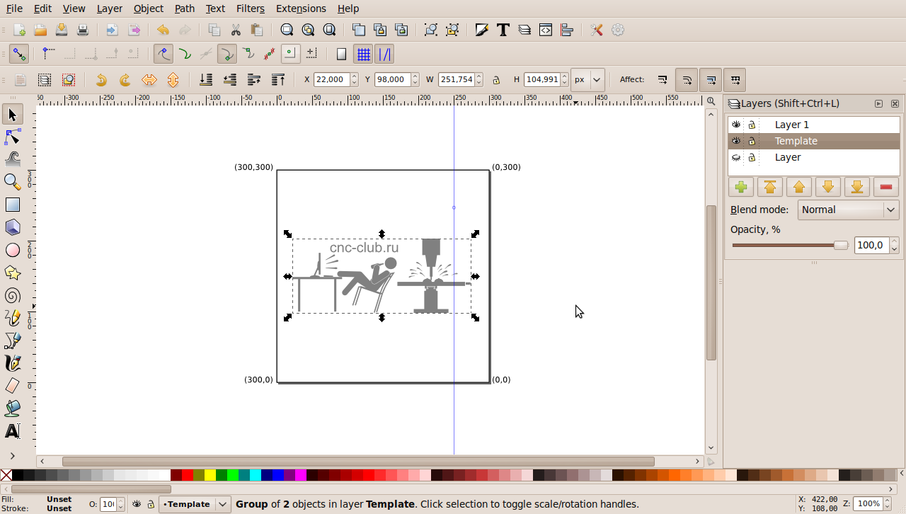

Gcode tools ver. 1.2 Area processing tutorial
At this tutorial I'll explain how to make area cutting G-code of the path using Gcode tools and Inkscape.
1. First of all we will need a path. You can draw it by yourself, or download from the internet.
I've chosen cnc-club logo. If you want you can get it here:
logo_0002.svg
(19.08 КБ) 3769 скачиваний
gcode tools area processing 0001.png (50339 просмотров) <a class='original' href='./download/file.php?id=351&mode=view' target=_blank>Загрузить оригинал (125.73 КБ)</a>
2. If your drawing consists not only from paths you should convert it to paths. (It may not contain some groups, ellipsis, texts, rectangles etc.). To do this select your drawing, check the status bar, if it says that selection contains Groups do Object - >Ungroup (Ctrl+Shift+G). If it contains text, or other geometry except paths do Path -> Object to path (Shift+Ctrl+C). Repeat this until status bar will say something like "5 objects of type Path in Layer...". Notice that when you convert Text to path it will create a Group with letters, so you will need to ungroup them.
3. Unite all paths into one path (Ctrl+"+").
4. I want cnc-club logo to offset from the surface so I'll need to cut the area outside the logo. Draw a rectangle, put it behind of your path (End or Page Down) and make it align to the center of the path (select path and Rectangle Ctrl+Shift+A and choose Center objects vertically and Center objects horizontally).
gcode tools area processing 0002.png (50339 просмотров) <a class='original' href='./download/file.php?id=352&mode=view' target=_blank>Загрузить оригинал (145.54 КБ)</a>
5. Subtract path from rectangle (Ctrl+"-").
gcode tools area processing 0003.png (50339 просмотров) <a class='original' href='./download/file.php?id=353&mode=view' target=_blank>Загрузить оригинал (145.65 КБ)</a>

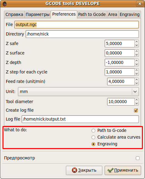

6. Now we have a path of which area we want to cut.
Next we need to calculate paths that will cover the area (these paths will be the cutter's trajectory).
Go to Extensions -> Gcode tools ...
Fill in Tool diameter in the Preferences tab
Then go to Area tab, and fill in Area radius. What is Area radius or how can it been calculated?
First of all Area radius must be in px (pixels) no mater which units you have been selected!
There some ways to calculate Area radius:
  • The easies way is: find the thickest part of the path and measure it by eye (Joke)
  • The second easies way is: find the thickest part of the path and measure it with Bizier tool. When you draw a path with the Bizier tool status bar shows it last segment length.
  • The hardest way is: convert path to dynamic offset (Ctlr+J), then press F2 and move the control point to make your path disappear. Then press Ctrl+Shif+X to open XML editor and find there inkscape:radius parameter, it's value is the exact value that you'll need
So anyway fill in Area radius.
Choose Calculate Area curves at the bottom and press Apply.

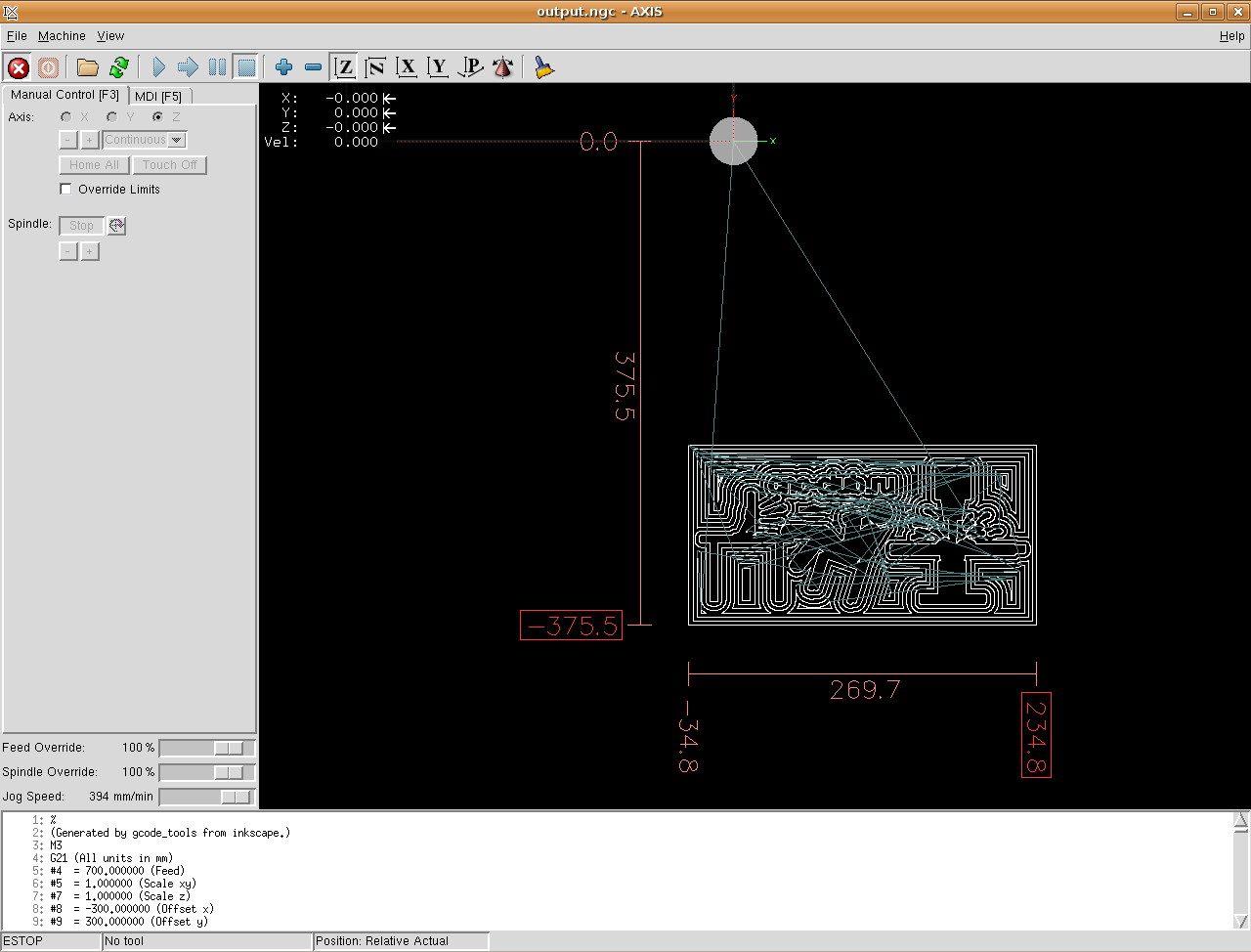

8. All is ready to convert paths to Gcode. Select the paths that we've got, do Extensions -> Gcode tools... Go to Preferences tab fill in cutter parameters, directory and filename for in which you want Gcode to be exported. Then go to Path to Gcode tab, fill in tolerance and maximum subdivision parameters. (Notice number of subdivisions means means number of iterative subdivisions not number of segvenst that you'll get from one segment. So you cat get up to 2^n segment from one segment.)
Choose Path to Gcode at the bottom. Press apply.
gcode tools area processing 0006.png (50339 просмотров) <a class='original' href='./download/file.php?id=356&mode=view' target=_blank>Загрузить оригинал (255.34 КБ)</a>
What you'll get: a group will be added to the drawing which shows cutter's working trajectory, and of cause a file in specified directory which will contain Gcode.
Let's check the results:
gcode tools area processing 0007.png (50339 просмотров) <a class='original' href='./download/file.php?id=357&mode=view' target=_blank>Загрузить оригинал (44.56 КБ)</a>
Everything is nice except that I missed the working area of my cutter :) but do not worry if you have not chosen "Generate not parametric code" it is very easy to correct the situation. Just correct first lines in the Gcode file:
#4  = 4.000000 (Feed)
#5  = 0.900000 (Scale xy)
#7  = 1.000000 (Scale z)
#8  = 0.000000 (Offset x)
#9  = 0.000000 (Offset y)
#10 = 0.000000 (Offset z)
#11 = 5.000000 (Safe distanse)
And situation solved :).

Also I'm thinking of removing this radio buttons and use active tab instead of it. So if you want to make Path to Gcode you should open Path to Gcode tab and press apply, if you wand Area function open Area tab and press apply. What do you think about it?
gcode_interface_0025.png (50336 просмотров) <a class='original' href='./download/file.php?id=370&mode=view' target=_blank>Загрузить оригинал (54.93 КБ)</a>

    Снимок-GCODE tools DEVELOPE.png (50276 просмотров) <a class='original' href='./download/file.php?id=399&mode=view' target=_blank>Загрузить оригинал (70.99 КБ)</a>
  2. After you press apply a new group containing three orientation points will be added to the active layer.
    Arrows point to control point position. You can put the points wherever you want. Just be sure that they do not lay on one straight line. Also you cat modify their desired values by modifying the text near each arrow with the text tool. (Be sure to remain text's format " ( value ; value )" spaces are not taken into account.)
    You can move, rotate, scale, skew, etc. this points.
    Attention do not ungroup arrow from the text! You can ungroup points from each other but not further!
    Снимок-New document 1 - Inkscape.png (50276 просмотров) <a class='original' href='./download/file.php?id=400&mode=view' target=_blank>Загрузить оригинал (170.15 КБ)</a>
  3. Now you can apply any other functions. All exported will be in new coordinate system defined by these points. You will not see any changes in the preview, but the will be in generated Gcode. (If you apply different scale to X and Y axis preview of arcs will be ruined (their ending points wont be on correct places) but we thin this case is really rare and this will be a todo for a while.)
  4. You can add more than one set of orientation control points, but if you want them to make any effect you need to put them to different layers. Gcode tools firs searches in the active layer for orientation points and then searches in whole painting.

On emc I have this:
screen_capture10.jpg (50270 просмотров) <a class='original' href='./download/file.php?id=407&mode=view' target=_blank>Загрузить оригинал (29.61 КБ)</a>
and Z view that show the errors , some point are very very on the bottom of Z axis.
I have try with many others tune of gcode tools but always this bad points.

I've used these parameters to generate Engraving trajectory:
Вложение Снимок-GCODE tools DEVELOPE.png больше недоступно

If i join a and s like you tell me ! Engraving do outside engraving for as but i want inside engraving..and do inside engraving for others letters ?
How tell to engraving function to do outside or inside engraving ???
I have set 3 times more node ! to have better resolution.
And have set sample to 10...
Cutter shape w*2 to have more z depth and same of my cone router.
error_outside_inside.png (50225 просмотров) <a class='original' href='./download/file.php?id=418&mode=view' target=_blank>Загрузить оригинал (201.83 КБ)</a>
And if open gcode in emc ! It show always many errors with Z depth
I have made red circle around some error z depth on the emc screen output.
error_z_depth.jpg (50225 просмотров) <a class='original' href='./download/file.php?id=419&mode=view' target=_blank>Загрузить оригинал (18.77 КБ)</a>
