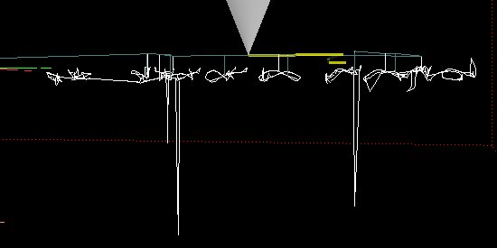

Preview of the generated Gcode in EMC (1474362 просмотра) <a class='original' href='./download/file.php?id=130&mode=view' target=_blank>Загрузить оригинал (154.76 КБ)</a>

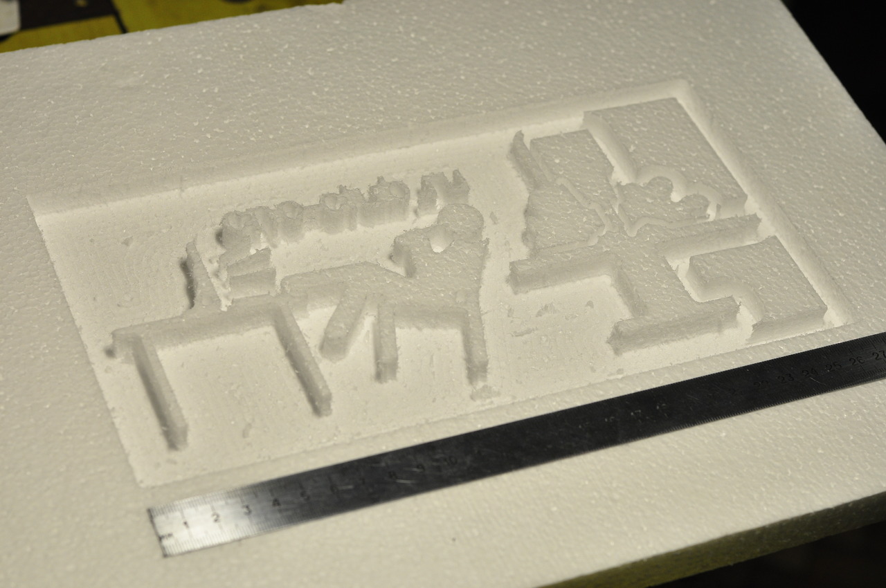

Gcodetools area pocketing (1460465 просмотров) <a class='original' href='./download/file.php?id=772&mode=view' target=_blank>Загрузить оригинал (147.75 КБ)</a>

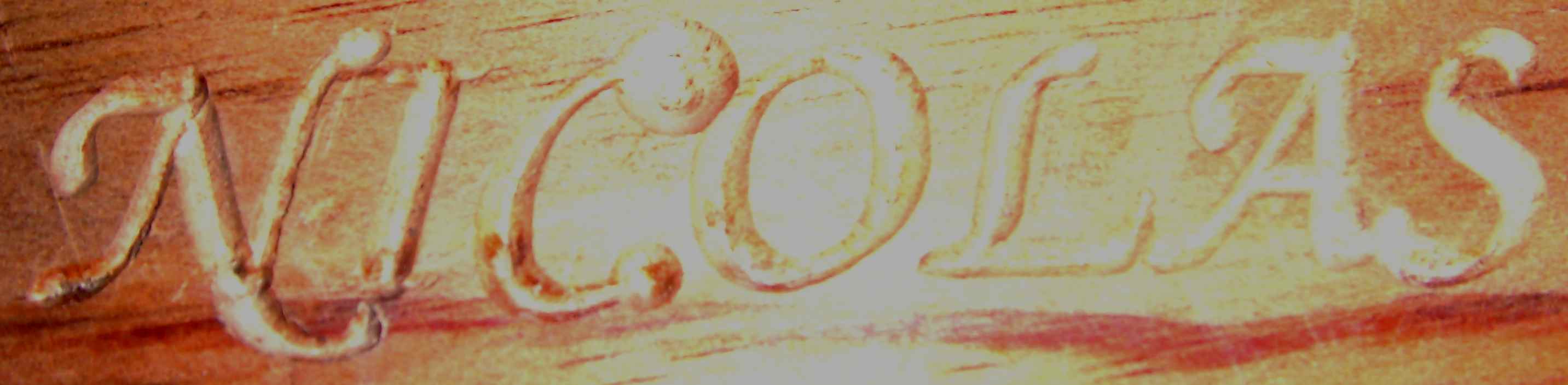

Gcodetools engraving by Rene (1466951 просмотр) <a class='original' href='./download/file.php?id=631&mode=view' target=_blank>Загрузить оригинал (233.84 КБ)</a>

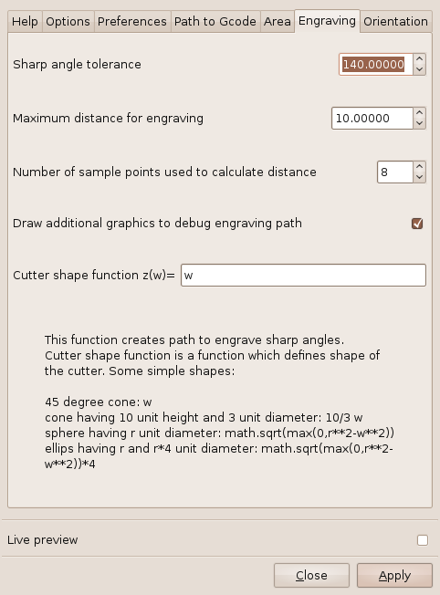

Engraving
  • Building trajectory according to the cutter's shape
  • Defining different cutter's shapes

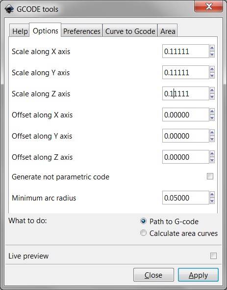

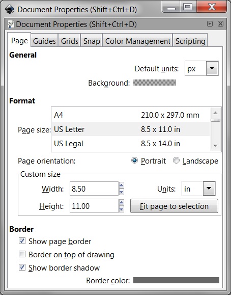

I believe the details for Inkscape units are located in the file c:\Program Files\Inkscape\share\ui\units.txt
# Simple unit configuration file
# This is a space-delimited list of unit definitions.
# name name_plural abbr type factor PRI description
% % % DIMENSIONLESS 1.00 Y Percentage
pixel pixels px LINEAR 1.00 Y CSS Pixels (90/inch)
point points pt LINEAR 1.25 N PostScript points (72/inch)
pica picas pc LINEAR 15.0 N 12 points
inch inches in LINEAR 90.0 N Inches (90 px/in)
millimeter millimeters mm LINEAR 3.543307 N Millimeters (25.4 mm/in)
centimeter centimeters cm LINEAR 35.43307 N Centimeters (10 mm/cm)
meter meters m LINEAR 3543.307 N Meters (100 cm/m)
foot feet ft LINEAR 1080 N Feet (12 in/ft)
degree degrees deg RADIAL 1.00 Y Degrees
radian radians rad RADIAL 57.296 N Radians (57.296 deg/rad)
font-height font-heights em FONT_HEIGHT 1.00 Y Font height
x-height x-heights ex FONT_HEIGHT 0.50 N Height of letter 'x'
half-em half-ems en FONT_HEIGHT 0.50 N Half of font height
From what I can tell the native units are Pixels which is the unit stored in the XML file regardless of which unit you display on the screen. You can change which units you are using with File-> Document Properties. If you use inches then the scaling is 1/90 or 0.11111. If you use mm then the scaling is 1/3.543307 or 0.282222. This may result is some rounding error and might not be appropriate for all cases but it worked well for me. I'm also no sure how your tool accounts for the tool width so this could be another source of error but it could be easily eliminated if your code works with the users unit preferences and implemented the scaling.
The screen shots below with the width and height info from Inkscape would support my information above.
Settings in px (51647 просмотров) <a class='original' href='./download/file.php?id=309&mode=view' target=_blank>Загрузить оригинал (84.08 КБ)</a>
Settings in px
Setting in inches (51647 просмотров) <a class='original' href='./download/file.php?id=307&mode=view' target=_blank>Загрузить оригинал (83.49 КБ)</a>
Setting in inches
Settings in mm (51647 просмотров) <a class='original' href='./download/file.php?id=308&mode=view' target=_blank>Загрузить оригинал (85.25 КБ)</a>
Settings in mm
GCode Plugin Scaling for inches (51647 просмотров) <a class='original' href='./download/file.php?id=310&mode=view' target=_blank>Загрузить оригинал (70.99 КБ)</a>

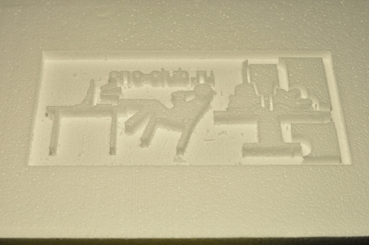

Re: Inkscape Gcode tools plug-in English support forum
Gcode tools ver. 1.2 Area processing tutorial
At this tutorial I'll explain how to make area cutting G-code of the path using Gcode tools and Inkscape.
1. First of all we will need a path. You can draw it by yourself, or download from the internet.
I've chosen cnc-club logo. If you want you can get it here:
logo_0002.svg
(19.08 КБ) 3799 скачиваний
gcode tools area processing 0001.png (51618 просмотров) <a class='original' href='./download/file.php?id=351&mode=view' target=_blank>Загрузить оригинал (125.73 КБ)</a>
2. If your drawing consists not only from paths you should convert it to paths. (It may not contain some groups, ellipsis, texts, rectangles etc.). To do this select your drawing, check the status bar, if it says that selection contains Groups do Object - >Ungroup (Ctrl+Shift+G). If it contains text, or other geometry except paths do Path -> Object to path (Shift+Ctrl+C). Repeat this until status bar will say something like "5 objects of type Path in Layer...". Notice that when you convert Text to path it will create a Group with letters, so you will need to ungroup them.
3. Unite all paths into one path (Ctrl+"+").
4. I want cnc-club logo to offset from the surface so I'll need to cut the area outside the logo. Draw a rectangle, put it behind of your path (End or Page Down) and make it align to the center of the path (select path and Rectangle Ctrl+Shift+A and choose Center objects vertically and Center objects horizontally).
gcode tools area processing 0002.png (51618 просмотров) <a class='original' href='./download/file.php?id=352&mode=view' target=_blank>Загрузить оригинал (145.54 КБ)</a>
5. Subtract path from rectangle (Ctrl+"-").
gcode tools area processing 0003.png (51618 просмотров) <a class='original' href='./download/file.php?id=353&mode=view' target=_blank>Загрузить оригинал (145.65 КБ)</a>
6. Now we have a path of which area we want to cut.
Next we need to calculate paths that will cover the area (these paths will be the cutter's trajectory).
Go to Extensions -> Gcode tools ...
Fill in Tool diameter in the Preferences tab
Then go to Area tab, and fill in Area radius. What is Area radius or how can it been calculated?
First of all Area radius must be in px (pixels) no mater which units you have been selected!
There some ways to calculate Area radius:
  • The easies way is: find the thickest part of the path and measure it by eye (Joke)
  • The second easies way is: find the thickest part of the path and measure it with Bizier tool. When you draw a path with the Bizier tool status bar shows it last segment length.
  • The hardest way is: convert path to dynamic offset (Ctlr+J), then press F2 and move the control point to make your path disappear. Then press Ctrl+Shif+X to open XML editor and find there inkscape:radius parameter, it's value is the exact value that you'll need
So anyway fill in Area radius.
Choose Calculate Area curves at the bottom and press Apply.
gcode tools area processing 0004.png (51618 просмотров) <a class='original' href='./download/file.php?id=354&mode=view' target=_blank>Загрузить оригинал (218.16 КБ)</a>
Sometimes it's better to convert path to dynamic offset before doing Calculate Area curves.
gcode tools area processing 0005.png (51618 просмотров) <a class='original' href='./download/file.php?id=355&mode=view' target=_blank>Загрузить оригинал (232.87 КБ)</a>
7. After applying Calculate area curves you should have a new group containing paths that cover the area of the source path. But unfortunately this paths cat contain some errors.
To correct the errors go into the group (double click on the group), select all objects (Ctrl+A) convert them to Paths (shift+Ctrl+C). Brake paths apart (Ctrl+Shift+K) to delete some unnecessary paths and correct others.
8. All is ready to convert paths to Gcode. Select the paths that we've got, do Extensions -> Gcode tools... Go to Preferences tab fill in cutter parameters, directory and filename for in which you want Gcode to be exported. Then go to Path to Gcode tab, fill in tolerance and maximum subdivision parameters. (Notice number of subdivisions means means number of iterative subdivisions not number of segvenst that you'll get from one segment. So you cat get up to 2^n segment from one segment.)
Choose Path to Gcode at the bottom. Press apply.
gcode tools area processing 0006.png (51618 просмотров) <a class='original' href='./download/file.php?id=356&mode=view' target=_blank>Загрузить оригинал (255.34 КБ)</a>
What you'll get: a group will be added to the drawing which shows cutter's working trajectory, and of cause a file in specified directory which will contain Gcode.
Let's check the results:
gcode tools area processing 0007.png (51618 просмотров) <a class='original' href='./download/file.php?id=357&mode=view' target=_blank>Загрузить оригинал (44.56 КБ)</a>
Everything is nice except that I missed the working area of my cutter :) but do not worry if you have not chosen "Generate not parametric code" it is very easy to correct the situation. Just correct first lines in the Gcode file:

gcode tools area processing 0008.png (51618 просмотров) <a class='original' href='./download/file.php?id=358&mode=view' target=_blank>Загрузить оригинал (49.32 КБ)</a>
gcode tools area processing 0010.png (51618 просмотров) <a class='original' href='./download/file.php?id=359&mode=view' target=_blank>Загрузить оригинал (60.65 КБ)</a>
Here are the results of cutting this Gcode on my hobby router:
Unfortunately it was the first run of my router and almost at the end of cutting one coupling broke down, so this cutting is unfinished :(.
Material is foam (it was the first run :) ).
Cutting time with maximum cutting speed 7mm per second is about 18 minutes. Dimensions are about 270x140mm, tool diameter 3.2mm.
gcode tools area processing 0011.jpg (51618 просмотров) <a class='original' href='./download/file.php?id=360&mode=view' target=_blank>Загрузить оригинал (256.47 КБ)</a>
gcode tools area processing 0012.jpg (51618 просмотров) <a class='original' href='./download/file.php?id=361&mode=view' target=_blank>Загрузить оригинал (244.31 КБ)</a>

A small Engraving howto
1. Select one or more paths. (Make sure that they are all paths and not text's, circles, etc.)
2. Extensions -> Gcode tools develope ...
3. Fill in tool diameter (Cone maximum diameter), directory and filename
4. Go to the Engraving tab and fill some parameters:
  • Sharp angle tolerance - corners thinner than this will be thought as sharp ones. If corner is sharp, cutting trajectory will touch the corner. Notice this value is in degrees (one full turn is 360 degrees).
  • Maximum distance for engraving - If offset of the trajectory's segment exceeds Maximum distance for engraving then this segment wont be used for cutting. This value should be equal to the diameter of cylindrical cutter (that is used to cut inner area) or should be big if you want to cut whole path with cone cutter.
  • Number of sample points used to calculate distance - this parameter defines number of sample points used for offset calculations. Calculation time is in direct ratio of this parameter, I think i should be between 4 and 10.
  • Draw additional graphics to debug engraving path - If this is set Gcode tools will draw normals, offset points, and offset circles that could help to find errors, or help find a way to change the path to eliminate errors.
  • Cutter shape function z(w)= - This function defines cutters form. Here are some common examples:
    • w - cone with height = width
    • t*w[/] (0.5*w) - t- tangents of cones angle t = d/(2*h) = r/h (cone's radius to cone's height)
    • math.sqrt(max(0,r**2-w**2)) ( math.sqrt(max(25-w**2)) ) - sphere cutter.
5. Press apply.
Note calculation time depends on square number of path's control points. So if you'll use this function on path that have 200 control points or more it could take while to do all the job. If paths do not intersect, it's better to break them apart. Dormouse said that when he tried to compute 2000 points path it took about 15 minutes to do the calculations.

On emc I have this:
screen_capture10.jpg (51549 просмотров) <a class='original' href='./download/file.php?id=407&mode=view' target=_blank>Загрузить оригинал (29.61 КБ)</a>
and Z view that show the errors , some point are very very on the bottom of Z axis.
I have try with many others tune of gcode tools but always this bad points.

I've correct some points that show me to be very very bad in the gcode and engrave it in my router with two different cone cuter shape.
And the result is very nice.
I like it.
Else if some z coordinate are bad and make some big circular cone hole. But it's a very very good start for this engraving funtion.
result:
SNV30126.JPG (51549 просмотров) <a class='original' href='./download/file.php?id=410&mode=view' target=_blank>Загрузить оригинал (146.27 КБ)</a>
same but big zoom and different angle:
SNV30127.JPG (51549 просмотров) <a class='original' href='./download/file.php?id=411&mode=view' target=_blank>Загрузить оригинал (125.25 КБ)</a>
last one better engraving but problem wiht photo luminosity sorry.
SNV30128.JPG (51549 просмотров) <a class='original' href='./download/file.php?id=412&mode=view' target=_blank>Загрузить оригинал (69.87 КБ)</a>

45 degree cone: w
cone having 10 unit height and 3 unit diameter: 10/3 w
sphere having r unit diameter: math.sqrt(max(0,r**2-w**2))
ellips having r and r*4 unit diameter: math.sqrt(max(0,r**2-w**2))*4

root писал(а):Hi Alfcnc!
Thank you for the good words! :)
Now to the case:
First of all I want give some tips about working with engraving
  • You do not have to subtract your path from anything.
    Just make sure that it is a Path. (Ctrl+Shift+C to Oject to Path and Ctrl+Shift+G to ungroup)
    If Engraving's trajectory is outside of the Path you can do Path->Reverse to fix it.
  • Try to avoid combining Paths that do not intersect.
    Engraving calculate offset using all segments of the path and do this calculations n*n times where n is segments number of the path.
    So for the text it's better to convert it to path and combine only those letters that intersect. ("a" and "s" from your example)
  • If you increase number of sample point in the Engraving tab you can get better results.
  • Also some times it could be better to add some nodes to the Path by Extension->Modify Path->Add nodes, but it'll take more time for calculations.
I've broke apart your path and combined "a", "s" and "a"'s hole together. And using latest beta version of Gcode tools the plug-in got these results:

I've used these parameters to generate Engraving trajectory:

And if open gcode in emc ! It show always many errors with Z depth
I have made red circle around some error z depth on the emc screen output.
error_z_depth.jpg (51504 просмотра) <a class='original' href='./download/file.php?id=419&mode=view' target=_blank>Загрузить оригинал (18.77 КБ)</a>
