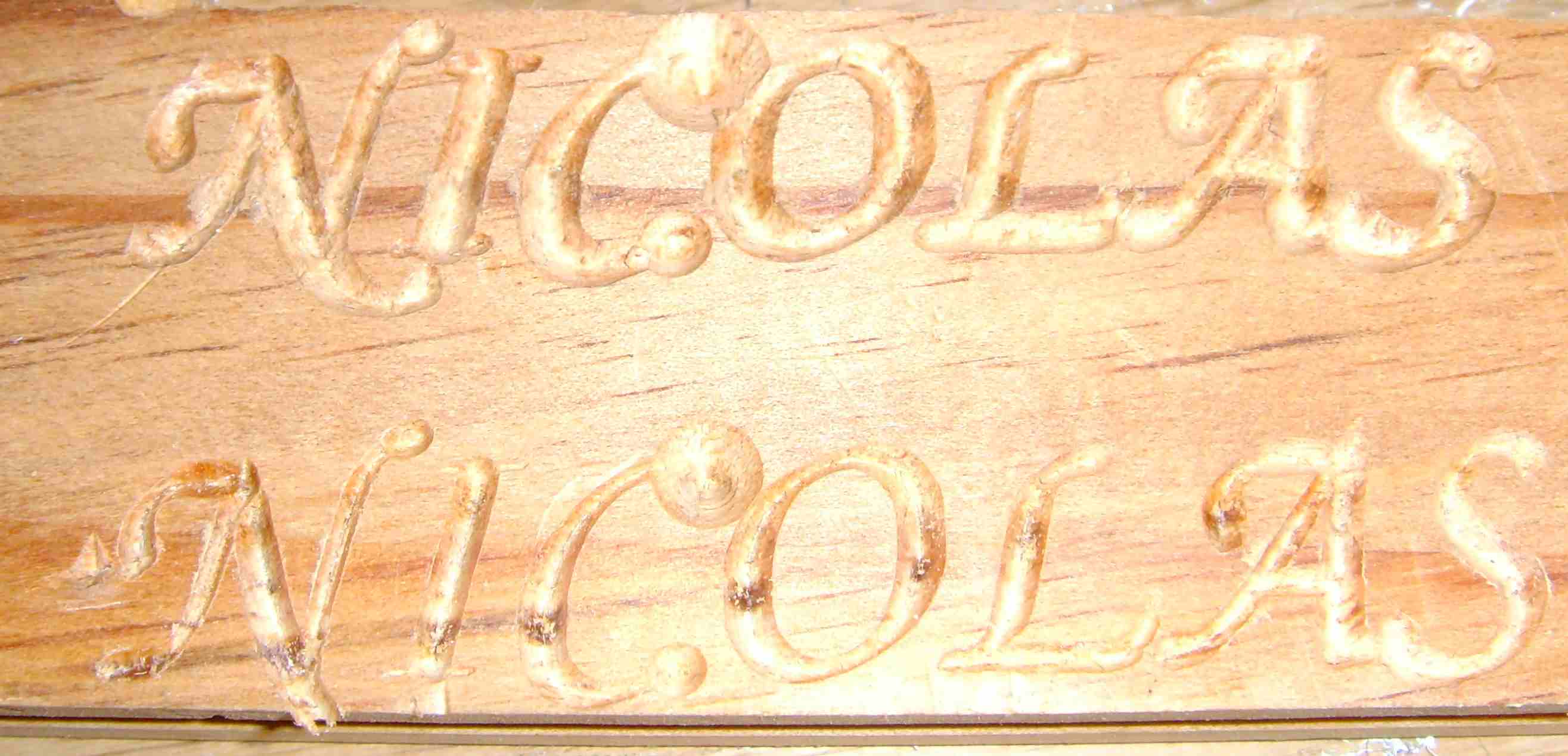

Gcodetools engraving by Rene (1466926 просмотров) <a class='original' href='./download/file.php?id=631&mode=view' target=_blank>Загрузить оригинал (233.84 КБ)</a>

I've correct some points that show me to be very very bad in the gcode and engrave it in my router with two different cone cuter shape.
And the result is very nice.
I like it.
Else if some z coordinate are bad and make some big circular cone hole. But it's a very very good start for this engraving funtion.
result:
SNV30126.JPG (51540 просмотров) <a class='original' href='./download/file.php?id=410&mode=view' target=_blank>Загрузить оригинал (146.27 КБ)</a>
same but big zoom and different angle:
SNV30127.JPG (51540 просмотров) <a class='original' href='./download/file.php?id=411&mode=view' target=_blank>Загрузить оригинал (125.25 КБ)</a>
last one better engraving but problem wiht photo luminosity sorry.
SNV30128.JPG (51540 просмотров) <a class='original' href='./download/file.php?id=412&mode=view' target=_blank>Загрузить оригинал (69.87 КБ)</a>
I wait with enthusiasm the new version whith debug of this. Congratulation for the good work.
