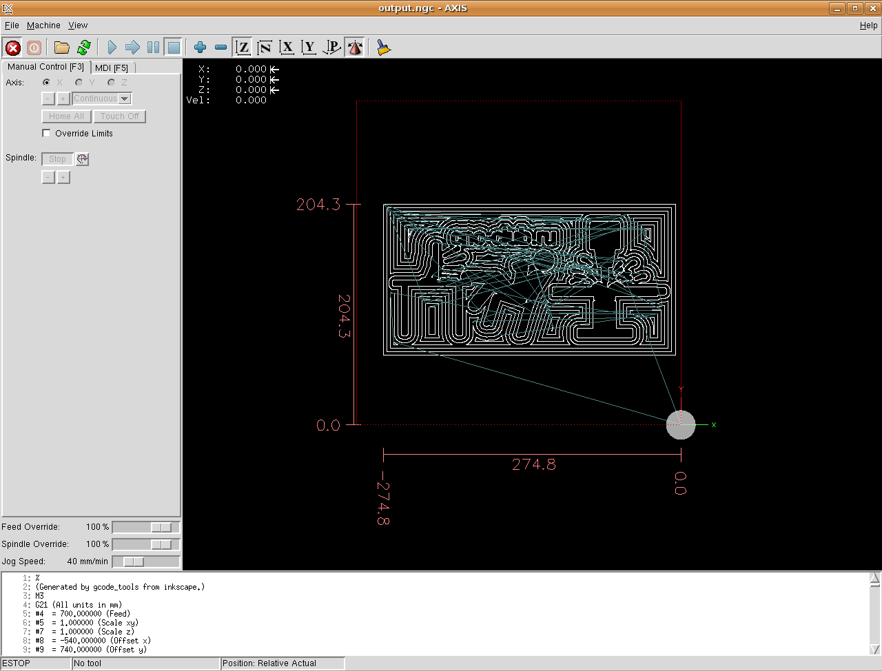

Generated Gcode in EMC2 (1471423 просмотра) <a class='original' href='./download/file.php?id=508&mode=view' target=_blank>Загрузить оригинал (21.99 КБ)</a>

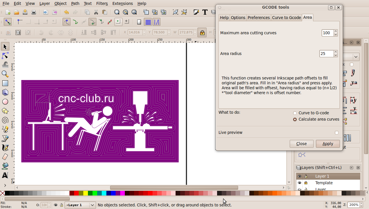

Gcodetools area pocketing (1460450 просмотров) <a class='original' href='./download/file.php?id=772&mode=view' target=_blank>Загрузить оригинал (147.75 КБ)</a>

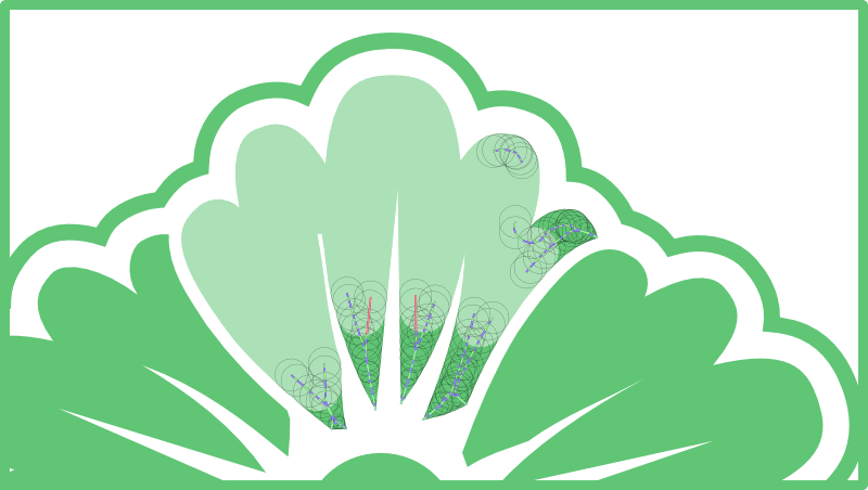

Gcodetools engraving by Rene (1466936 просмотров) <a class='original' href='./download/file.php?id=631&mode=view' target=_blank>Загрузить оригинал (233.84 КБ)</a>

Here are the results of cutting this Gcode on my hobby router:
Unfortunately it was the first run of my router and almost at the end of cutting one coupling broke down, so this cutting is unfinished :(.
Material is foam (it was the first run :) ).
Cutting time with maximum cutting speed 7mm per second is about 18 minutes. Dimensions are about 270x140mm, tool diameter 3.2mm.
gcode tools area processing 0011.jpg (51612 просмотров) <a class='original' href='./download/file.php?id=360&mode=view' target=_blank>Загрузить оригинал (256.47 КБ)</a>
gcode tools area processing 0012.jpg (51612 просмотров) <a class='original' href='./download/file.php?id=361&mode=view' target=_blank>Загрузить оригинал (244.31 КБ)</a>

Gcode tools 1.4 beta is ready
New features:
1. Engraving
This function calculates trajectory to cut thin places and sharp angles with the cone or sphere cutter.
For example if you want to engrave a flower, with 15mm cylindrical cutter you can cut only light green area, but not the thin places and sharp corners. Engraving function creates trajectory to cut that places with conical or other not straight cylindrical cutter. See attached image for more details.
gcode_engraving_0024.png (51609 просмотров) <a class='original' href='./download/file.php?id=369&mode=view' target=_blank>Загрузить оригинал (89.7 КБ)</a>
Almost all is ready, but there are still some question with the interface. It is understandable for me and Dormouse because we are developers ;), and now we need to make it more user friendly. Also we need corrections of our English :).
