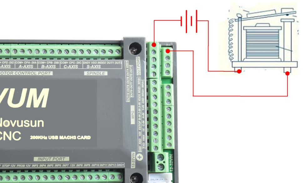

OUTX connect with external relay method???
