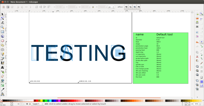

Hi.
First of all I'd like to congratulate everyone that helped creating this amazing piece of software. You're special! Thanks for the hard work!
I'm facing a strange behavior on certain situations when using the area tool. Although I tried many different options, I'm not able to identify or solve the problem.
Here's my step by step to reproduce it.
1 - Installed Gcodetools 1.7 from the .tar.gz download and copied the files to /usr/share/inkscape/extensions directory.
2 – Launched Inkscape and created Orientation Points (Extensions → Gcodetools → Orientation Points → 2-Points mode)
3 – Created a Default Tool (Extensions → Gcodetools → Tools Library → Default)
4 – Changed Default Tool Diameter from 10.0 to 0.25
5 – Inserted a Inkscape Text Object (F8)
6 – Converted Text Object to Path (Path → Object to Path)
7 – Generated a Fill Area (Extensions → Gcodetools → Area → Fill Area)
The generated Fill Area is not correct and it doesn't not follow the path shape, see the images below.
I wondering what I can do to solve the solve this problem.
My current setup is:
Ubuntu 13.04 32bit
Inkscape 0.48.4
Gcodetools 1.7
Thanks for helping.
15nogmx.png (6895 просмотров) <a class='original' href='./download/file.php?id=25218&sid=e9c4cfc97c14d752a04c2ad6c7b2d6df&mode=view' target=_blank>Загрузить оригинал (93.72 КБ)</a>
69htew.png (6895 просмотров) <a class='original' href='./download/file.php?id=25219&sid=e9c4cfc97c14d752a04c2ad6c7b2d6df&mode=view' target=_blank>Загрузить оригинал (91.74 КБ)</a>
adhqx2.png (6895 просмотров) <a class='original' href='./download/file.php?id=25220&sid=e9c4cfc97c14d752a04c2ad6c7b2d6df&mode=view' target=_blank>Загрузить оригинал (73.74 КБ)</a>
ne81hv.png (6895 просмотров) <a class='original' href='./download/file.php?id=25221&sid=e9c4cfc97c14d752a04c2ad6c7b2d6df&mode=view' target=_blank>Загрузить оригинал (75.84 КБ)</a>

Can you attach your svg please?
PS attach images to the forum directly.

Hi Nick. Thanks for the reply!
I'm on a different computer now. It uses Ubuntu 12.04 and Inkscape 0.48.3.1. The problem still showing on this setup.
The SVGs are attached. There's one just with the Text and other with the generated area fill.
Thanks

Re: Gcodetools - plug-in Inkscape для экспорта в Gcode
hmmm... it seem's like a kind of bug... thank you for the report, i'll test it later.
