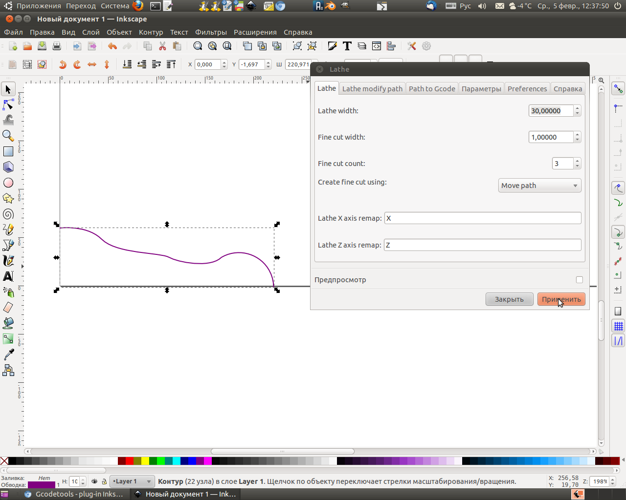

В кратце - рисуем контур. Ось вращения будет вдоль оси Х. (Обычно по умолчанию низ страницы).
Снимок-96.png (7085 просмотров) <a class='original' href='./download/file.php?id=24417&mode=view' target=_blank>Загрузить оригинал (137.24 КБ)</a>
Открываем Расширения - Gcodetools - Lathe
Снимок-97.png (7085 просмотров) <a class='original' href='./download/file.php?id=24416&mode=view' target=_blank>Загрузить оригинал (171.27 КБ)</a>
Выбираем свой контур и жмем ок.
Получаем что-то такое
Снимок-98.png (7085 просмотров) <a class='original' href='./download/file.php?id=24415&mode=view' target=_blank>Загрузить оригинал (234.5 КБ)</a>
И вот такой Gкод

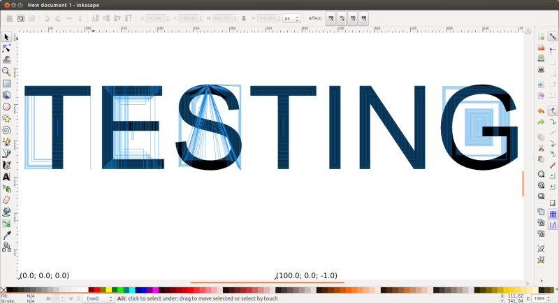

Hi.
First of all I'd like to congratulate everyone that helped creating this amazing piece of software. You're special! Thanks for the hard work!
I'm facing a strange behavior on certain situations when using the area tool. Although I tried many different options, I'm not able to identify or solve the problem.
Here's my step by step to reproduce it.

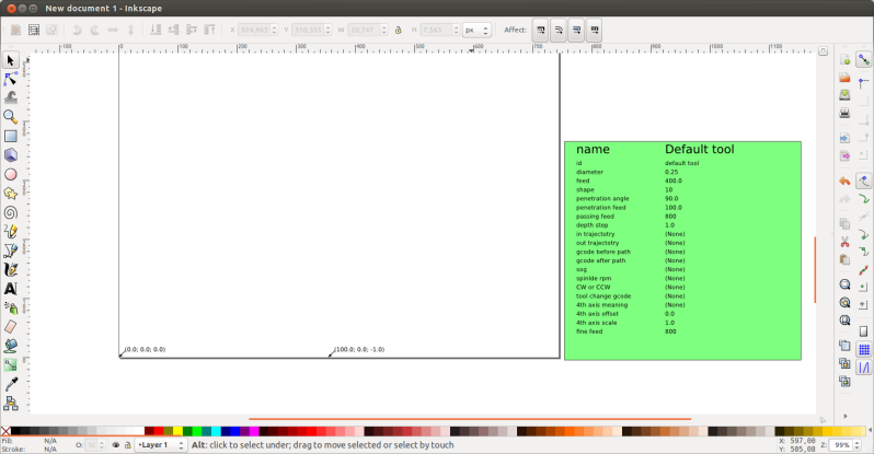

1 - Installed Gcodetools 1.7 from the .tar.gz download and copied the files to /usr/share/inkscape/extensions directory.
2 – Launched Inkscape and created Orientation Points (Extensions → Gcodetools → Orientation Points → 2-Points mode)
3 – Created a Default Tool (Extensions → Gcodetools → Tools Library → Default)
4 – Changed Default Tool Diameter from 10.0 to 0.25
5 – Inserted a Inkscape Text Object (F8)
6 – Converted Text Object to Path (Path → Object to Path)
7 – Generated a Fill Area (Extensions → Gcodetools → Area → Fill Area)
The generated Fill Area is not correct and it doesn't not follow the path shape, see the images below.
I wondering what I can do to solve the solve this problem.
My current setup is:
Ubuntu 13.04 32bit
Inkscape 0.48.4
Gcodetools 1.7
Thanks for helping.
15nogmx.png (6907 просмотров) <a class='original' href='./download/file.php?id=25218&mode=view' target=_blank>Загрузить оригинал (93.72 КБ)</a>
69htew.png (6907 просмотров) <a class='original' href='./download/file.php?id=25219&mode=view' target=_blank>Загрузить оригинал (91.74 КБ)</a>
adhqx2.png (6907 просмотров) <a class='original' href='./download/file.php?id=25220&mode=view' target=_blank>Загрузить оригинал (73.74 КБ)</a>
ne81hv.png (6907 просмотров) <a class='original' href='./download/file.php?id=25221&mode=view' target=_blank>Загрузить оригинал (75.84 КБ)</a>
Re: Gcodetools - plug-in Inkscape для экспорта в Gcode
Can you attach your svg please?
PS attach images to the forum directly.

I generated another Test File with several texts, although some letters are generated correctly, there's no single word that are completed clean.
I also noticed that, certain times, even If I choose ZigZag as the Fill Pattern, it come out as a Spiral.
Resulting Filling Pattern when selected &quot;ZigZag&quot; (6866 просмотров) <a class='original' href='./download/file.php?id=25267&mode=view' target=_blank>Загрузить оригинал (24.11 КБ)</a>
Resulting Filling Pattern when selected "ZigZag"
Let me know if I can help you with anything else.
Thanks a lot.
