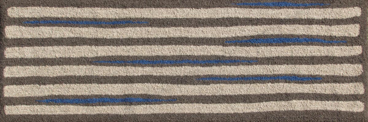

Thanks for you ever quick response. Your written English is much than Google's translations. I have hopefully correctly attached files that will help clarify my project. This is my first time dealing with an online forum so hopefully it works. It is also the first time I have coded for machine control in 30 years and then it was on a Commodore 64 with a cassette tape storage drive.
So I have experimented some in Inkscape and Gcodetools and made the sample files. There is a copy of the .svg without the tool and with. I used the default tool because it gives more options than just "tangent knife". "original.gnc" file is after running path-to-gcode.In the "modified.gnc" file I added code after the x,y moves to extend and retract an air cylinder, with the needle attached, using the coolant controls. The other change I made was moving the first knife plunge up a couple of lines so it happens before my added code and the "a" move. This change only happens once at the beginning of each path and could easily be changed by hand. I would like to use a TinyG controller which has a somewhat limited set of G and M codes so I need to cheat at times.
I have also attached a photo of one of my rugs not made with CNC so you have some idea basic designs I plan on using. The rug is about 32" x 84" and has an estimated 110,000 loops pushed in one at a time. I didn't keep track of time but it was probably 6 weeks of weekends and evenings. I need a robot slave.
Any help you can give is greatly appreciated.

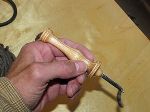

Yes the carpet is made by me. The tool is a punch needle referred to as an "Oxford Punch". No machine yet. You work on linen fabric stretched tightly on a frame. From the backside you push the needle in until it stops, about 40 mm, pull it out and repeat. It works out to about 8 to 10 stitches per inch and 5 or 6 rows per inch the other way.
I am not familiar with regular expressions but the internet can reveal all. Should I be referencing python or some other language?
Thanks for your interest and help, Badger
oxford punch.jpg (22947 просмотров) <a class='original' href='./download/file.php?id=10533&mode=view' target=_blank>Загрузить оригинал (81.45 КБ)</a>

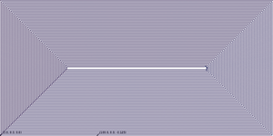

I would guess that the program will be considered huge. Each loop of yarn will happen at a node in inkscape so that will be 4 lines of gcode per loop. That probably works out to around 175,000 lines of code per square foot of rug. On the other hand I plan on breaking each project into at least 3 programs, one for light grey yarn, one for dark grey yarn, one for color yarn etc. Processing time for the program is not much of an issue to me. I can run the program overnight, or while at work as needed. I am not looking to set any speed records on productivity, just some speed increase over doing it all by hand and saving my wrist from too much stress.
This weekend I will make you a video of some of the process which may make it a little easier to understand, although you are doing a fantastic job of figuring things out for me. I know you a fluent in written English do you also speak English or should I add English text to video?
-Badger
Re: custom tool definition
175000 lines... that's a lot...
And how does inskcape work with this amount of nodes???
I speak English, so text is not needed, in fact it's usually easier to get the meaning from the voice, if you are not from Ireland, or somewhere there :).
badger
Сообщения: 38
Зарегистрирован: 30 дек 2012, 00:32
Репутация: 3
Сообщение badger »
I tried simple design based on 1800mm X 2400mm rug and Inskape successfully placed 221370 nodes. The was the last thing it did. I reduced size to 1000mm X 500mm which generated 25499 nodes which using postprocessor you wrote for me generated 218000 lines of gcode. Time to generate gcode was not more than maybe 3 minutes. This works for me! With reference points on drawing I think it should be easy to break up design on layers or areas and just run sections to gcode one at a time with no registration problems.
I think I have ancestors from Ireland but after a few hundred years we have lost the accent. We watch some BBC TV shows on Netflix and some of them set in the north part of the UK might as well be in a foreign to me because I can't understand much of that version of English.
Can you attach that svg, or probably make a screenshot (or export to png), if it has big size?
I can not imagine what it looks like :).

Сообщение badger »
Not really very interesting. It was the simplest way to generate a bunch of points to test the system for capacity. I really should actually do a "real" design at some point. Video soon to be on an internet near you.
test #186.png (22840 просмотров) <a class='original' href='./download/file.php?id=10582&mode=view' target=_blank>Загрузить оригинал (260.17 КБ)</a>
