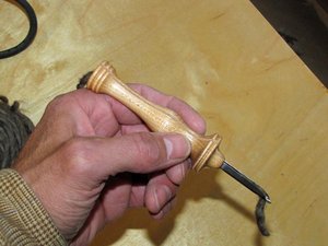

Yes the carpet is made by me. The tool is a punch needle referred to as an "Oxford Punch". No machine yet. You work on linen fabric stretched tightly on a frame. From the backside you push the needle in until it stops, about 40 mm, pull it out and repeat. It works out to about 8 to 10 stitches per inch and 5 or 6 rows per inch the other way.
I am not familiar with regular expressions but the internet can reveal all. Should I be referencing python or some other language?
Thanks for your interest and help, Badger

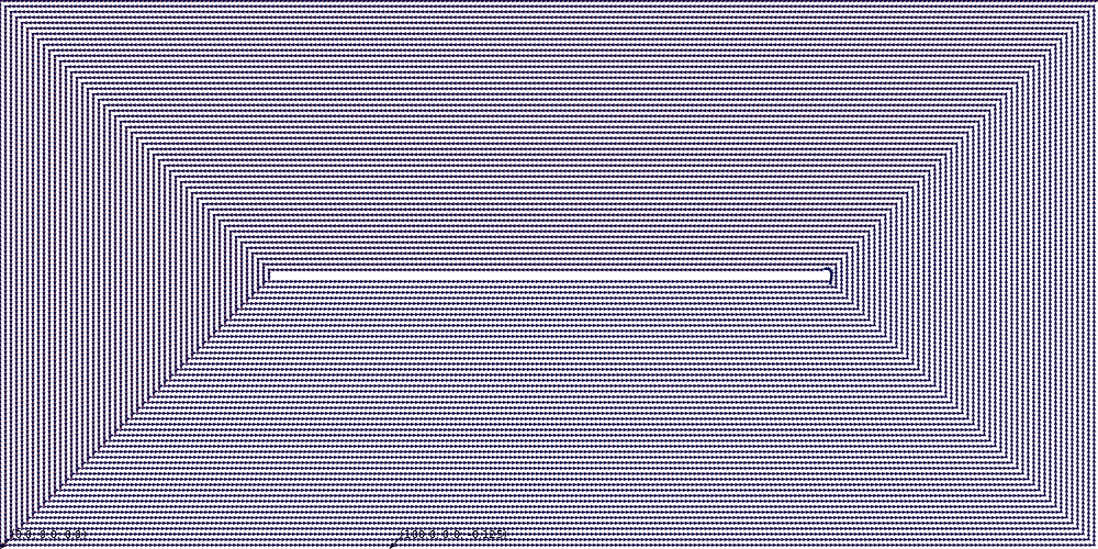

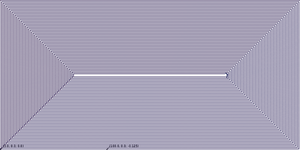

I tried simple design based on 1800mm X 2400mm rug and Inskape successfully placed 221370 nodes. The was the last thing it did. I reduced size to 1000mm X 500mm which generated 25499 nodes which using postprocessor you wrote for me generated 218000 lines of gcode. Time to generate gcode was not more than maybe 3 minutes. This works for me! With reference points on drawing I think it should be easy to break up design on layers or areas and just run sections to gcode one at a time with no registration problems.
I think I have ancestors from Ireland but after a few hundred years we have lost the accent. We watch some BBC TV shows on Netflix and some of them set in the north part of the UK might as well be in a foreign to me because I can't understand much of that version of English.
Re: custom tool definition
Can you attach that svg, or probably make a screenshot (or export to png), if it has big size?
I can not imagine what it looks like :).

Сообщение badger »
Not really very interesting. It was the simplest way to generate a bunch of points to test the system for capacity. I really should actually do a "real" design at some point. Video soon to be on an internet near you.
