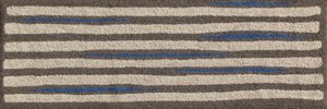

Thanks for you ever quick response. Your written English is much than Google's translations. I have hopefully correctly attached files that will help clarify my project. This is my first time dealing with an online forum so hopefully it works. It is also the first time I have coded for machine control in 30 years and then it was on a Commodore 64 with a cassette tape storage drive.
So I have experimented some in Inkscape and Gcodetools and made the sample files. There is a copy of the .svg without the tool and with. I used the default tool because it gives more options than just "tangent knife". "original.gnc" file is after running path-to-gcode.In the "modified.gnc" file I added code after the x,y moves to extend and retract an air cylinder, with the needle attached, using the coolant controls. The other change I made was moving the first knife plunge up a couple of lines so it happens before my added code and the "a" move. This change only happens once at the beginning of each path and could easily be changed by hand. I would like to use a TinyG controller which has a somewhat limited set of G and M codes so I need to cheat at times.
I have also attached a photo of one of my rugs not made with CNC so you have some idea basic designs I plan on using. The rug is about 32" x 84" and has an estimated 110,000 loops pushed in one at a time. I didn't keep track of time but it was probably 6 weeks of weekends and evenings. I need a robot slave.
Any help you can give is greatly appreciated.

rug.jpg (23030 просмотров) <a class='original' href='./download/file.php?id=10531&mode=view' target=_blank>Загрузить оригинал (204.84 КБ)</a>
Re: custom tool definition
Probably it can be easily done by adding custom post-processor.
Something like
regex( 'regex("(G0?1 [XY\-\.\d\s]*Z[\s\-\.\d]+)", "\1 \nM08 G4 p2500 \nM09 G4 p1000")' )
Are you familiar with regular expressions?
Is that carpet is made by you? Can you attach photos of your machine please? :)

Yes the carpet is made by me. The tool is a punch needle referred to as an "Oxford Punch". No machine yet. You work on linen fabric stretched tightly on a frame. From the backside you push the needle in until it stops, about 40 mm, pull it out and repeat. It works out to about 8 to 10 stitches per inch and 5 or 6 rows per inch the other way.
I am not familiar with regular expressions but the internet can reveal all. Should I be referencing python or some other language?
