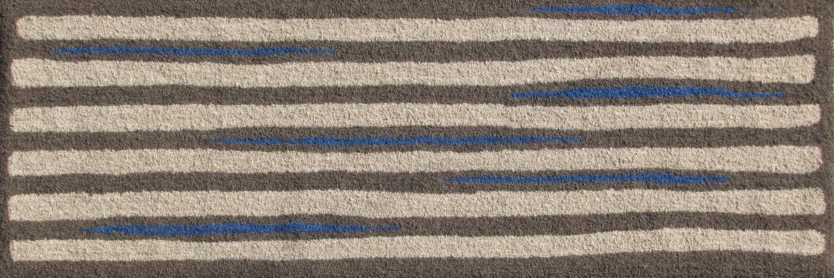

I don't know if this is a custom tool request or about canned cycles, macros, post processor or what? I don't have a controller or machine yet pending figuring out if I can control it. I'm trying to make a rug making bot similar to what is available at www.wilcom-autotuft.com only smaller, slower and cheaper. The basic idea is to move to the stitch location (inkscape node), insert the needle, raise the needle, rotate to the direction of the next move and move to the next location. Using the tangent knife tool gets me really close but is there a way to insert code at each node (after X,Y move and befor A move) to make the needle insertion? An option similar to “insert gcode after path” but “insert after move” could work. Code could be something M08 G04 P500 M09 G04 P500 to activate an air cylinder, wait for it to extend and then retract, although I would prefer to use position sensors instead of dwells. A Z move could also be used instead. A rug could have over 100,000 stitches so manual coding each action isn't too viable.

Thanks for you ever quick response. Your written English is much than Google's translations. I have hopefully correctly attached files that will help clarify my project. This is my first time dealing with an online forum so hopefully it works. It is also the first time I have coded for machine control in 30 years and then it was on a Commodore 64 with a cassette tape storage drive.
So I have experimented some in Inkscape and Gcodetools and made the sample files. There is a copy of the .svg without the tool and with. I used the default tool because it gives more options than just "tangent knife". "original.gnc" file is after running path-to-gcode.In the "modified.gnc" file I added code after the x,y moves to extend and retract an air cylinder, with the needle attached, using the coolant controls. The other change I made was moving the first knife plunge up a couple of lines so it happens before my added code and the "a" move. This change only happens once at the beginning of each path and could easily be changed by hand. I would like to use a TinyG controller which has a somewhat limited set of G and M codes so I need to cheat at times.
I have also attached a photo of one of my rugs not made with CNC so you have some idea basic designs I plan on using. The rug is about 32" x 84" and has an estimated 110,000 loops pushed in one at a time. I didn't keep track of time but it was probably 6 weeks of weekends and evenings. I need a robot slave.
Any help you can give is greatly appreciated.

rug.jpg (20887 просмотров) <a class='original' href='./download/file.php?id=10531&mode=view' target=_blank>Загрузить оригинал (204.84 КБ)</a>

Is that carpet is made by you? Can you attach photos of your machine please? :)

Yes the carpet is made by me. The tool is a punch needle referred to as an "Oxford Punch". No machine yet. You work on linen fabric stretched tightly on a frame. From the backside you push the needle in until it stops, about 40 mm, pull it out and repeat. It works out to about 8 to 10 stitches per inch and 5 or 6 rows per inch the other way.
