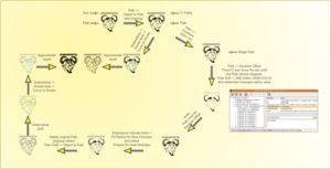

Gcodetools plug-in tutorial (2600*1300 px png ~ 700Kb) (1453343 просмотра) <a class='original' href='./download/file.php?id=127&mode=view' target=_blank>Загрузить оригинал (752.7 КБ)</a>

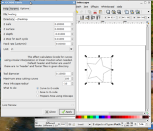

interface.png (864040 просмотров) <a class='original' href='./download/file.php?id=124&mode=view' target=_blank>Загрузить оригинал (85.2 КБ)</a>
1.,2. Output Filename and directory. If output directory contains 'header' and/or 'footer' file they will be used as header and footer for resulting Gcode.
Attention! you must specify directory in which you have rights to write! (For example my home directory '/home/nick/')
3. Z coordinate definitions.
  • Z safe - Z value of the safe distance used by G00 code to travel between different contours.
  • Z surface - Z value of the material surface
  • Z depth - depth of cutting
  • Z step for each cycle - Z step for multi-pass cutting
4. Unit selection. Inkscape's internal unit is px, all contours will be converted using px. This selection just put in Gcode G20 or G21 code. So if path has width equal 10 px and mm selected as unit result will be has width 10 mm, if in selected then result will be 10".
5. Tool diameter is used for area cutting.
6. Maximum area cutting curves is used to prevent infinite loop while computing area cutting.
Area "inkscape:radius" is used for computing area cutting curves using Incscape offset.
7. Function selection
  • Curve to Gcode - converts paths to Gcode
  • Area to Gcode - It's a quite slow method of computing Area cutting curves. Complexity of the algorithm is O(n^2) where n is the number of points. I would not recommend to use it with complex contours with more than 50 points.
  • Prepare Area using Inkscape - Creates a number of inkscape offset's which covers Path's area. This function can be applyed only to Inkscape Dynamic Offsets (Select path then Path -> Dynamyc Offset).
8. Minimum arc radius Important!. Defines minimal value or G02 and G03 arc radius. If the radius is realy small (less than 0.1 mm) EMC can raise "Zerro arc radius!" exception.
Attention! Default value = '0.05'. In some locales fraction delimiter differs to '.', if so Inkscape will consider '0.05' as '0'!
9. Scaling and offset values for X Y Z axis.
Be careful with that: if you define different values to X and Y scale G02 and G03 codes will be wrong and EMC will definitely raise an exception.

This picture shows main features of this plug-in:
Gcode tools plug-in tutorial (2600*1300 px png ~ 700Kb) (864040 просмотров) <a class='original' href='./download/file.php?id=125&mode=view' target=_blank>Загрузить оригинал (752.7 КБ)</a>

Culturedropout писал(а):
Am I doing something wrong, or is there a problem with the extension? Any help would be appreciated. Thanks.
May be you are :). What object type has that star? Is it a "Star" or "Path"? I can see that you've selected 2 objects, one of them "path" and another not! (It's written at the bottom of the window.)
About next post...
From the python manual:
10.3. cmath — Mathematical functions for complex numbers
This module is always available. It provides access to mathematical functions for complex numbers. The functions in this module accept integers, floating-point numbers or complex numbers as arguments. They will also accept any Python object that has either a __complex__() or a __float__() method: these methods are used to convert the object to a complex or floating-point number, respectively, and the function is then applied to the result of the conversion.
It seems that your python standard library might been damaged. Try to reinstall python.
When do you get this errors? At start of Inkscape or when you try to execute extension? My extension does not use complex numbers, so it should work with out cmath...
About the directory... Yes it is my home dir. But this function was made for debugging purposes. So it's never used in yours version.
One more thing unfortunately "~/" does not work, you should choose /home/<your home dir> instead of it. That could cause your problems. I've made a fix that raises exception instead of doing nothing if file can not been created.
Ok, I think I've done that, corrected version is in the header.

I tried reinstalling all of the basic Python libraries, but I'm still seeing those error messages about cmath in the trace. They appear to start showing up right after simplestyle, simplestylemodule, and/or simplepath are called. Could one or more of those be looking for the math functions? I'm not sure why it said "2 objects" in the screencap; I thought I'd done all the steps correctly to convert the object, but maybe I missed one. At any rate, I also fixed the path setting to say "/home/bill/Desktop" and tried it again, making sure that it said "Path (10 nodes)" when I selected the star, and it produced what appears to be correct G-Code output. :D I _did_ notice that when I click "Apply" in your plugin, a light-red "ghost" image of the star appears in Inkscape a little to the left of the original (see attached screencap). Is this supposed to happen? Maybe it did this before and I selected both without noticing the new object? I don't know. I'm probably not going to have a lot of time to work on this today, but I wanted to let you know that despite my best efforts, it's starting to do what it's supposed to. :lol: Thanks for your help. I'll try it shortly on some more complex shapes and see what happens. (I'm trying to generate g-code to engrave the symbols for a custom-made Mah Jong tile set from a modified version of a Mah Jong TrueType font I downloaded.) Hope you're having a good day. :)
Screenshot-1.png (863899 просмотров) <a class='original' href='./download/file.php?id=139&mode=view' target=_blank>Загрузить оригинал (109.92 КБ)</a>
Re: Inkscape Gcode tools plug-in English support forum
The 'ghost' image is a kind of preview of generated Gcode. If you try to convert curves with not straight you'll see plug-ins major function - biarc interpolation. In that preview straight elements (G01) are drawn in red - that's what you've got, and two arcs from biarc (G02 or G03) are drawn in green and blue. If something goes wrong or mistake of the interpolation is to big you can see it in preview.
The only strange thin is that it appears a little to the left, instead of same place of the source path. But still I'm happy "it's starting to do what it's supposed to." :lol:

First screen shot of new feature Loft:
How it's done in two words:
Plug-in takes a number of paths, distances between them along (y axis) and some additional parameters. Then it generates interpolation from one curve to another in given order.
There are some hidden features:
For example the step between two interpolated paths is calculated depending on interpolation function and position of control points, so this step distance is not static. It prevents big stairs on ending model.
What is needed to be done to release this function:
Add interpolation functions.
Do the bug fix. :)
loft.png (863615 просмотров) <a class='original' href='./download/file.php?id=153&mode=view' target=_blank>Загрузить оригинал (324.76 КБ)</a>
