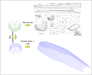

First screen shot of new feature Loft:
How it's done in two words:
Plug-in takes a number of paths, distances between them along (y axis) and some additional parameters. Then it generates interpolation from one curve to another in given order.
There are some hidden features:
For example the step between two interpolated paths is calculated depending on interpolation function and position of control points, so this step distance is not static. It prevents big stairs on ending model.
What is needed to be done to release this function:
Add interpolation functions.
Do the bug fix. :)
loft.png (863612 просмотров) <a class='original' href='./download/file.php?id=153&mode=view' target=_blank>Загрузить оригинал (324.76 КБ)</a>
This version probably has a lot of bugs, I wont recommend you using it right now.
extensions.tar.gz
(13.61 КБ) 9828 скачиваний
