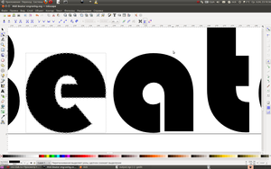

I've tried to make midi beater, only with G01.
So firstly I made a union of the paths Ctrl+"+", so it will be easier to work with them,then I added nodes with maximum space 1px. It becomes a path with 1119 nodes. Then F2, Ctrl+A (It took about 4-7 seconds), then made all segments straight. And exported to Gcode (it took 4-5 sec).
Which distance did you define when you did Add nodes? And how many nodes had the path after adding nodes?
Here's ngc file:
output.ngc
(39.94 КБ) 2017 скачиваний
I must say that 1px is quite small distance, and path will look smooth. Here's a screenshot of remade path:
Inkscape add nodes.png (25447 просмотров) <a class='original' href='./download/file.php?id=1383&mode=view' target=_blank>Загрузить оригинал (170.86 КБ)</a>

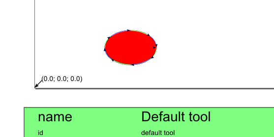

Hi, I am a novice to gcodetools and i am having trouble with the G02 amd G03 codes. I am using 1.7 gcodetools extensions, inkscape 48 and Mach3.

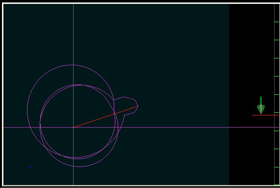

here is a simple elipse path followed by the mach3 screen shot of the gcode
inkscape path to gcode.jpg (24938 просмотров) <a class='original' href='./download/file.php?id=3718&mode=view' target=_blank>Загрузить оригинал (13.07 КБ)</a>

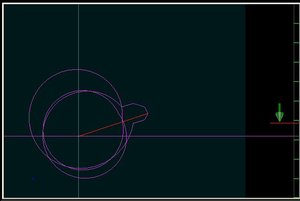

here we see arcs allover the place and curves that are probably straight lines
mach3 toolpath.jpg (24938 просмотров) <a class='original' href='./download/file.php?id=3719&mode=view' target=_blank>Загрузить оригинал (20.2 КБ)</a>

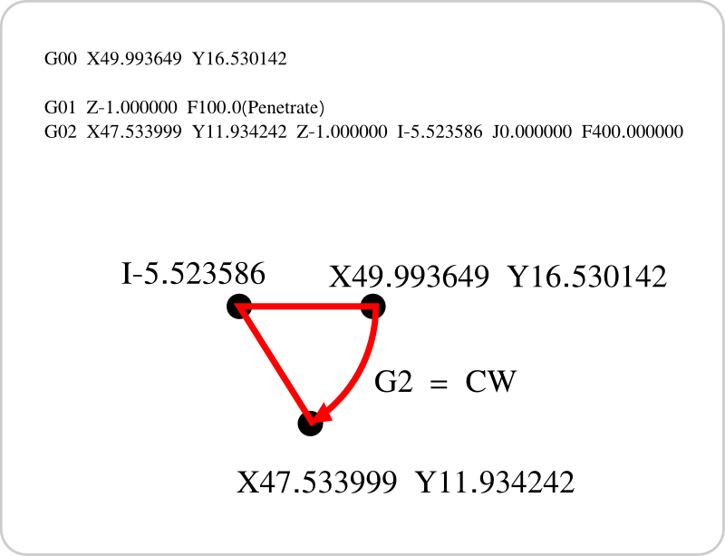

Re: Gcode for paths
Attach your svg please.
It looks like one of the axis is flipped.
The Gcode seems to be fine, probably there's mach misconfiguration.
Here's an illustration of the first arc:
G2 gcode.png (24926 просмотров) <a class='original' href='./download/file.php?id=3735&mode=view' target=_blank>Загрузить оригинал (61.93 КБ)</a>
