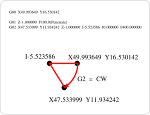

Hi,
I have just got the gcodetools working, however there are a few problems. I don't get all the menu options like the manual says. Specifically I can't get anything to change the X and Y shift.
When I output a path of some text into Gcode the straight line stuff works fine but the arc segments look all wrong. For example one line reads:-
G03 X64.156616 Y181.767328 Z-0.900000 I0.334845 J-0.160290
As I understand Gcode the I and J gives the coordinates of the center of the circle. You can see this is a long way off the X & Y which is the end point. The net result on my system is that there are lots of large circles instead of the small arcs making up the path of the letter.
I have the latest 1.6 version and am running Inkscape 0.47 on a Mac.
Any idea what is going on?
Thanks

Have you tried or previewed this Gcode?
Yes the radius can be huge, but still arc will be small. It's just a little segment of the big circle. This means that path bends slightly, so to fit it best we have to use segments of big circles. For example straight line is a segment of circle with infinite radius.
About shifting, rotating and scaling. Now Orientation points are used for those purposes. When you apply Path to Gcode, you can notice that two arrows with texts are added to the drawing. They define the Orientation. You can define scaling, rotation and shifting by scaling, rotating and moving those points or changing values of the connected text.
You can make a template drawing, add there orientation points and tool definition and even draw your CNC Machine to be more user readable. Save it to a file for use it as a template for further work.

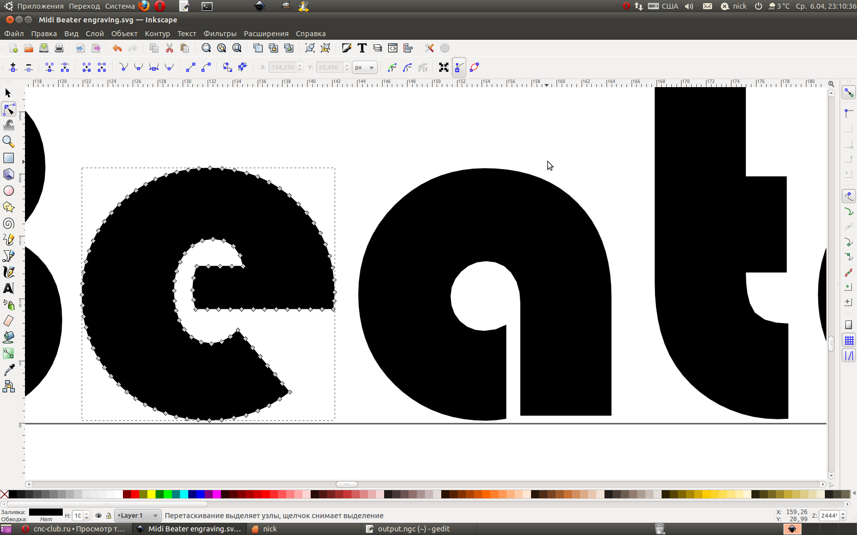

If you are fine with G01 codes you can do the folowing:
Select all paths then Extensions - Modify Path - Add nodes. Choose Ditance mode and set up preferred arc length. Apply.
Then press F2 and button which makes segments straight. When you apply Path to Gcode to such path (polyline) there will be only G01.
It's a quick but nasty solution.

I've tried to make midi beater, only with G01.
So firstly I made a union of the paths Ctrl+"+", so it will be easier to work with them,then I added nodes with maximum space 1px. It becomes a path with 1119 nodes. Then F2, Ctrl+A (It took about 4-7 seconds), then made all segments straight. And exported to Gcode (it took 4-5 sec).
Which distance did you define when you did Add nodes? And how many nodes had the path after adding nodes?
Here's ngc file: I must say that 1px is quite small distance, and path will look smooth. Here's a screenshot of remade path:

here is a simple elipse path followed by the mach3 screen shot of the gcode here we see arcs allover the place and curves that are probably straight lines Here is the gcode file minimum arc radius = 0.1
biarc intoplation tol = 1
I am really not sure what is going on or what i am doing wrong can you help

Re: Gcode for paths
Attach your svg please.
It looks like one of the axis is flipped.
The Gcode seems to be fine, probably there's mach misconfiguration.
Here's an illustration of the first arc:
