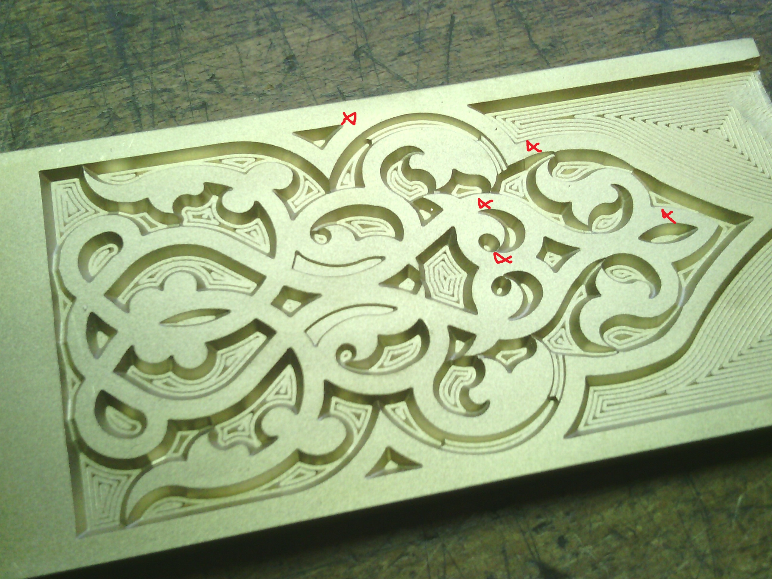

here s an exemaple of what I d like to achieve with inkscape and g code one day..
the red Areas are most visible to Show where milling Point get more high than other Areas
IMG_20131113_091932.jpg (19367 просмотров) <a class='original' href='./download/file.php?id=21236&mode=view' target=_blank>Загрузить оригинал (1.02 МБ)</a>
Re: tapered line endings
How do you expect those areas to be cut?
Can you show original svg?

here is the original,and yes how to be cut??? that s what i ve been wondering about all the time ;-)
:thinking: thanks
