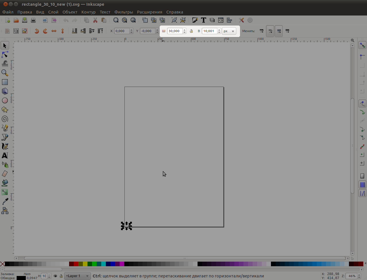

Ok, now change units at top right to mm instead of px ;)

Nick писал(а):Ok, now change units at top right to mm instead of px ;)
in inkscape ? if change the units to mm and draw a 300mm X 100mm rectangle and than convert the output is 3000mm X 1000mm. Where did i do something wrong :cry:
Re: Inkscape Gcodetools plug-in English support forum
The sheet size in your svg is A4 - it is 297x210mm, how do you thing how big should be your rectangle? :)
Note px (pixels) as units at the right of highlighted area on the screenshot

rubyred писал(а):in inkscape ? if change the units to mm and draw a 300mm X 100mm rectangle and than convert the output is 3000mm X 1000mm. Where did i do something wrong
Attach your new svg and ngc...
Here, 300mm X 100mm rectangle and the ngc output is 3000mm X 1000mm :( it's not evet exactly multipled by 10. it is now a 299.9mm x 99.97mm rectangle :(
30x10.svg
(1.72 КБ) 1057 скачиваний
30x10.ngc
(666 байт) 1397 скачиваний
hmmm.
What I did:
open your file
move your rect to origin (y,x 0,0)
changed size to 300x100
path to Gcode
And got
G01 X299.999966 Y99.999988 Z-0.125000 F400.000000 which is almost exact 300x100
(LASER Header)
(Generated by gcodetools from Inkscape.)
(Header end.)
G21 (All units in mm)
(Start cutting path id: rect2985)
(Change tool to Default tool)
G00 Z5.000000
G00 X-0.000006 Y99.999988
G01 Z-0.125000 F100.0(Penetrate)
G01 X299.999966 Y-0.000027 Z-0.125000
G01 X-0.000006 Y-0.000027 Z-0.125000
G01 X-0.000006 Y99.999988 Z-0.125000
G00 Z5.000000
(End cutting path id: rect2985)
(Footer)
M5
G00 X0.0000 Y0.0000
M2
(Using default footer. To add your own footer create file "footer" in the output dir.)
(end)

Nick, you changed the size in mm right ? if i open this gcode in grbl controller machine wants to go 300cm not mm.Can you tell me "path to gcode" settings step by step ? maybe im doing something wrong.
P.s.I want to use gcodes for 2D cutting via GRBL.
rubyred писал(а):grbl controller
Does grbl controller use cm as standard units?
Are you sure that there no option to change them to mm?
Anyway you can edit Right Orientation point to be not (100,0,...) but (10,0,...)

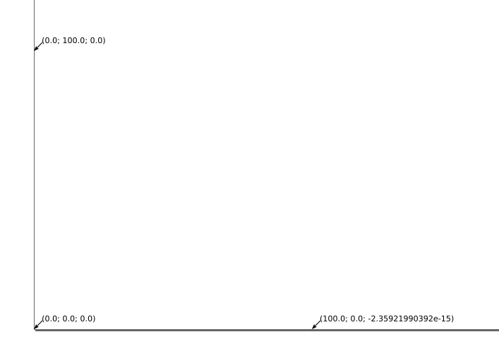

After some research i just come from to see that when put orientation point on the sheet the z depht point was set to -2.35921990392e-15
So i have effectively not set the Z in the orientation point dialog but just keep it to zero.
If i edit the orientation point that have been set to the sheet and set it manually to 0 or -5 or others all stuff work...
After that i try to set the z to -5 on the orientation point dialog and add orientation point to the sheet and then the orientation point is good set with -5.
If i reset Z to 0 in dialog and perform a new orientation point all is perform good now ???
So i don't know why when have first start of 0.91 when put the orieantation point this one set the Z to -2.35921990392e-15 on the sheet.. perhaps
a bad var init somewhere ? So i don't arrive to reproduce the problem after have set the Z in the dialog orientation point windows one time.
alfcnc писал(а):-2.35921990392e-15
probably this form does not covered by regular expression which defines Orientation points.
hmmm got to fix that....
alfcnc писал(а):Do you think this come just from problem of Debian version ? or this could be gcodetools errors ?
this should be gcodetools error. I'm not sure what exact version is included into inkscape 0.91...

In my inkscape Inkscape 0.91 r13725 Gcodetools says about ver. 1.7
And if i set the z value manually to this -2.35921990392e-15 the same problem is reproducible.
