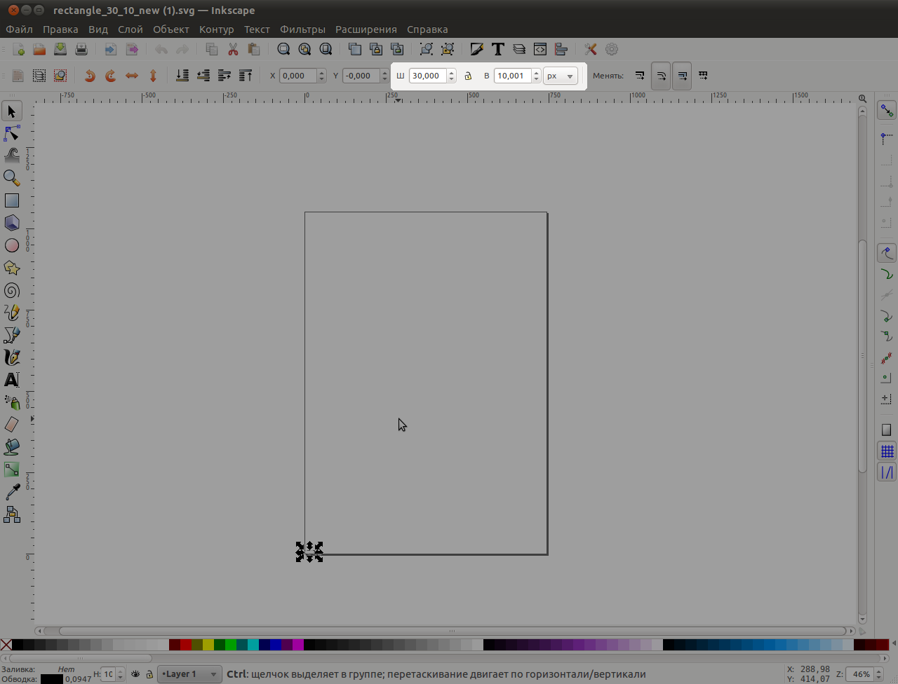

Ok, now change units at top right to mm instead of px ;)

Nick писал(а):Ok, now change units at top right to mm instead of px ;)
in inkscape ? if change the units to mm and draw a 300mm X 100mm rectangle and than convert the output is 3000mm X 1000mm. Where did i do something wrong :cry:
Re: Inkscape Gcodetools plug-in English support forum
The sheet size in your svg is A4 - it is 297x210mm, how do you thing how big should be your rectangle? :)
Note px (pixels) as units at the right of highlighted area on the screenshot
rubyred писал(а):in inkscape ? if change the units to mm and draw a 300mm X 100mm rectangle and than convert the output is 3000mm X 1000mm. Where did i do something wrong
Attach your new svg and ngc...
Here, 300mm X 100mm rectangle and the ngc output is 3000mm X 1000mm :( it's not evet exactly multipled by 10. it is now a 299.9mm x 99.97mm rectangle :(
hmmm.
What I did:
open your file
move your rect to origin (y,x 0,0)
changed size to 300x100
path to Gcode
And got
G01 X299.999966 Y99.999988 Z-0.125000 F400.000000 which is almost exact 300x100

Nick, you changed the size in mm right ? if i open this gcode in grbl controller machine wants to go 300cm not mm.Can you tell me "path to gcode" settings step by step ? maybe im doing something wrong.
P.s.I want to use gcodes for 2D cutting via GRBL.
rubyred писал(а):grbl controller
Does grbl controller use cm as standard units?
Are you sure that there no option to change them to mm?
Anyway you can edit Right Orientation point to be not (100,0,...) but (10,0,...)
