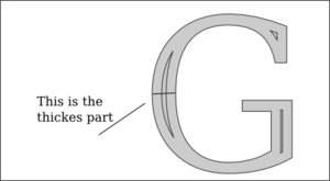

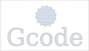

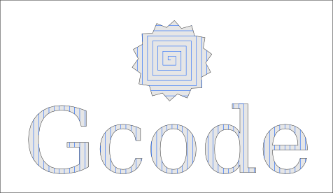

Re: Inkscape Gcodetools plug-in English support forum
Attach your initial svg.
1. To create area paths do the following. Open Gcodetools -> Area and assign Area width, it is the width of the thickest part of the path. You can find thickest path by creating dynamic offset from the path (Ctrl+J) and contract it using node editing tool F2.
gcode pocketing.png (11624 просмотра) <a class='original' href='./download/file.php?id=1399&mode=view' target=_blank>Загрузить оригинал (16.52 КБ)</a>
2. Tool's diameter can be set using tools library by adding tool's definition. If there's no tools definition in the drawing before Area function is applied the default tool will be automatically added to the drawing.
3. In Gcodetools-dev there are some new functions to create area paths. They usually work better than Area function from the Gcodetools 1.6. And allow to get path's like this:
gcode area pocketing.png (11624 просмотра) <a class='original' href='./download/file.php?id=1400&mode=view' target=_blank>Загрузить оригинал (20.59 КБ)</a>
I highly recommend to use gcodetools-dev. See the header of the thread to know how to get Gcodetools-dev.

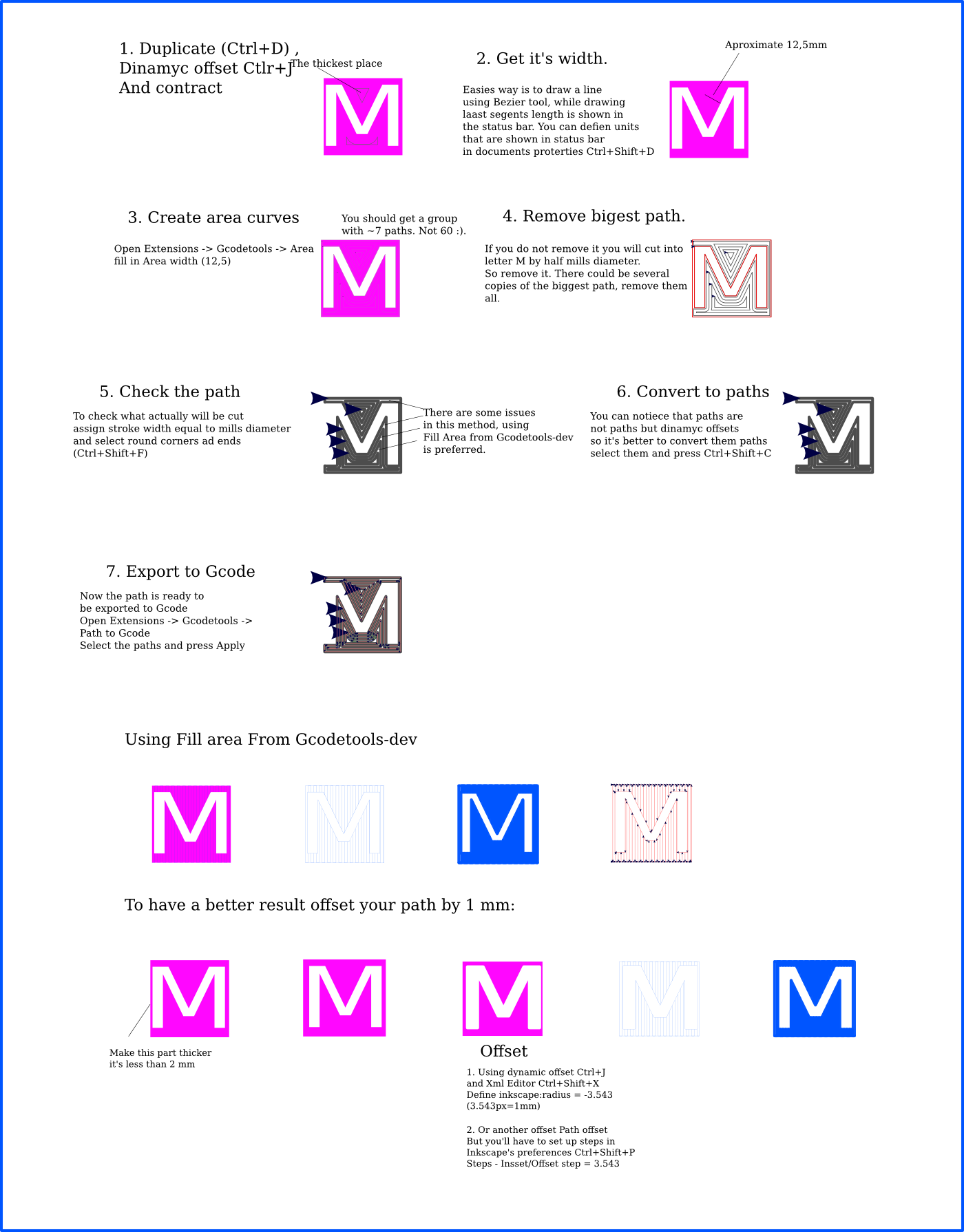

The problem is that area width is to big. You can notice that after area function you have a group with 61 path. And you have about 55 copyes of outer path. Gcdetools will create (Area width)/(tool diameter) paths. So you have to set area width more carefuly.
Here's a how-to. You can open it in inkscape and try the thing out:
svg to gcode pocketing.svg
(247.18 КБ) 1414 скачиваний
cnc pocketing with inkscape.png (11612 просмотров) <a class='original' href='./download/file.php?id=1403&mode=view' target=_blank>Загрузить оригинал (335.98 КБ)</a>
And here's generated Gcode from one of trials:
output.ngc
(31.26 КБ) 1595 скачиваний
Step 1.
1. Select the path. Make sure it's one path not a Group or several paths.
2. Press Crtl+D to duplicate it.
3. Ctrl+J to make it not Path but Dynamic offset.
4. Press F2 to select Node Editing tool.
5. You'll see only one node on the path. Dragging that node will offset/inset the path.
6. So contract the path to find the thickest place.
Yes yes yes try the second part. To be true Area function was the second function I've made just after Path to Gcode, and it was the second time I programmed python. So it's far not perfect. And it's a kind of difficult thing to work with offsets.
Fill area is one of the last functions and filling the path with straight lines is much easier, so usually Fill area works better, faster, easier, etc. :)
>> Inicial.svg
Great work! Best possible with Area function not from gcodetools-dev version.

ChrisInNewbury
Сообщения: 20
Зарегистрирован: 19 апр 2011, 02:32
Откуда: Newbury, Berkshire, England
Сообщение ChrisInNewbury »
Greetings,
I've just joined, having downloaded Inkscape and Gcodetools a day or two ago. Very impressed. :D
I make sundials, so have been looking for ways to do good quality v-carved text engraving.
Gcodetools' Area function seems to work well, though with a few artefacts one can edit out. It seems that small changes to parameters can greatly affect whether it generates artefacts, but I guess this is an Inkscape bug, not Gcodetools.
But Engraving function seems very poor (I don't have the dev version). It often generates apparently random walks. I've never used Python before but know how Beziers work and speak other languages fluently, so am willing to try to debug it. Is there any documentation on its algorithm? The .py file is so big I'm struggling to find my way round it. Just as you use Inkscape to calculate Area-filling toolpaths from offsets, I wonder if you could use the same function to provide hints to the engraving code? It is safe to have a conical cutter on a dynamic offset with radius r with Z=-r.
By the way, depending on what you're trying to make, the engraving gcode should follow the entire path, not assume that a cylindrical milling cutter has been able to get in close. You might want to create a bevelled v-shaped profile all the way.
Part of my problem may be that I don't fully understand the parameters - notably the critical angle and path length.
By the way, I do speak English fluently and am willing to provide better English messages and labels. I think you asked for someone to do this a year ago and it seems nobody has done so. Another suggestion is to put tool information into the Gcode as comments to help the operator.
Chris
Newbury
England

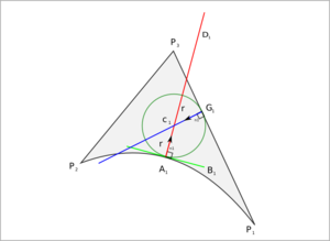

"Inkscape bug, not Gcodetools", yes Gcodetools uses Inkscape's internal offset function. But I would not blame Inkscape for that bugs. Offset of the Bezier's curve is very very complex problem. I've not seen any program that do it without bugs, even powerful CAD's such as Rhino have problems with offset (taking in account that Rhino makes simpler offset).
Engraving has some bugs to :). There's no Inkscape function that uses variable radius offset. To find Engraving function in the code search for "def engraving", ant it lasts until the orientation function.
Here's approximate algorithm of Engraving Function:
1. Go trough all path's segments.
2. Get offset for the 4 points of the segment in t=0,0.25,0.75,1.
3. Calculate maximum radius of the circle which will lie inside the path and have center at the normal to the path at specified points. this radius is calculated using numerical methods solving one of these systems:
formula.png (11566 просмотров) <a class='original' href='./download/file.php?id=1427&mode=view' target=_blank>Загрузить оригинал (31.34 КБ)</a>
4. Then a new segment that goes through offsetted points is created.
Most of artifacts appear if there's a lack of nodes in the path near the corners or on the very long segments. You can find problem places turning on show additional debug graphics.
To make engraving trajectory for whole path, not only thing places set Maximum distance for engraving to large value.
To do comments in the Gcode about the tool I belive you can use "tool's change Gcode" and put all comments there. This Gcode will appear just before using current tool, or put it Gcode before path (will appear before cutting each path).
Glad to hear that you can help us to make messages better! If you have any suggestions write them down and I'll include it in to the code. Or you can include it yourself to the Bazaar pool at https://launchpad.net/gcodetools , you'll need to have an account at Launchpad, and I'll include you to Gcodetools team so you can post to the code.
PS attach your svg for engraving I'll try to give some advises.

ChrisInNewbury
Сообщения: 20
Hi Nick,
Thanks for the formulae for engraving radius. Wow! Newton Raphson solution of cubics. I can see it in the code, now. There is surely an easier way. I'll give it some thought.
By the way, I found a bug in bezmisc.py. The function bezierslopeatt returns dx=dy=0 if t=0 and the bezier's first control point is at its start point. It calls bezierparameterize which will return cx=cy=0 which is correct but means that dx/dt=0 and dy/dt=0 but this is not helpful if you are using it to find dy/dx.
Oh - just spotted that a correct version is in gcodetools.py No problem, then. By the way, several functions in gcodetools don't seem to be called. I guess they are left over from previous versions.
Question? Does Inkscape generate all the possible path data elements, such as s ? It seems to use c for symmetric nodes, so I guess it calculates that a node is symmetric from its geometry, not from the user having specified it.
Minor point- gcodetools version strings on the help tabs (i.e. when you run gcodetools) say 1.6.01
I've attached a file that shows erratic paths from the engraving function. Also, an on-line tutorial on Area is out of date, I think. It tells you to create vertical bars.
Regards
Chris
engravingTutorial.svg
See my annotations regarding errors in gcodetools
(318.26 КБ) 1238 скачиваний
ChrisInNewbury
Сообщения: 20
Hi Nick/All
Attached is a file with my initial thoughts on how to calculate the engraving path. Is this how it already works, or might I be on to something? I don't want to waste time if it isn't original.
By the way, I just love the de Casteljau method for dividing a Bezier into two halves in a few nanoseconds. Are you all familiar with it? When working with Beziers there is usually, in my experience, no need ever to get involved in cubic equations or their derivitives.
Thanks for any thoughts anyone else may have
Chris
MyEngravingIdeas1.svg
My thoughts on calculating engraving path
(204.9 КБ) 1342 скачивания
Here's a little more detailed explanation of algorithm:
Lets assume these points:
engraving gcode.png (11529 просмотров) <a class='original' href='./download/file.php?id=1446&mode=view' target=_blank>Загрузить оригинал (53.3 КБ)</a>
What we have: a number of Besier's cubic curve segments P1P2 P2P3 and P3P1, and we are given point A1.
What we want: find maximum radius "r" of the circle that lies inside the curve for the given Point A1.
Unfortunately we do not know the point on the other side of the curve (G1).
What do we know about the circle:
1. It's center lies on the normal to the curve at the point A1 (A1D1).
2. It's center lies on the normal to the curve at point G1, we do not know where G point is but know about the normal.
3. Distance A1C1 = r and G1C1 = r.
These give us three equations:
1,2) C1 = A1 + t1*n1 = G1 + t2*n2 // this gives two equations because all points and normals are defined by two parametric functions x(t) and y(t)
3) |A1C1| = |G1C1|
so this gives us the system (last system from my previous post) from 3 parameters t1,t2 and t3. Solving this system we get exact position of point C1 and value for radius r.
When we solve such system for all segments of the curve we can get the maximum radius of the circle that liec inside the curve and touches the path at given point A1. Problem solved :).
engraving.svg
(20.73 КБ) 1149 скачиваний
