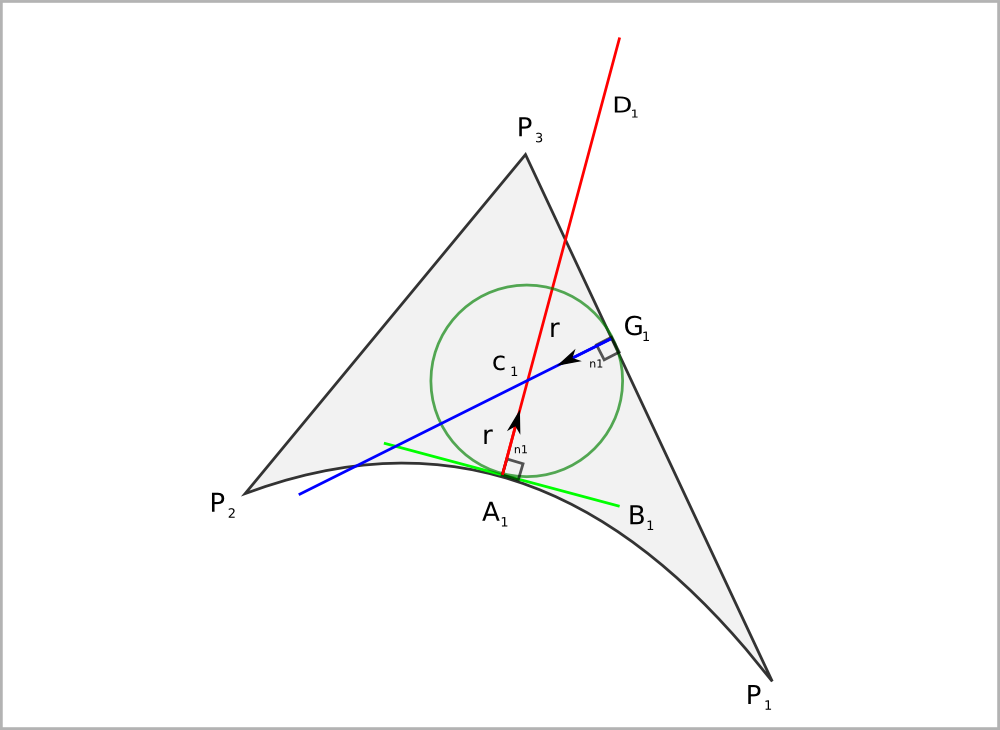

Here's a little more detailed explanation of algorithm:
Lets assume these points:
engraving gcode.png (11273 просмотра) <a class='original' href='./download/file.php?id=1446&sid=159f32f407226ce1d7fa9d49c5272082&mode=view' target=_blank>Загрузить оригинал (53.3 КБ)</a>
What we have: a number of Besier's cubic curve segments P1P2 P2P3 and P3P1, and we are given point A1.
What we want: find maximum radius "r" of the circle that lies inside the curve for the given Point A1.
Unfortunately we do not know the point on the other side of the curve (G1).
What do we know about the circle:
1. It's center lies on the normal to the curve at the point A1 (A1D1).
2. It's center lies on the normal to the curve at point G1, we do not know where G point is but know about the normal.
3. Distance A1C1 = r and G1C1 = r.
These give us three equations:
1,2) C1 = A1 + t1*n1 = G1 + t2*n2 // this gives two equations because all points and normals are defined by two parametric functions x(t) and y(t)
3) |A1C1| = |G1C1|
so this gives us the system (last system from my previous post) from 3 parameters t1,t2 and t3. Solving this system we get exact position of point C1 and value for radius r.
When we solve such system for all segments of the curve we can get the maximum radius of the circle that liec inside the curve and touches the path at given point A1. Problem solved :).
