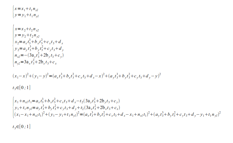

Re: Inkscape Gcodetools plug-in English support forum
"Inkscape bug, not Gcodetools", yes Gcodetools uses Inkscape's internal offset function. But I would not blame Inkscape for that bugs. Offset of the Bezier's curve is very very complex problem. I've not seen any program that do it without bugs, even powerful CAD's such as Rhino have problems with offset (taking in account that Rhino makes simpler offset).
Engraving has some bugs to :). There's no Inkscape function that uses variable radius offset. To find Engraving function in the code search for "def engraving", ant it lasts until the orientation function.
Here's approximate algorithm of Engraving Function:
1. Go trough all path's segments.
2. Get offset for the 4 points of the segment in t=0,0.25,0.75,1.
3. Calculate maximum radius of the circle which will lie inside the path and have center at the normal to the path at specified points. this radius is calculated using numerical methods solving one of these systems:
formula.png (11569 просмотров) <a class='original' href='./download/file.php?id=1427&mode=view' target=_blank>Загрузить оригинал (31.34 КБ)</a>
4. Then a new segment that goes through offsetted points is created.
Most of artifacts appear if there's a lack of nodes in the path near the corners or on the very long segments. You can find problem places turning on show additional debug graphics.
To make engraving trajectory for whole path, not only thing places set Maximum distance for engraving to large value.
To do comments in the Gcode about the tool I belive you can use "tool's change Gcode" and put all comments there. This Gcode will appear just before using current tool, or put it Gcode before path (will appear before cutting each path).
Glad to hear that you can help us to make messages better! If you have any suggestions write them down and I'll include it in to the code. Or you can include it yourself to the Bazaar pool at https://launchpad.net/gcodetools , you'll need to have an account at Launchpad, and I'll include you to Gcodetools team so you can post to the code.
PS attach your svg for engraving I'll try to give some advises.

Hi Nick,
Thanks for the formulae for engraving radius. Wow! Newton Raphson solution of cubics. I can see it in the code, now. There is surely an easier way. I'll give it some thought.
By the way, I found a bug in bezmisc.py. The function bezierslopeatt returns dx=dy=0 if t=0 and the bezier's first control point is at its start point. It calls bezierparameterize which will return cx=cy=0 which is correct but means that dx/dt=0 and dy/dt=0 but this is not helpful if you are using it to find dy/dx.
Oh - just spotted that a correct version is in gcodetools.py No problem, then. By the way, several functions in gcodetools don't seem to be called. I guess they are left over from previous versions.
Question? Does Inkscape generate all the possible path data elements, such as s ? It seems to use c for symmetric nodes, so I guess it calculates that a node is symmetric from its geometry, not from the user having specified it.
Minor point- gcodetools version strings on the help tabs (i.e. when you run gcodetools) say 1.6.01
I've attached a file that shows erratic paths from the engraving function. Also, an on-line tutorial on Area is out of date, I think. It tells you to create vertical bars.
Regards
Chris
I'm short of time now so
1. Bezier's slope at the point is calculated from it's parameterisation x(t) and y(t). see csp_slpoe or csp_normalized_slope. There could be some problems in case if slope value equals (0,0) for the point (if one of the control points equals to the end point). There are some ways to go around that.
2. Yes of coarse we use Casteljau. see def split() or def csp_split
I'll post back with more details of the algorithm.
Here's a little more detailed explanation of algorithm:
Lets assume these points:
engraving gcode.png (11532 просмотра) <a class='original' href='./download/file.php?id=1446&mode=view' target=_blank>Загрузить оригинал (53.3 КБ)</a>
What we have: a number of Besier's cubic curve segments P1P2 P2P3 and P3P1, and we are given point A1.
What we want: find maximum radius "r" of the circle that lies inside the curve for the given Point A1.
Unfortunately we do not know the point on the other side of the curve (G1).
What do we know about the circle:
1. It's center lies on the normal to the curve at the point A1 (A1D1).
2. It's center lies on the normal to the curve at point G1, we do not know where G point is but know about the normal.
3. Distance A1C1 = r and G1C1 = r.
These give us three equations:
1,2) C1 = A1 + t1*n1 = G1 + t2*n2 // this gives two equations because all points and normals are defined by two parametric functions x(t) and y(t)
3) |A1C1| = |G1C1|
so this gives us the system (last system from my previous post) from 3 parameters t1,t2 and t3. Solving this system we get exact position of point C1 and value for radius r.
When we solve such system for all segments of the curve we can get the maximum radius of the circle that liec inside the curve and touches the path at given point A1. Problem solved :).
