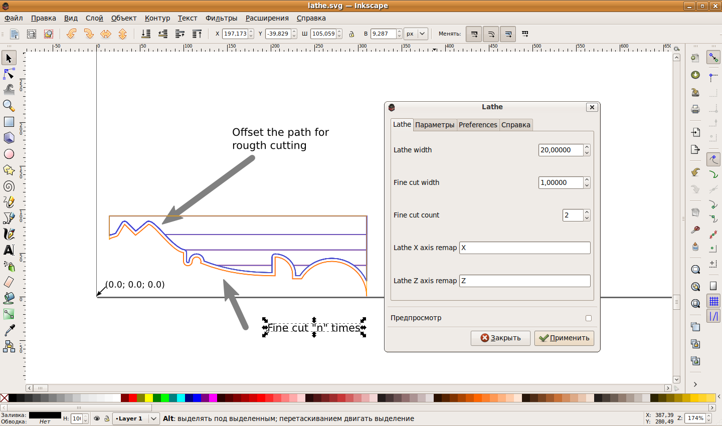

Here what has been done in Revision 124:
1. Offset almost done. It works almost fine on not very complicated paths.
2. Offset have been integrated into lathe procedure. See the attachment.
What has to be done:
1. Offset bugfixing. (It might be not very important for lathe but if offset procedure gives two separate path it could lead to a problem - one of the paths could be not computed. It is not very important for the lathe extension because the offset distance should not be big, so the probability of separate loops is low.)
2. Export procedure :). I have not done it yet, but I think that almost all is ready for it. So I think I'll write it soon.
This have been done in one click :) :
0057 gcodetools lathe.png (16411 просмотров) <a class='original' href='./download/file.php?id=557&sid=f521d19029608bf741a4039083d46936&mode=view' target=_blank>Загрузить оригинал (159.1 КБ)</a>

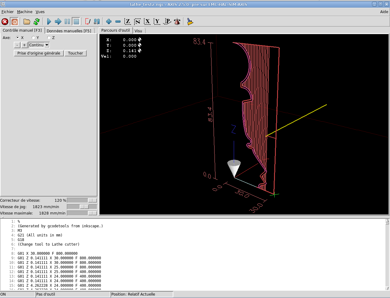

Ok for the I,J,K problem you must just add the G17 or G18 or G19 word before G02 command for select the good working plane because
the default one in EMC² is the XY plane.
For example when remapping in gcode tools is
X rempa to Z
and
Z remap to X
or X to X an Z to Z
The gcode after G21 must be G18 see the screenshot !
and gcodefile
lathe_on_mill_in_ZX_configuration.png (16402 просмотра) <a class='original' href='./download/file.php?id=562&sid=f521d19029608bf741a4039083d46936&mode=view' target=_blank>Загрузить оригинал (88.16 КБ)</a>
gcode file:
lathe_testz.ngc
(83.89 КБ) 1955 скачиваний

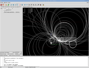

If generate gcode for lathe config of EMC² : gcodetools remaping X to X and Z to Z .the AXE for arcs are invert in J and K see screenshot in next post for see the effect... big problem...
I must set remap with X remap to Z and Z remap to X to have gcode who show good shape in emc..
And must add the G18 after G21 !
And the last move for return the tools to G0 X0 Z0 was broken and Gcode tools have set G0 X0 "Y0"....that's block loading and running of the gcode in the EMC² lathe config...
After this change the code load and run good in EMC² config and in emc mill config and run like a Vertical lathe : Wonderful ! Big thank's for this that's give to almost cnc mill config to turn little part or Big part if big CNC or BIG mill that was convert to EMC ...

another problem !
If generate with lathe config setting for axis remap:
So X to X and Z to Z:
The gcode load look likes this one... I think it's because you have invert I,K coordinate for this mode.
lathe_nativ_XZ_remap.png (16401 просмотр) <a class='original' href='./download/file.php?id=564&sid=f521d19029608bf741a4039083d46936&mode=view' target=_blank>Загрузить оригинал (93.67 КБ)</a>

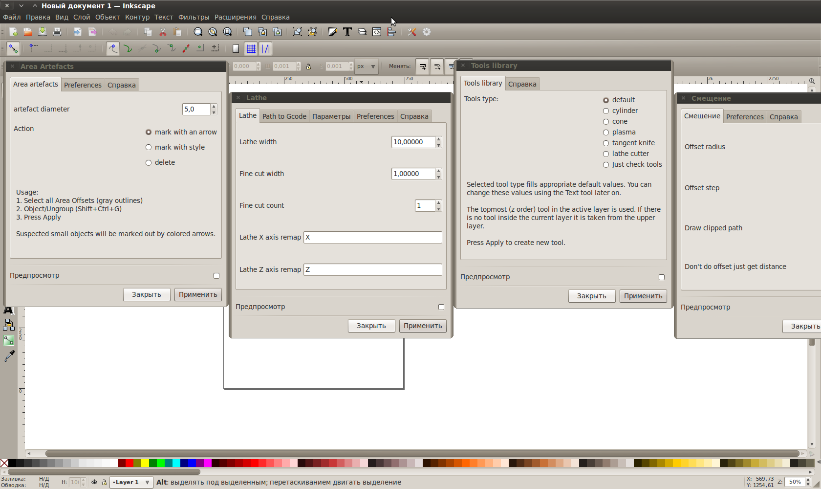

Re: Gcode tools - lathe extension develop
I'm not quite sure that you've understand me. So if you'll do what I've written, you will have separate for different functions which can be easier to use.
0058 gcodetools interface.png (16396 просмотров) <a class='original' href='./download/file.php?id=565&sid=f521d19029608bf741a4039083d46936&mode=view' target=_blank>Загрузить оригинал (188.47 КБ)</a>

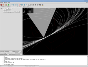

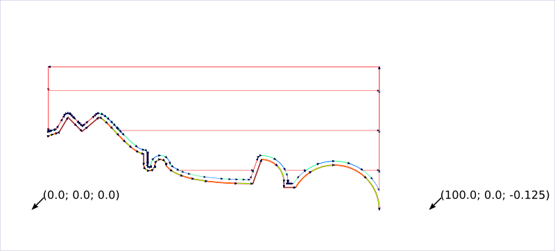

Yes we probably should add check box or something like that. Using orientation points to solve this is not correct.
The lathe goes from "Lathe width" to curves position. And if we flip the axis before the plug-in calculates lathe trajectory we'll see something like this, because the plug-in would not know that axis is flipped.
0059 gcode tools lathe.png (16377 просмотров) <a class='original' href='./download/file.php?id=573&sid=f521d19029608bf741a4039083d46936&mode=view' target=_blank>Загрузить оригинал (55.01 КБ)</a>
I think we should do it using a post processor. We are discussing it right now at the Russian developing thread.
As the quick fix you can try add to your ngc at the top
#1 = -1 (flip_y)
and do the following replaces. (Just ordinary replace not regex.)
" Y" to " Y#1*"
" J" to " J#1*"
"G03 " to "G0! "
"G02 " to "G03 "
"G0! " to "G02 "
This will flip your y axis.
