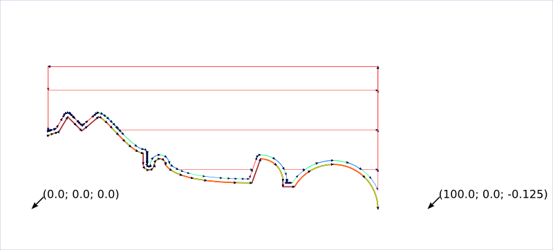

Here what has been done in Revision 124:
1. Offset almost done. It works almost fine on not very complicated paths.
2. Offset have been integrated into lathe procedure. See the attachment.
What has to be done:
1. Offset bugfixing. (It might be not very important for lathe but if offset procedure gives two separate path it could lead to a problem - one of the paths could be not computed. It is not very important for the lathe extension because the offset distance should not be big, so the probability of separate loops is low.)
2. Export procedure :). I have not done it yet, but I think that almost all is ready for it. So I think I'll write it soon.
This have been done in one click :) :

Re: Gcode tools - lathe extension develop
Revision 126
Lathe Export has been done and now it's ready for testing.
Unfortunately I have not any Gcode checker nearby now. So if anybody can test it I'll appreciate it :).

After applying lathe should look like this:
0058 gcode tools lathe.png (16420 просмотров) <a class='original' href='./download/file.php?id=561&mode=view' target=_blank>Загрузить оригинал (24.37 КБ)</a>
Yes we probably should add check box or something like that. Using orientation points to solve this is not correct.
The lathe goes from "Lathe width" to curves position. And if we flip the axis before the plug-in calculates lathe trajectory we'll see something like this, because the plug-in would not know that axis is flipped.
0059 gcode tools lathe.png (16388 просмотров) <a class='original' href='./download/file.php?id=573&mode=view' target=_blank>Загрузить оригинал (55.01 КБ)</a>
I think we should do it using a post processor. We are discussing it right now at the Russian developing thread.
As the quick fix you can try add to your ngc at the top
#1 = -1 (flip_y)
and do the following replaces. (Just ordinary replace not regex.)
" Y" to " Y#1*"
" J" to " J#1*"
"G03 " to "G0! "
"G02 " to "G03 "
"G0! " to "G02 "
This will flip your y axis.
