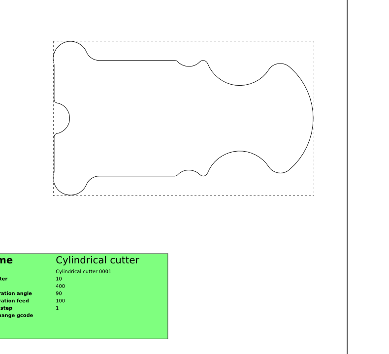

problem with Z depth:
This morning I used inkscape .48 with your entension to generate gcode using mm and z axis parameters 5 mm safe, surface 0.0, and depth -0.01 it generated top portion shown below:
Header)
(Generated by gcodetools from Inkscape.)
(Using default header. To add your own header create file "header" in the output dir.)
M3
(Header end.)
G21 (All units in mm)
G00 Z5.000000
G00 X5.766556 Y-8.309251
G01 Z-0.010000 F100.0
G03 X5.801289 Y-7.860250 Z-0.010000 I-21.541572 J1.892197 F400.000000
G03 X5.827190 Y-7.402779 Z-0.010000 I-22.343967 J1.494543
Mach3 read file, objects egraved very well.
Then tried same object with some added objects using the same z axis parameters 5 mm safe, surface 0.0, and depth -0.01 it generated top portion shown below:
(Header)
M3
(Header end.)
G00 Z5.000000
G00 X20.257776 Y32.258771
G01 Z-10.000000 F100.0
G01 X20.201933 Y32.234045 Z-10.000000 F400.000000
G03 X20.152934 Y32.153001 Z-10.000000 I0.182507 J-0.165678
G03 X20.112459 Y31.923775 Z-10.000000 I0.625309 J-0.228600
The z won't show up as -0.01 it shows up as -10 as seen above. The text in the origin that the extension adds, shows (100.0;0.0;-0.099999) which looks like the right z depth, but why does it only create -10 as the zdepth?
Re: Inkscape Gcodetools plug-in English support forum
Attach your svg file please. I'll got to check it.
It's a strange behavior...
roteng
Сообщения: 2
Зарегистрирован: 04 фев 2011, 00:04
Сообщение roteng »
attached is the inscape file both before the extension and after running the extension. I had to remove a few converted text elements that were paths to make it more generic, this version still generates the -10 on the Z axis.
tank_tag_no_shield_b.svg
inkscape file before running the extension
(67.82 КБ) 924 скачивания
tank_tag_no_shield_after_gcode_b.svg
after running extension inkscape svg file
(3.43 МБ) 1058 скачиваний
I thought that you've got problem with "Path to gcode". That's why svg is important :).
Now to the point.
It seems that there's something wrong with the default tool. Try go to Gcodetools->Tools Library and add an cone cutter definition. It worked for me.
By the way what cutter's bit are you planing to use to engrave it?

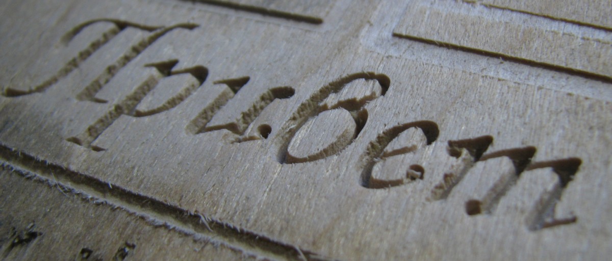

Engraving makes a trajectory inside the path. And edges of machined trajectory should fit the original path. Z depth of the trajectory will be different for different parts of the path and it depends on the cutter's shape and path's "width" at that part.
Path-to-gcode converts the path into gcode trajectory. And cut it at the defined depth.
So here's a small illustration:
path to gcode vs engraving.png (7160 просмотров) <a class='original' href='./download/file.php?id=1134&mode=view' target=_blank>Загрузить оригинал (106.89 КБ)</a>
Here's an engraving example:
gcode engraving.JPG (7160 просмотров) <a class='original' href='./download/file.php?id=1135&mode=view' target=_blank>Загрузить оригинал (128.95 КБ)</a>
And Path to Gcode: Notice the letters
path to gcode.JPG (7160 просмотров) <a class='original' href='./download/file.php?id=1136&mode=view' target=_blank>Загрузить оригинал (58.69 КБ)</a>

Hi !
I have the path show under this was design from Qcad in dxf...
This give me on inkscape this with just stroke activate...
shape1_without_fill.png (6928 просмотров) <a class='original' href='./download/file.php?id=1184&mode=view' target=_blank>Загрузить оригинал (29.96 КБ)</a>
If setting fill the form become this....
shape1_with_fill.png (6928 просмотров) <a class='original' href='./download/file.php?id=1185&mode=view' target=_blank>Загрузить оригинал (12.44 КБ)</a>
If I do Area with Gcodetools this give me the area of the shape from the fill shape not the stroke....
bad for me....and curious results...
here the svg...
test_area.svg
(13.96 КБ) 954 скачивания
The alone solution i have found...
Is Stroke to path Ctrl+alt+c
Union Ctrl++
Apply Close Curve to have clean curve...
And then Area...
But this give me twice path were I have one ....
And When doing Area this make Inside outside offset path were I require just the In or Out...???
Then i can do path to gcode and then take just the path in or out from path to gcode and then apply
path to gcode to the inside or outside path but very complex...
If you have a better solution....
Thanks ! nice day to you.
alfcnc
Сообщения: 98
Зарегистрирован: 02 апр 2010, 19:10
Заслуга: Tester
Сообщение alfcnc »
Hum I reply me...for give more accurate..
Because it is possible too use the method on the tutorial of this post...with Boolean operation...
But I'd like to stay with the original path to don't have distorsion of it's size...
Because when doing Stroke to path it have the with of the Stroke adding to the size...
