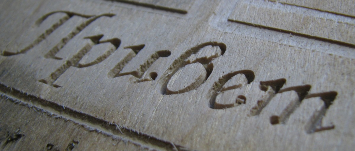

Can you explain what the difference between pressing apply from the engraver tab vs pressing apply from the gcode tab? If I add a cone as you suggest and use the gcode tab, I get the desired result, but if I use the engraver tab, the result in terms of the z depth is different.

Engraving makes a trajectory inside the path. And edges of machined trajectory should fit the original path. Z depth of the trajectory will be different for different parts of the path and it depends on the cutter's shape and path's "width" at that part.
Path-to-gcode converts the path into gcode trajectory. And cut it at the defined depth.
So here's a small illustration:
path to gcode vs engraving.png (7446 просмотров) <a class='original' href='./download/file.php?id=1134&mode=view' target=_blank>Загрузить оригинал (106.89 КБ)</a>
Here's an engraving example:
gcode engraving.JPG (7446 просмотров) <a class='original' href='./download/file.php?id=1135&mode=view' target=_blank>Загрузить оригинал (128.95 КБ)</a>
And Path to Gcode: Notice the letters
path to gcode.JPG (7446 просмотров) <a class='original' href='./download/file.php?id=1136&mode=view' target=_blank>Загрузить оригинал (58.69 КБ)</a>
