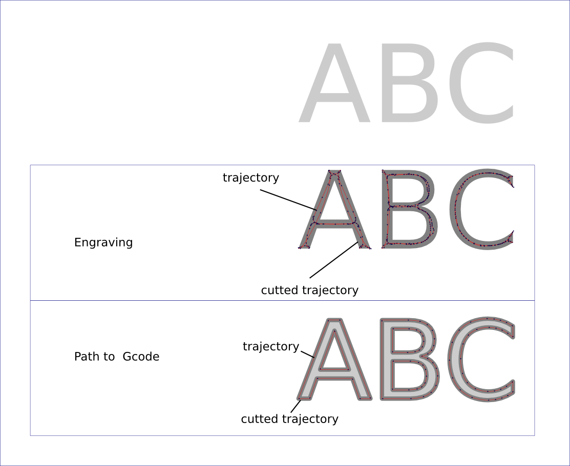

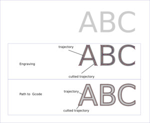

Re: Inkscape Gcodetools plug-in English support forum
Engraving makes a trajectory inside the path. And edges of machined trajectory should fit the original path. Z depth of the trajectory will be different for different parts of the path and it depends on the cutter's shape and path's "width" at that part.
Path-to-gcode converts the path into gcode trajectory. And cut it at the defined depth.
So here's a small illustration:
path to gcode vs engraving.png (7141 просмотр) <a class='original' href='./download/file.php?id=1134&mode=view' target=_blank>Загрузить оригинал (106.89 КБ)</a>
Here's an engraving example:
gcode engraving.JPG (7141 просмотр) <a class='original' href='./download/file.php?id=1135&mode=view' target=_blank>Загрузить оригинал (128.95 КБ)</a>
And Path to Gcode: Notice the letters
path to gcode.JPG (7141 просмотр) <a class='original' href='./download/file.php?id=1136&mode=view' target=_blank>Загрузить оригинал (58.69 КБ)</a>

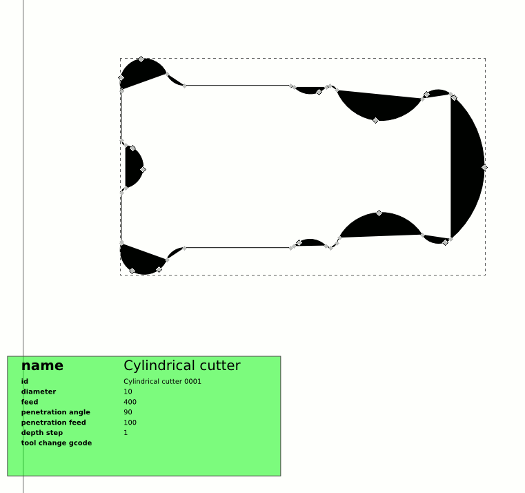

Hi !
I have the path show under this was design from Qcad in dxf...
This give me on inkscape this with just stroke activate...
shape1_without_fill.png (6909 просмотров) <a class='original' href='./download/file.php?id=1184&mode=view' target=_blank>Загрузить оригинал (29.96 КБ)</a>
If setting fill the form become this....
shape1_with_fill.png (6909 просмотров) <a class='original' href='./download/file.php?id=1185&mode=view' target=_blank>Загрузить оригинал (12.44 КБ)</a>
If I do Area with Gcodetools this give me the area of the shape from the fill shape not the stroke....
bad for me....and curious results...
here the svg...
test_area.svg
(13.96 КБ) 954 скачивания
The alone solution i have found...
Is Stroke to path Ctrl+alt+c
Union Ctrl++
Apply Close Curve to have clean curve...
And then Area...
But this give me twice path were I have one ....
And When doing Area this make Inside outside offset path were I require just the In or Out...???
Then i can do path to gcode and then take just the path in or out from path to gcode and then apply
path to gcode to the inside or outside path but very complex...
If you have a better solution....
Thanks ! nice day to you.

Hum I reply me...for give more accurate..
Because it is possible too use the method on the tutorial of this post...with Boolean operation...
But I'd like to stay with the original path to don't have distorsion of it's size...
Because when doing Stroke to path it have the with of the Stroke adding to the size...
