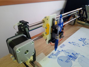

Описание станка, основные характеристики:Плоттер на GRBL
Рабочее поле:374*364
Обрабатываемые материалы:ручкой по бумаге

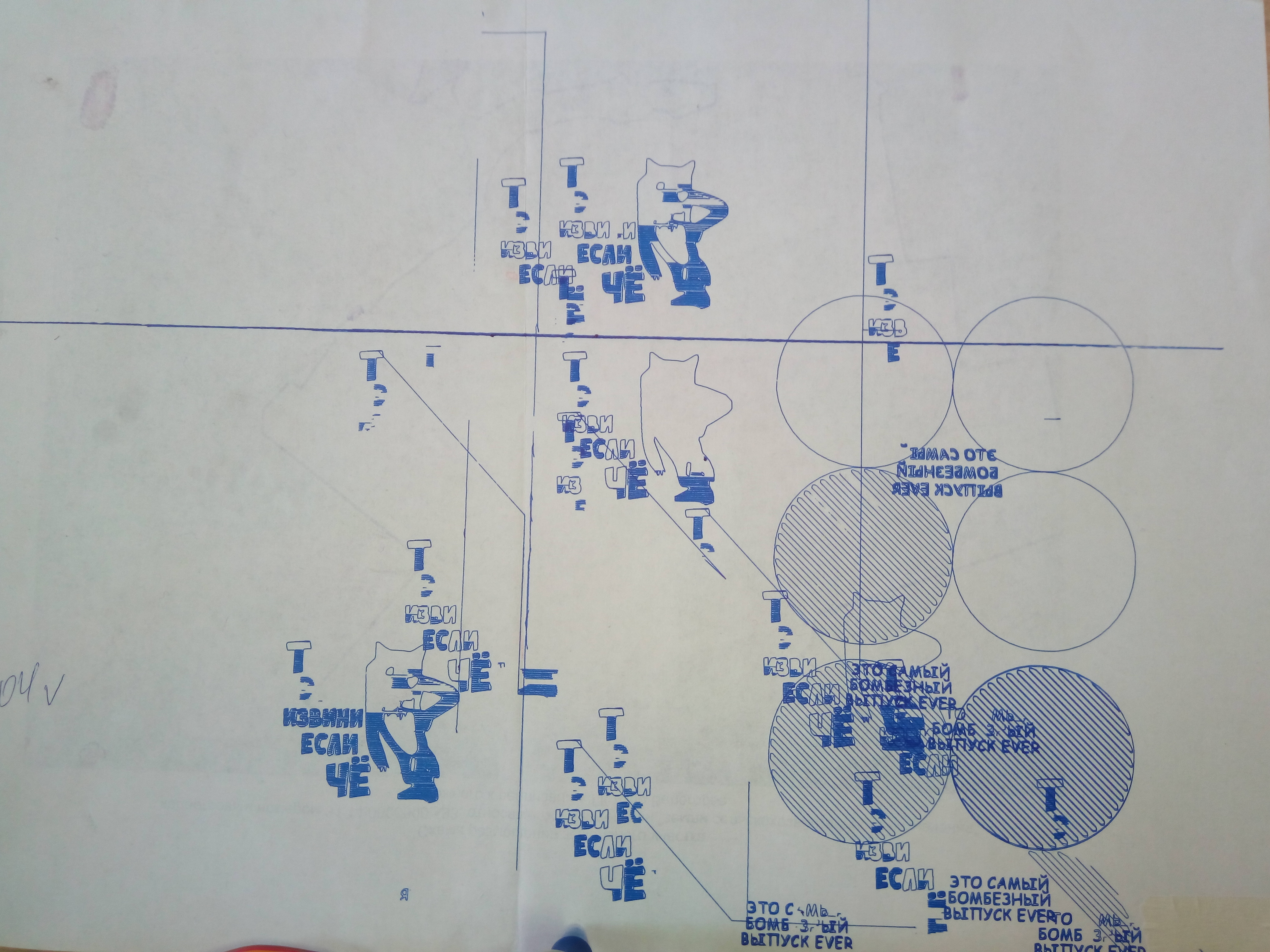

Вопросы: Строил лазерный гравер, но наперед решил перед накоплением средств на лазерный модуль потренироваться с ручкой. И вот плоттер запустил, все двигается, домой работает. Все казалось бы хорошо. Но постоянно возникают ошибки и рисование останавливается:
1)
>>> G1X15.999Y8.5214
>>> G1X16.047Y8.5888
[Error] An error was detected while sending 'G3X15.6715Y8.5772I19.0545J8.4953': error: Expected command letter. Streaming has been paused.
**** The communicator has been paused ****
**** Pausing file transfer. ****
ok
[Error] Error while processing response <ok>: An unexpected command was completed by the controller.
2)
>>> G3X27.8456Y5.5963I0.J0.3314
ok
>>> G1X27.7722Y5.7374
3)
>>> G1X6.0821Y1.6327
[Error] An error was detected while sending 'G1X5.7787Y2.4793': error: Invalid gcode ID:24. Streaming has been paused.
ok
ok
ok
ok
**** Connection closed ****
4)
>>> G1X24.5317Y8.6423
ok
>>> G1X24.774Y8.5012
**** Resuming file transfer. ****
5)$N1=
ok
>>> G1F1500
[Error] An error was detected while sending 'G1X17.0371Y6.0774': error: Expected command letter. Streaming has been paused.
ok
ok
ok
6)
>>> G3X26.7752Y2.9217I0.0001J-2.0211
ok
>>> G3X26.5742Y2.8978I0.2416J-2.8805
[Error] An error was detected while sending 'G3X27.2652Y2.9052I-0.7551J-2.655': error: Invalid gcode ID:24. Streaming has been paused.
[Error] An error was detected while sending 'G3X26.9441Y2.9288I-0.3211J-2.1778': error: Invalid gcode ID:33. Streaming has been paused.
[Error] An error was detected while sending 'G3X26.7752Y2.9217I0.0001J-2.0211': error: Invalid gcode ID:33. Streaming has been paused.
7)
>>> G1X2.3951Y11.398
ok
<Idle,MPos:2.525,11.375,0.000,WPos:2.525
Grbl 0.9i ['$' for help]
An unexpected error was detected: error: Expected command letter
8)
>>> G1X30.8461Y30.9982
>>> G1X30.8132Y30.9775
<Run,MPos:30.225,
An unexpected error was detected: error: Undefined feed rate

Что пробовал: Искал ИД ошибок, ругалось на кривые вроде как, менял разрешения кривых. Менял ускорения от 1000 мм/сек2 до 5, на 5 ужас как все медленно. На кореХУ ускорения стоят 1000 мм/сек2, но там понятно - быстрая кинематика. Снижал дробление шагов до 1/8 и количество шагов 40 на мм (дальше не снижал, ибо и так уже невыносимо орет), ставил ТМС2208. Менял скорости от 5000 мм/мин до 1000, менял паузу по оси Z. Снимал ремни, установил обдув драйверов, посадил на провода до моторов и концов феритовые кольца. Менял кабель и его длинну. Параллелил ШД на одном драйвере, разводил на разные драйверы. Повышал Вреф до 100% (1,04в), а не как по рекомендации 70% (0,73в). Смазывал направляющие и "подшипники" из ПЛА. Менял скорость порта на 115200 и обратно на 57600. Даже спалил один тмс2208 и мегу 2560. :) Угрожал выкинуть нах в окно...
Что плучилось: Получились ошибки под сполером. :) Получаются большие и размеренные фигуры рисовать. Мелкие фигурки с закраской, где много мелких движений типа надписей, почти в 90% ловлю ошибку из под сполера.
Что не получилось: Не получается рисовать с мелкими деталями.

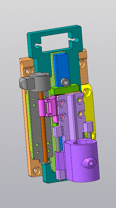

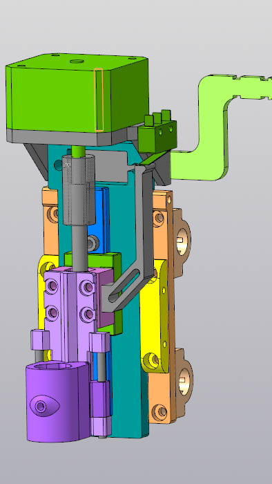

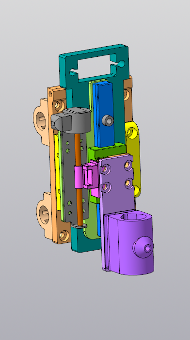

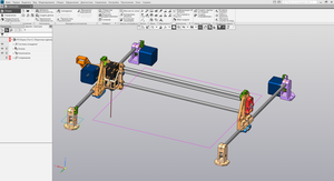

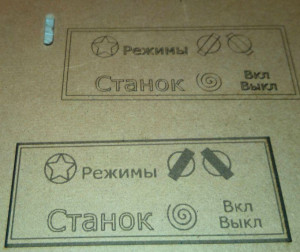

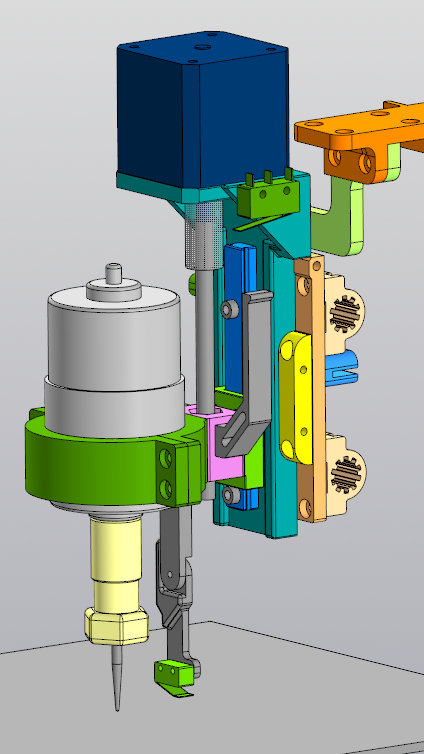

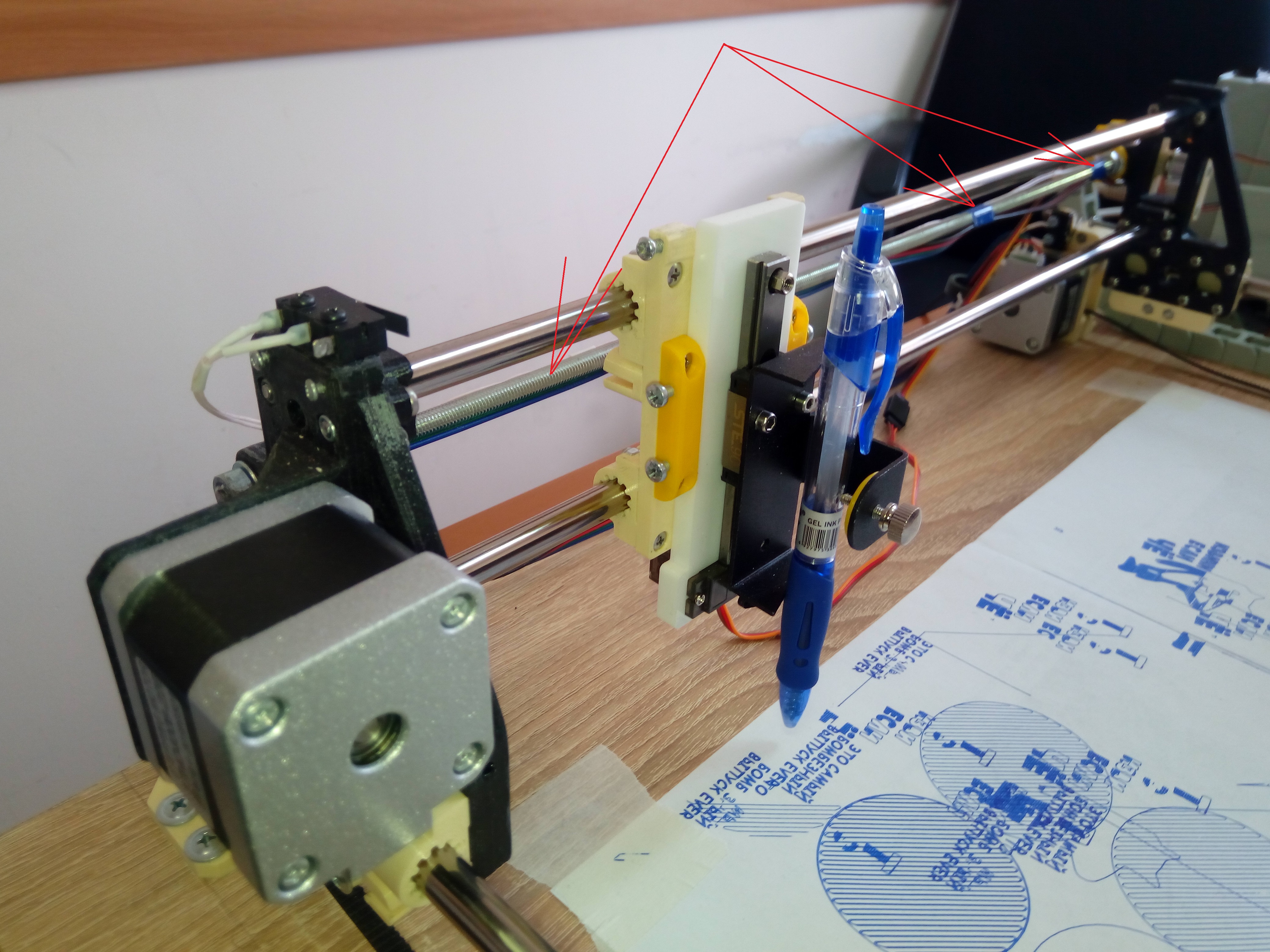

Прошло время, приехала мега 2560, установил репитер прошивку, рисует классно без сбоев и зависаний.

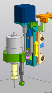

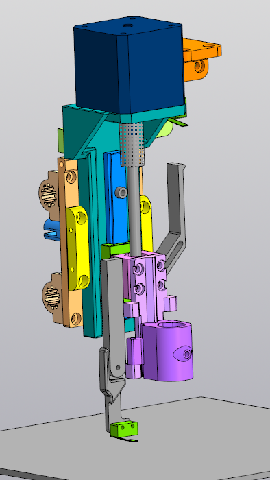

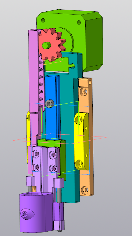

Станочек прошел несколько модернизаций по оси Z, добавил кабель каналы, установил экран 12860. Рисует с флешки. G-code готовлю в инскейпе.
Движок от сидирома, прижать ручку к бумаге еле хватало его усилия, хотел с 2х сторон поставить 2 движка. Но решил ставить сразу нема17. (7129 просмотров) <a class='original' href='./download/file.php?id=183307&mode=view' target=_blank>Загрузить оригинал (100.86 КБ)</a>
Это последнее что работало на грбл, после того как намертво зависло и сбросились настройки, перелез на мегу2560. (7129 просмотров) <a class='original' href='./download/file.php?id=183308&mode=view' target=_blank>Загрузить оригинал (114.93 КБ)</a>
Интересное решение, очень быстро двигает ручкой, потом позже пришла мысль про коромысла, проще, и похоже на серву переросток. )но уже было решено как на последней фотке. (7129 просмотров) <a class='original' href='./download/file.php?id=183309&mode=view' target=_blank>Загрузить оригинал (118.71 КБ)</a>
2020-06-30_10-51-54.png (7129 просмотров) <a class='original' href='./download/file.php?id=183310&mode=view' target=_blank>Загрузить оригинал (104.16 КБ)</a>
2020-06-30_10-52-16.png (7129 просмотров) <a class='original' href='./download/file.php?id=183311&mode=view' target=_blank>Загрузить оригинал (103.92 КБ)</a>
Жесткости естественно нет, но как тренировочный стенд на пенопласте, и понятия надо ли оно мне вообще - склоняюсь, что надо. (7129 просмотров) <a class='original' href='./download/file.php?id=183312&mode=view' target=_blank>Загрузить оригинал (112.09 КБ)</a>

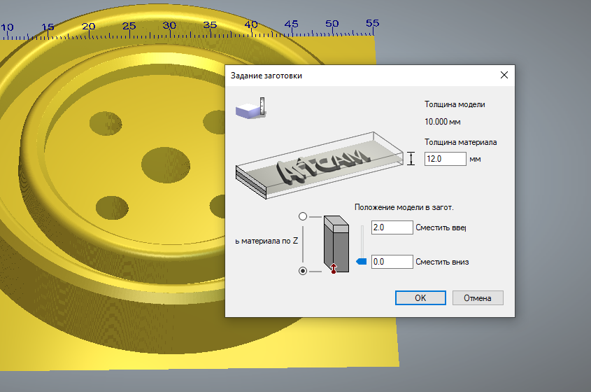

По ходу тренировок возникли вопросы которые я я пока не могу осмыслить. Расскажу как устроенна ось Z. Как видно из последней картинки, на оси присутствуют два концевика.
1 вариант. Верхний Zmax, нижний Zmin. Подключены соответственно. Хомится на Zmax, ноль считает от стола. Нижним Zmin измеряет кривизну стола. Правильно ли это? Нужно ли, можно ли включать перемещения ниже нуля, в отрицательную сторону, и как это сделать на репетире.
2 вариант. Думается, что нужно поменять местами концевики, что бы хомилось вверх на Zmin, там 0. А, выравнивание стола делало бы Zmax. Но, выравнивание стола не работает, просто срабатывает Zmax, и все останавливается.
Так вот, как это все увязать с арткам? В опции Задание заготовки. Сейчас работает хорошо 1 вариант. Верно ли что 0 у стола?
2020-06-30_11-55-48.png (7110 просмотров) <a class='original' href='./download/file.php?id=183314&mode=view' target=_blank>Загрузить оригинал (138.29 КБ)</a>
Представляю это как то так. Но допустим нужно дорезать ниже основания? Как то так)
ЗЫ. А если гравировать какой то рельеф, не деталь, где все размеры известны. Тогда точкой отсчета должна быть поверхность заготовки. Хорошо, эта точка станет в ноль, но ниже нуля не опускается. Как быть?
ЗЫ2. Как работает с пером. 1 вариант. Стол измерян, щуп убран. Ручка-перо опускается примерно на 5мм, получается, рисует в положительных координатах не доходя до нуля, но есть небольшой запас по высоте. Может и с фрезами так же?
Я еще толком ничего не резал, разбираюсь с арткам, и смотрю симуляции. Вот и есть вопросы.
Newengine
Сообщения: 276
Репутация: 25
Настоящее имя: Станислав
Re: Плоттер на GRBL по бумаге 374*364
Сообщение Newengine »
Trostinka писал(а): А если гравировать какой то рельеф, не деталь, где все размеры известны. Тогда точкой отсчета должна быть поверхность заготовки. Хорошо, эта точка станет в ноль, но ниже нуля не опускается. Как быть?
дык всегда все действия происходят ниже ноля. Поверхность заготовки "0", а далее режет всё в "минус".

Newengine писал(а):дык всегда все действия происходят ниже ноля. Поверхность заготовки "0", а далее режет всё в "минус".
Таки да. Я это понимаю. Потому как от станины считать это не то совсем. Не прорезает. Либо ноль или фреза "ниже" станины нуля чутка. но как это на репитере сделать? Может мне совсем не репитер нужен? Но он удобный в конфигурации.
Ну не знаю, я на Марлине решил по другому.
Отключения софт лимитов, или рабочее по Z делать не "0", а -50...к примеру, но есть нюансы.
Можно почитать первый пост моей темы. (она в подписи)
И задавать можно 0 для стола, не только для поверхности заготовки.
Всё зависит от САМ и его параметров.
Но мне тоже проще обнуляться на поверхности заготовки.
За то следующий инструмент не факт что будет об что обнулить...

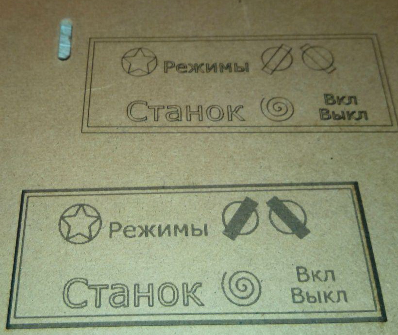

Кажется я разобрался с 0 от заготовки. В репитере есть такая штука как G92 X0 Y0 Z0 или из меню монитора Set to origin, устанавливает в 0 все оси. Допустим Z 20мм высота. Заготовка 3мм. Опускаем фрезу до заготовки, обнуляемся. По факту использовали 17мм, и в пределах -3мм от нуля в отрицательную сторону можно резать. Плюс поиграть с длинной фрезы можно.

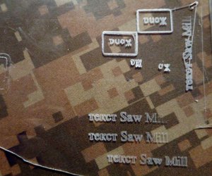

photo_2020-07-01_21-07-28.jpg (7043 просмотра) <a class='original' href='./download/file.php?id=183404&mode=view' target=_blank>Загрузить оригинал (234.93 КБ)</a>
На кусочке крышки от сд диска.
текст Saw Mill в инкскейпе, остальное в арткаме. Нрааавица. :)
ЗЫ. Жесткости не хватает капец. Круги овалы. Надо строить нормальный станок. Этот оставить под баловство с пером и лазером.

Купил лазерный модуль (не на Али, качественный модуль 6Вт). И ни как не могу понять, как делать гравировку с полутонами. Использую мега 2560+рампс прошивка репетир, модуль ттл подключил на 44 пин, там шим 5в. Вкл\выкл научился по М42 Р44, включил управление вентилятором М106/М107. В инкскейпе в J Tech Photonics Laser Tool научился резать/гравировать по контуру+ в AxiDraw можно заполнение сделать. Это работает. В CHPU джарвис+остановка на черном работает. Но какая то межстрочность. А вот в ImageToGcode растровые изображения совсем не получаются, в репитер-хосте я вижу как УП рулит ползунком вентилятора, но модуль не успевает включиться на полную мощность, и не выжигает. Только мерцает. Так же не работают команды М3\М5 хотя в прошивке включил поддержку лазера. ГРБЛ пробовал, но я отказался от него, он глючный(попался такой, постоянно зависает и скидывает в дефолт прошивку), и нужна автономность.
Сообщения: 3776
Из первого сообщения ТС показалось, что провода к винту подачи примотаны изолентой :) . Потом сообразил, что ремня просто на фото не видно, а шпилька для крепления боковин ;)
Trostinka
Сообщения: 15
Зарегистрирован: 13 фев 2020, 13:20
Сообщение Trostinka »
Настроил, от полутоновой отказался, как бы не нужно. Резка и гравировка по векторам в плагинах от инскейпа, гравировка растра в CHPU по черному + джарвис. Все режет и гравирует. М3/M5 работает на 44 пине, переключателем перекидываю на 6 пин для М106/М107, для фокусировки. Питание прямое с БП, с выключателем. Г-код подходит как от марлина, репитера, так и от грбл. Мега 2560, прошивка репетир 1,04. Теперь изучаю режимы резки и гравировки. Классная штука.
photo_2020-09-02_21-44-00.jpg (6151 просмотр) <a class='original' href='./download/file.php?id=185735&mode=view' target=_blank>Загрузить оригинал (162.72 КБ)</a>
