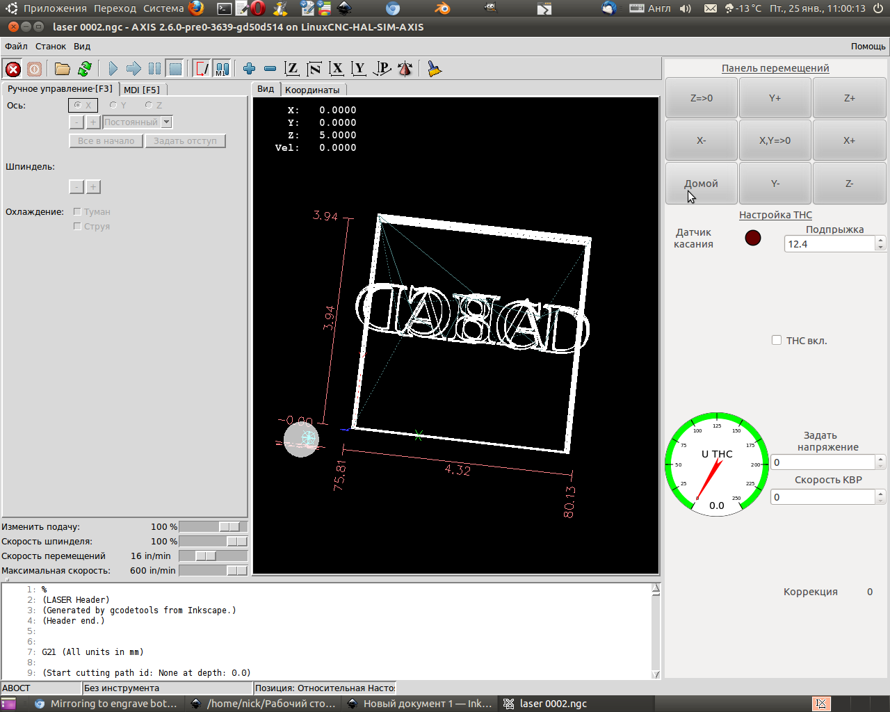

How do you generate your Gcode?
When we developed Gcodetools we involved orientation point to solve this problem. You can fix your material by tree bolts using three drill trough holes.
Then you just create tree points Orientation system and place this points to the centers of the holes in certain order for front and back side. After that Gcode should be properly rotated/mirrored and translated.

Re: Mirroring to engrave both side of material
See the attachments.
You need to create additional layer with orientation points. Then change poitns place, or their coordinates.
Everything else is the same, you can even export to gcode at once for both sides.
(And add another tool definition with Pause and message in Tool's change Gcode).
PS there's standart post-processor to flip Gcode alog one axis..... you can use it as well.
Hi Nick,
I tried to produce a flipped G-code for a very basic path in Gcodetools.
So I made the normal G-code and then with postprocessor "flip(x)".
The resulting G-code is exactly the same for the normal and flipped path. What did I do wrong?
I have just checked flip post-processor - it works fine.
Can you attach your svg?
What version of Gcodetools are you using?
Hi Nick,
I removed completely my Inkscape 0.47 which was installed on 10.04 Ubuntu and installed 0.48 version. I still had strange things.
Then I deleted ./config/inkscape from my home directory and that resolved all my problems. Everything works well.
Thanks a lot for your help!
I got a warning when I create G-code using flip(x) postproc:" Post-processor: Scale factors for X and Y axis are not the same. G02 and G03 codes will be corrupted."
Shall I ignore it, or something wrong with my setup? The code seems OK for me and for LinuxCNC too.
Does the online manual contain all available postprocessor commands? I'd like to try them.

Hmmm ... I do not really know...James628 писал(а):I got a warning when I create G-code using flip(x) postproc:" Post-processor: Scale factors for X and Y axis are not the same. G02 and G03 codes will be corrupted."
Can you try latest -devversion from launchpad?
http://bazaar.launchpad.net/~gcodetools ... lope/files
(do not forget to run python create_inx.py to get new inxs)
Here areall available post processors:
self.functions = {
"remap" : self.remap,
"remapi" : self.remapi ,
"scale" : self.scale,
"move" : self.move,
"flip" : self.flip_axis,
"flip_axis" : self.flip_axis,
"round" : self.round_coordinates,
"parameterize" : self.parameterize,
"regex" : self.re_sub_on_gcode_lines,
"remove_a_turns" : self.remove_a_turns,
Most remarkable - regex - most powerful one - applyes defined regex to every string of gcode. Others are not so interesting
And anyway I suggest to use another layer with another copy of Orientation points - thus it will be easier to put back side in it's exact place.
