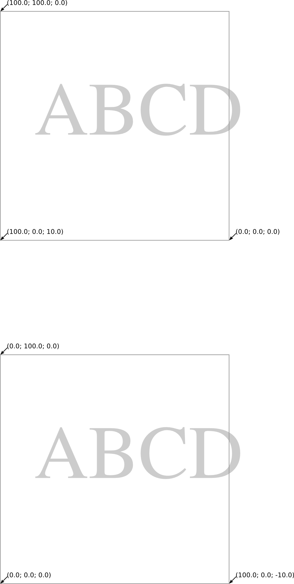

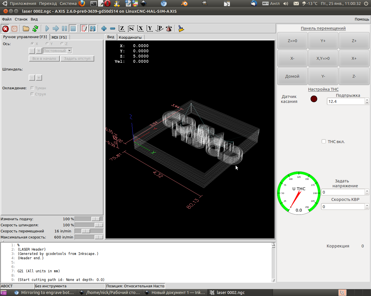

See the attachments.
You need to create additional layer with orientation points. Then change poitns place, or their coordinates.
Everything else is the same, you can even export to gcode at once for both sides.
(And add another tool definition with Pause and message in Tool's change Gcode).
PS there's standart post-processor to flip Gcode alog one axis..... you can use it as well.

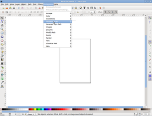

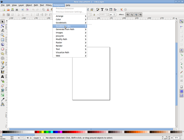

Here goes the screenshot:
Inkscape Gcodetools-dev menu (22376 просмотров) <a class='original' href='./download/file.php?id=11374&mode=view' target=_blank>Загрузить оригинал (89.72 КБ)</a>

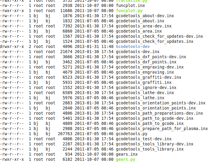

I listed the content of the extension directory (ls -al). Here is part of it:
gc1.png (22365 просмотров) <a class='original' href='./download/file.php?id=11393&mode=view' target=_blank>Загрузить оригинал (133.1 КБ)</a>
