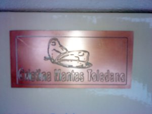

Could you explain a little the relation between the diameter tool and the z depth in orientation point?
I said that because I want to engrave a text and a simple drawing . I have a Z depth=- 0,1mm in orientation points and a Cone cutter diameter= 0,3 mm. I go to engrave and the G code have different z depths from - 0.3 mm I set the Diameter tool = 0,1 mm and the new G code have the Z depth I want = 0,1 mm
Regards.

Hello nick,
I want to engrave a PCB with single flute bit 60ª. http://www.cnc-plus.de/product_info.php ... -bits.html
It is a little gift .
Then It is better paths to g code? . I enclose the svg engrave file
I tried paths to G code the file is smaller than the Gcode engrave file. Paths to Gcode is faster than engrave.
Regards

Yes it's better to use path to g code for this path. You can not engrave such path with 0.3mm bit. Because the path is thicker than 1.5mm.
Engraving should cut internal of the path (if it's able to cut it with the bit), and path to gcode cuts path's outline.

I did paths to code . The final work it is not very good because my machine have many backslash I will put a picture.
Regards.

All the way is not exactly a problem of backslash. I have made the machine with a scanner for the y axis ,whit some woods parts ( rest of my kitchen furniture)
I do some base to put a full printer carriage support ( with the rod , belt ...) for the X axis
. Finally I ad a new printer carriage support in Y carriage for Z axis.
Then I have backslash and accuracy problems in Z axis ( the belt moves by the weight and vibrations ) and the support of the Y and Z axis bend by the engraving force.
I supposed that but I do for learn a little of electronic , programs ect....... and I am the happiest man in the world when look the axis movement.
Regards.

According to the photo it seems that your machine lacks hardness. Probably if you set less depth per pass you can get better results. Letters look nasty

In reference to the letters I tried with 0,1 mm depth but the problems is that the z axis when go down and up with the vibrations lost the position. I did another work with a cylindrical used mill 0.8 mm. The letters are a little bit better but the mill engrave without depth.
What can I do in the letters to achieve a bigger inside ?
