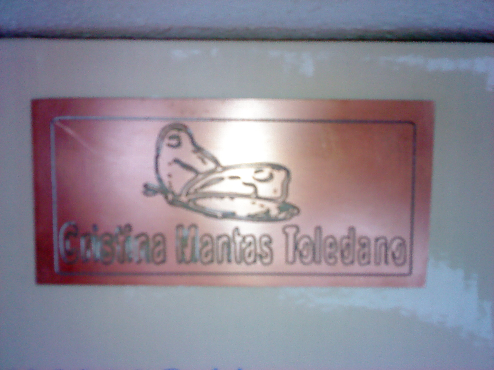

I did paths to code . The final work it is not very good because my machine have many backslash I will put a picture.
Regards.

Hier is the picture.
Regards.
Placa Cristina Picture (22959 просмотров) <a class='original' href='./download/file.php?id=1467&mode=view' target=_blank>Загрузить оригинал (565.17 КБ)</a>
Re: tool error
In the ini file you can define backlash for each axis.
In the sections [AXIS_x] set BACKLASH = value.
And even more in EMC2 you can set different backlash for different positions of the current axis using backlash compensation file...
According to the photo it seems that your machine lacks hardness. Probably if you set less depth per pass you can get better results. Letters look nasty :(.
