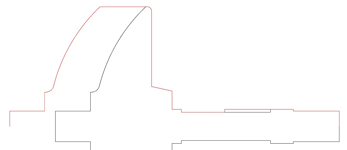

Gcodetools engraving by Rene (1423726 просмотров) <a class='original' href='./download/file.php?id=631&mode=view' target=_blank>Загрузить оригинал (233.84 КБ)</a>

  • Compute trajectories for lathe
  • Fine cut
  • Define fine cut's depth
  • Define fine rounds
  • Two different computation functions for fine cut
  • Standard axis remapping

By the way in the development version there's a new function: modify path, to prepare the path for cutting with straight rectangular cutter:
Red path is the trajectory, black one is needed cut.
45261traekt.jpg (7715 просмотров) <a class='original' href='./download/file.php?id=1076&mode=view' target=_blank>Загрузить оригинал (24.15 КБ)</a>
