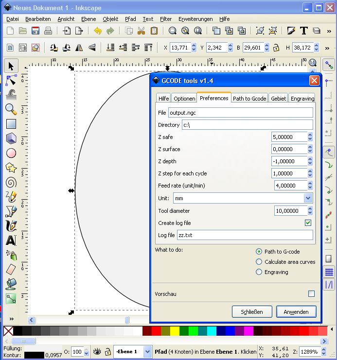

Inkscape Gcodetools in windows has no output
Сообщение bolo »
Hi folks! I'm trying to use g-code tools v1.4 in Windows, with Inkscape 0.48.0 r9654, but it seems that nothing happenes, unfortunately! :think: I tried c: with and without backslash, and "C:\Dokumente und Einstellungen\bo\" (my home dir), with activated logfile as you can see in the picture, but no file appeared there. Also on the screen nothing happened, no matter what values i set for tool diameter and area radius. I also tried version Gcodetools 1.6.04, where the 'what to do' section is missing, and it also didn't seem to work.
Has someone the same problem, or any idea?

Edit OHUH think i found out, it must be a general problem because none of my extensions work! I was just reading http://wiki.inkscape.org/wiki/index.php ... onsWorking but maybe I'll install all again.

Re: Inkscape Gcodetools plug-in English support forum
You better use v1.6. we've split all the functions to different extensions/tabs (tab is a "page" in the extension's window).
So for example if you want co export path to Gcode you should open Path to Gcode extension from Gcodetools, fill in filename and dir, chose the Path to Gcode tab and press Apply.
Now "what to do" equals to active tab. So if you want area function - select Area tab, if you want Gcode select Path to Gcode tab.
If extensions do not work at all, try looking here http://wiki.inkscape.org/wiki/index.php ... ft_Windows . Gcodetools is a ordinal python script so all you need to make it work is to have an Inkscape and Python. So check if Python have been installed. (It should have been installed when you've installed Inkscape but may be something went wrong ;) )
PS if something goes wrong Gcodetools usually raises an error so you should know what exactly goes wrong.
